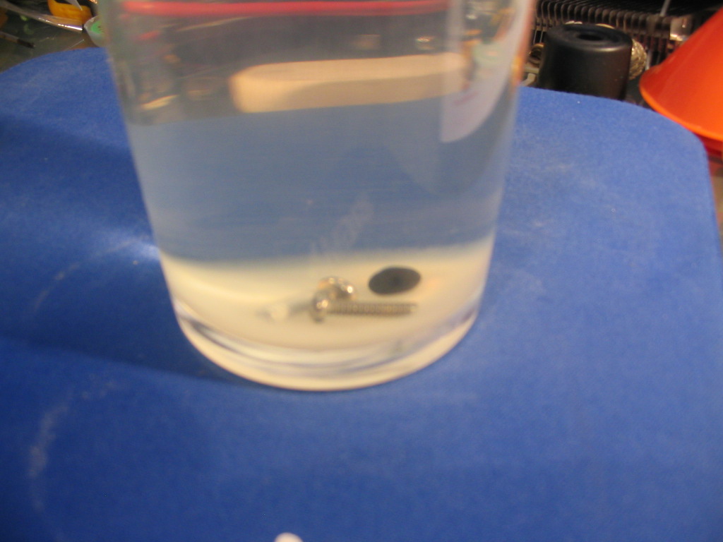

As a test, I put some old glycol from the LC chambers in a glass with some new stuff and put in some screws (the same ones used to seal the glycol hole) and within a couple of weeks, guess what, the bottom of the glass is now covered in fungus stuff - check the photo below, all that white stuff in the bottom of the glass just appeared all by itself. Not sure what caused it but I'm glad I cleaned out the LC chambers.

 Filesize:  144.88 KB
 Viewed:  6895 Time(s)
Paul

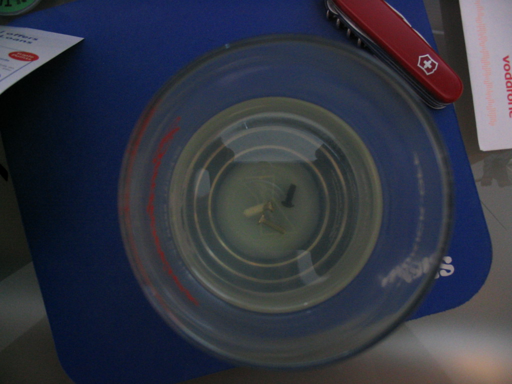

Also this photo. In the glass is a stock screw, a stainless steel one and a stainless steel screw covered in Locktite. I did this to try to establish if the screws are causing the fungus in the LC chambers or if it was something else.
From my rather simplistic test, I'd say its the old glycol rather than the screws as such. Which would certainly indicate total cleaning of the LC chambers would be best. Note, the stock iron screws will cause other issues in the chamber and are best replaced with stainless steel ones - basically, the iron ones will essentially rust and stain the tube faces.
 Filesize:  179.75 KB
 Viewed:  6894 Time(s)
Paul
