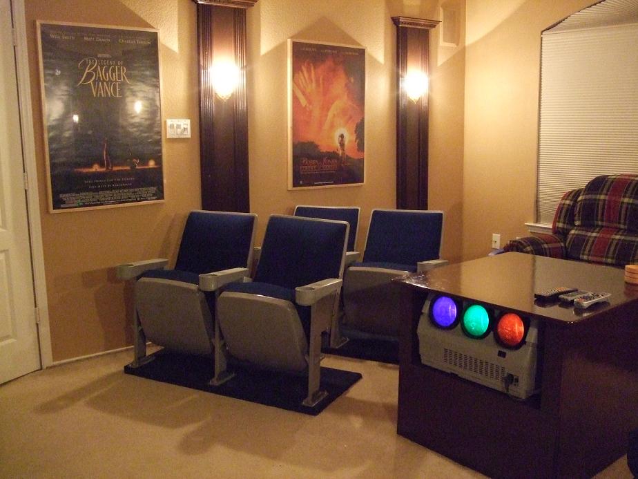

Posted: Wed May 14, 2008 2:55 pm    Post subject:
With regards to the floor mount, why does it suck?
I have gone with a floor mount and have no issues. In some cases in can actually work out well with having a table to set your remotes, drinks, snacks, etc on. A good amount of the people on the forum are purist and the slightest imperfection will bother them greatly (Dave Very Happy ). Here is pic of the table I had built. I will eventually have a 1209 going and will have to build a different cabinet to house it. I am going to try to go with a lower profile to make up for the added length that the 1209 will require.
Dan
