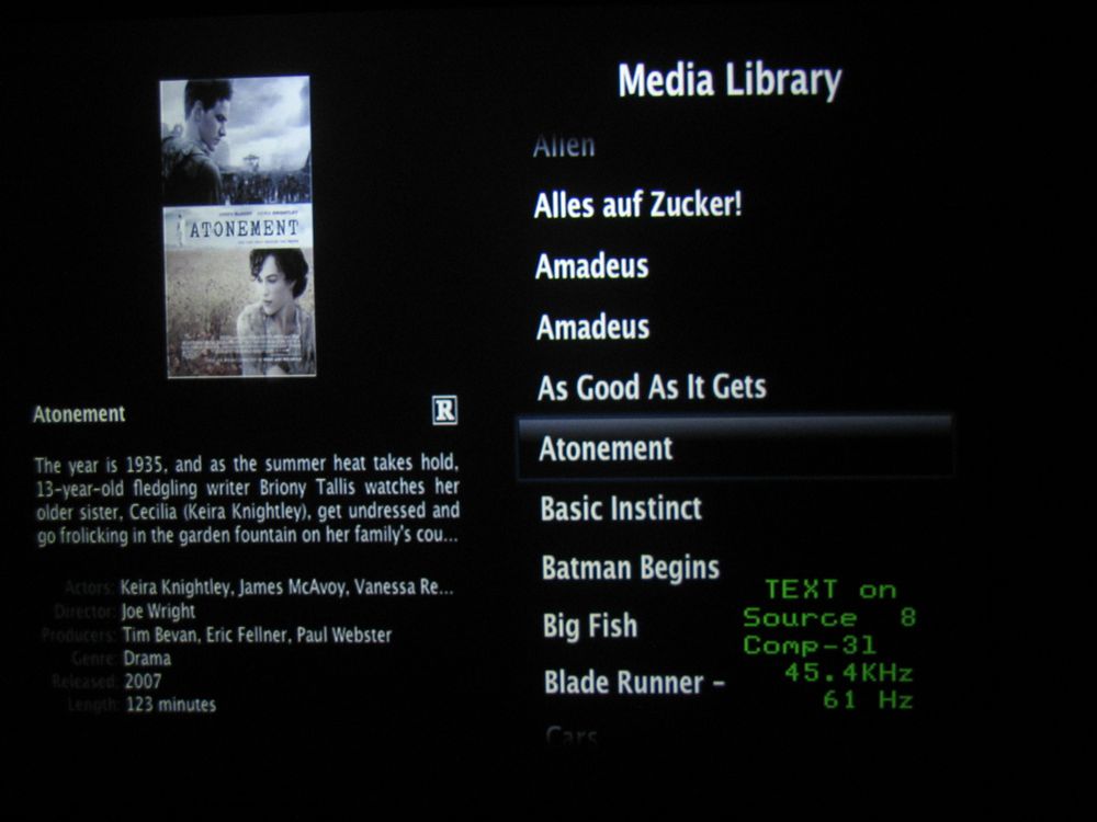

Yep, what r.bauer said. You have the board. But, the RTC2200 does component MUCH better than the board in your PJ.

I quickly plugged in the component into the pj. and took a quick snapshot. This is what the input text said (please excuse the terrible picture quality Embarassed Never actually configured the input yet, so this is no convergence, aspect, etc.)
Wolfgang
