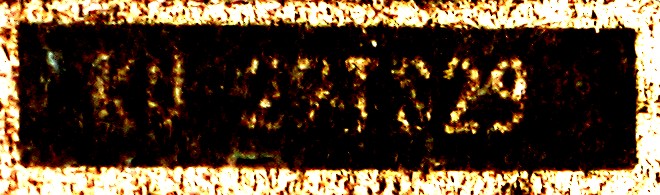

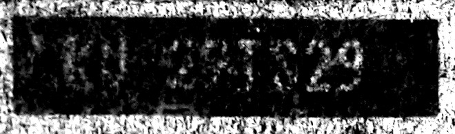

Posted: Sat May 10, 2008 9:39 pm    Post subject:
It's hard to say. Maybe you can decipher it.
Possibly KM 29T829??

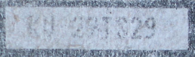

Posted: Sat May 10, 2008 9:45 pm    Post subject:
One more. Maybe KV 27TS29?

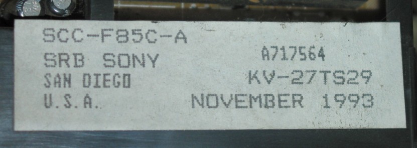

That would be a KV27TS29. If I remember that chassis correctly it was a common problem of shorted regulator transistors in the power supply. Something like 601 and 602 I think. There was a kit that also had replacement VR's. Sometimes it would take out the horz output xsistor also. I think I have the manual for that but let me check.

Posted: Sat May 10, 2008 11:09 pm    Post subject:
LOL yeah. Here's the best part when I walked around to the botom of the set, (it's face down on a pillow and blanket )
DOH!

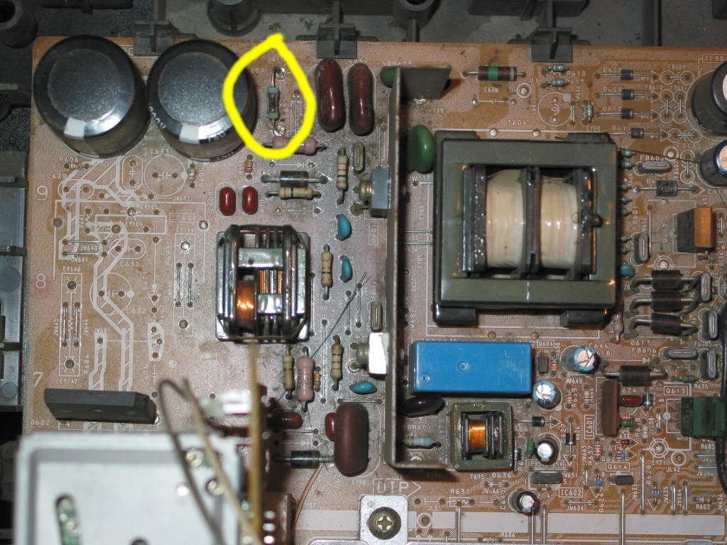

It's made in San Diego, CA. The fuse is labeled F601. It's fine.
However there's a blown resistor at R607 and both Q601 and Q602 test as shorted.
I found this post from the forum that secstate gave me.
Here's a picture of the blown resistor:
Blown resistor
 Filesize:  205.58 KB
 Viewed:  16203 Time(s)
Posted: Sun May 11, 2008 1:33 am    Post subject:
That is the common Sony problem but there are some key info missing there. Those look like the parts that need to be replaced but you also have to check the horiz. output transistor. If the xsistor is good you need to check the solder joints on that xsistor, the horiz drive transformer. Hopefully there will be bad joints. Other wise you may have a bad flyback which you wont know until you replace all the parts and it blows everything out again. Check the horiz xsistor for shorts, check as many solder joints as you can but especially those I suggested, replace the parts on that list and keep you fingers crossed. Then hope you dont have the common Sony weak tube issue............
