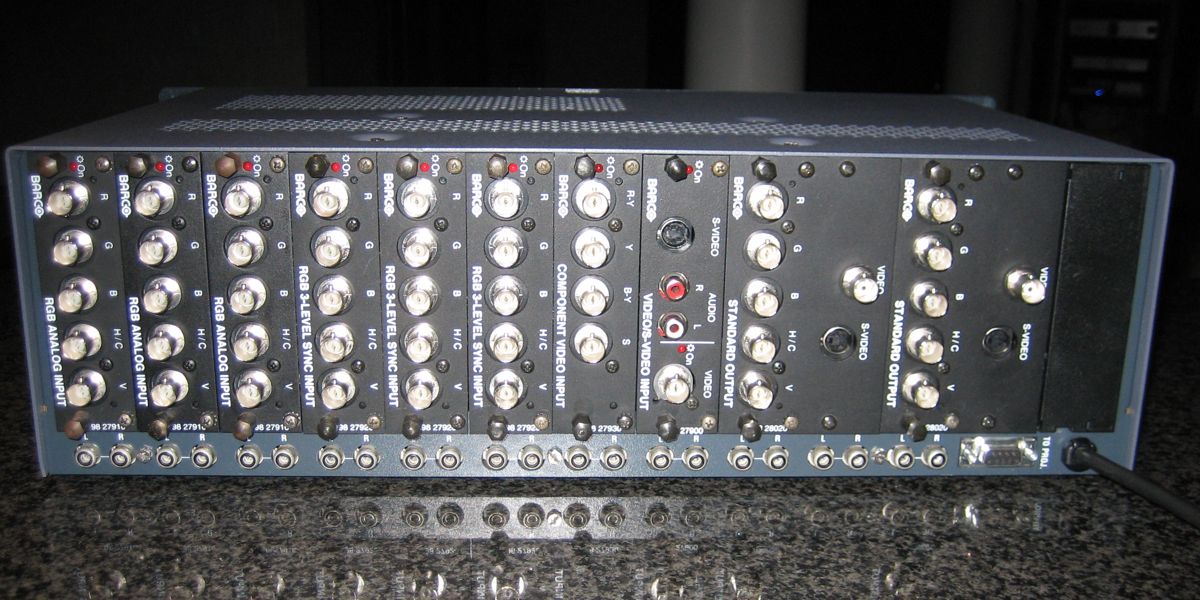

Btw. here is an image..
 Filesize:  149.49 KB
 Viewed:  7862 Time(s)
Posted: Thu May 22, 2008 6:37 am    Post subject:
Nice! I love the way a switcher look's all filled out. Thumbs Up
