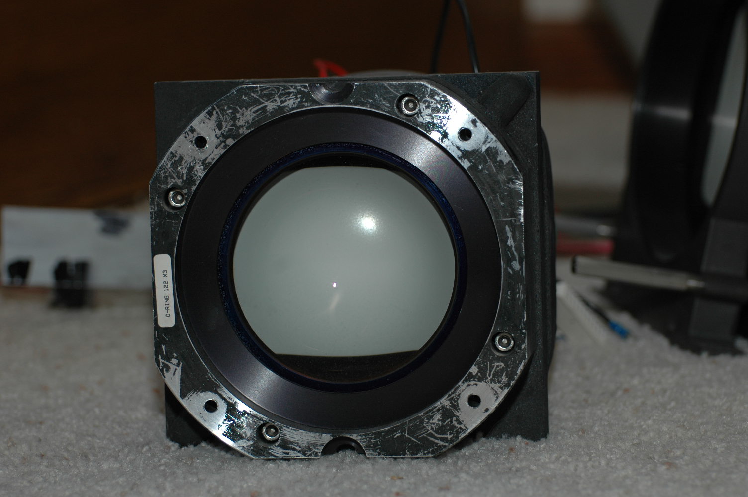

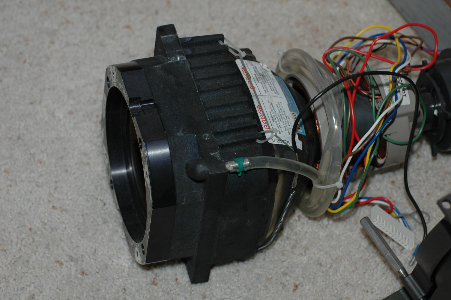

Yes that is what I'm doing. These P16's are from a retrodata 808. I'm swapping everything from the necks and putting them in my 1208 due to the neck board connections were different. When I first tried uploading pics (never done here before) I found out size really does matter! Thanks
 Filesize:  206.81 KB
 Viewed:  3894 Time(s)
 Filesize:  180.44 KB
 Viewed:  3952 Time(s)

Stereodave70 has posted about his 1208lc on this forum and a few ( very few) reports of them in Europe indicate they were a limited run. It would be nice to see a few pics of the housings,and how they differ from the retro unit.
