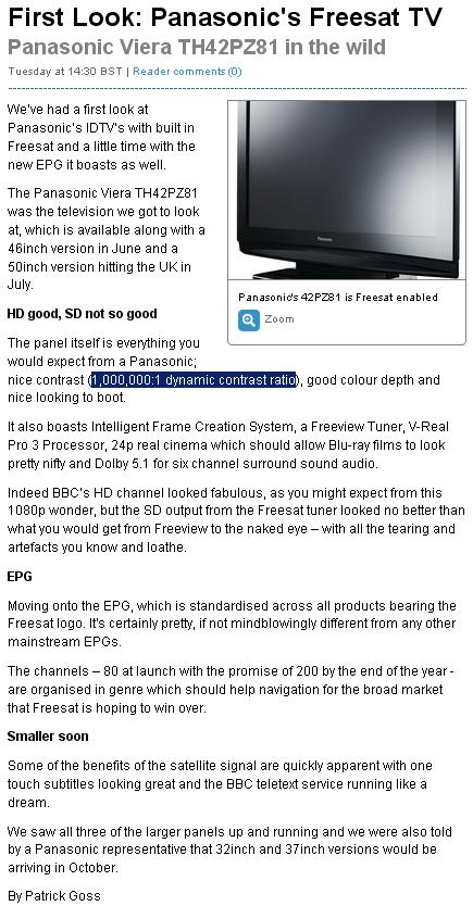

1 Million to 1 Dynamic CR on a Plasma?
Posted: Thu May 08, 2008 11:20 am    Post subject: 1 Million to 1 Dynamic CR on a Plasma?
http://www.techradar.com/news/television/first-look-panasonics-freesat-tv-358525
 Filesize:  97.62 KB
 Viewed:  364 Time(s)
Posted: Thu May 08, 2008 11:22 am    Post subject:
I think the need to pass a law requiring 3rd party evaluations in order to make such claims should be instilled. Unfortunately, that requires the majority of consumers to see value in such a law. But, when the majority of consumers are just cows buying Bose and Monster Cables it will continue to afford environments for virii like this to sustain their marketing existence in.
Curious, what measuring instrument available to consumers can measure that kind of CR ratio?

...and 96khz audio... Wink
Anyway, for contrast levels like that you need either insane brightness or incredible black level. Even if the off pixels were really full black I think you'd have a hard time achieving that just from the reflected light from the room! I'm guessing this is just a theoretical calculation, if it's not just pulled out of somebody's ass. Why's it 1,000,000 to 1, and not 1,240,000 or 960,000? Right. It just happens to be a round number...

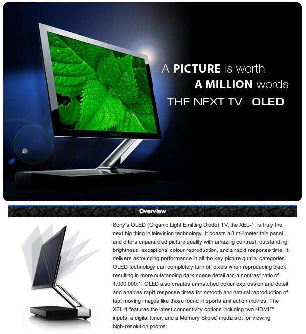

Sony is also touting 1,000,000:1 CR on their new OLED displays...

Well, I do not do research on other themed sites so I have no idea how something like this can achieve 1,000,000:1 contrast. Are they able to control individual pixel backlighting?
Posted: Sat May 17, 2008 2:32 pm    Post subject:
Oled is light emitting, not transmitting, so they can turn pixels totally off. Plasma requires the elements to be precharged so they're always on just a little - older ones like mine have 5 percent gray blacks compared to the black level of the powered off screen surface itself.
