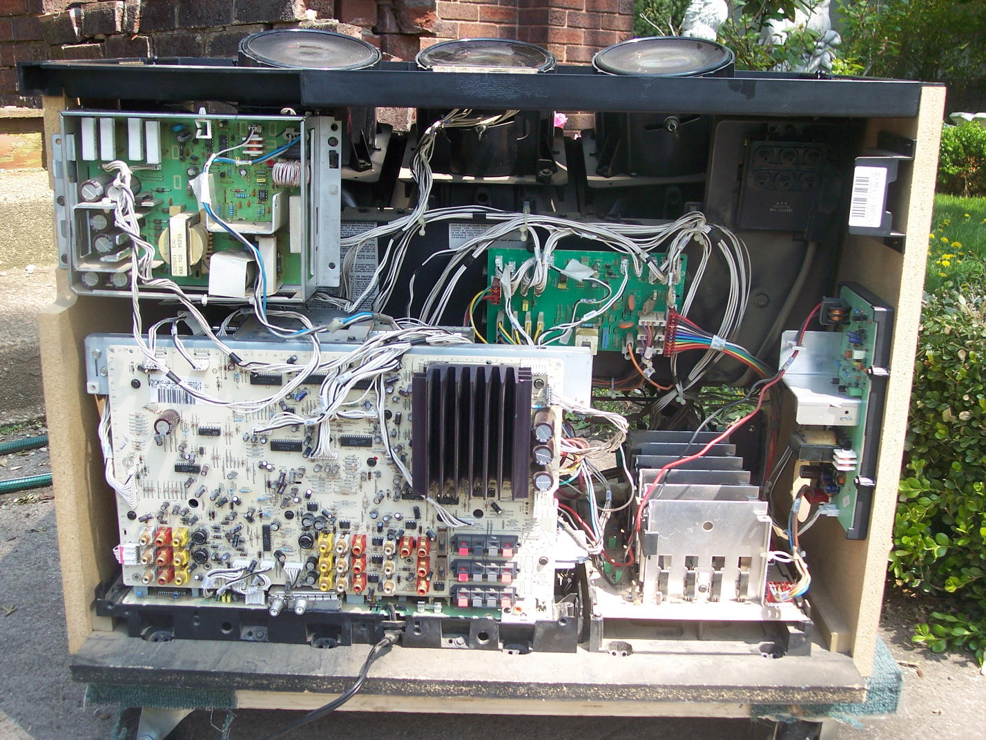

It's a RCA MODEL PS80690. The entire light box is removable and can be carried by two menand an ox. Total unit is about 6' x 6' x 4' . Light box shows 9" crts with Delta 120's on top. RCA is no more. Thompson sold the name to a Chinese company and does not ship products to the states or support their older product. Attached is a pic of the monster.

It's a RCA / Proscan MODEL PS80690. CTC188AE chassis. The unit tries to turn on and immediately shuts down on protection. P" CRT's with Delta 109's.

I know they checked out the power supply as these had cap problems. Checked out the solder joints on the RF tuner coax to the mother board (supposedly caused floating ground problems which whipped out IC's) and I believe the first technician replaced the flyback.

Not finding my manual on that chassis. Everything else but. Anyways, the 188 chassis had a problem with the power supply and the splitter. Eeprom's too, but it probably wouldn't turn on at, just dead set. Try disconnecting the high voltage wire from the flyback and see if it powers up. You sure it was the fly that was changed and not the splitter. Splitter is called the HV block in those units.
