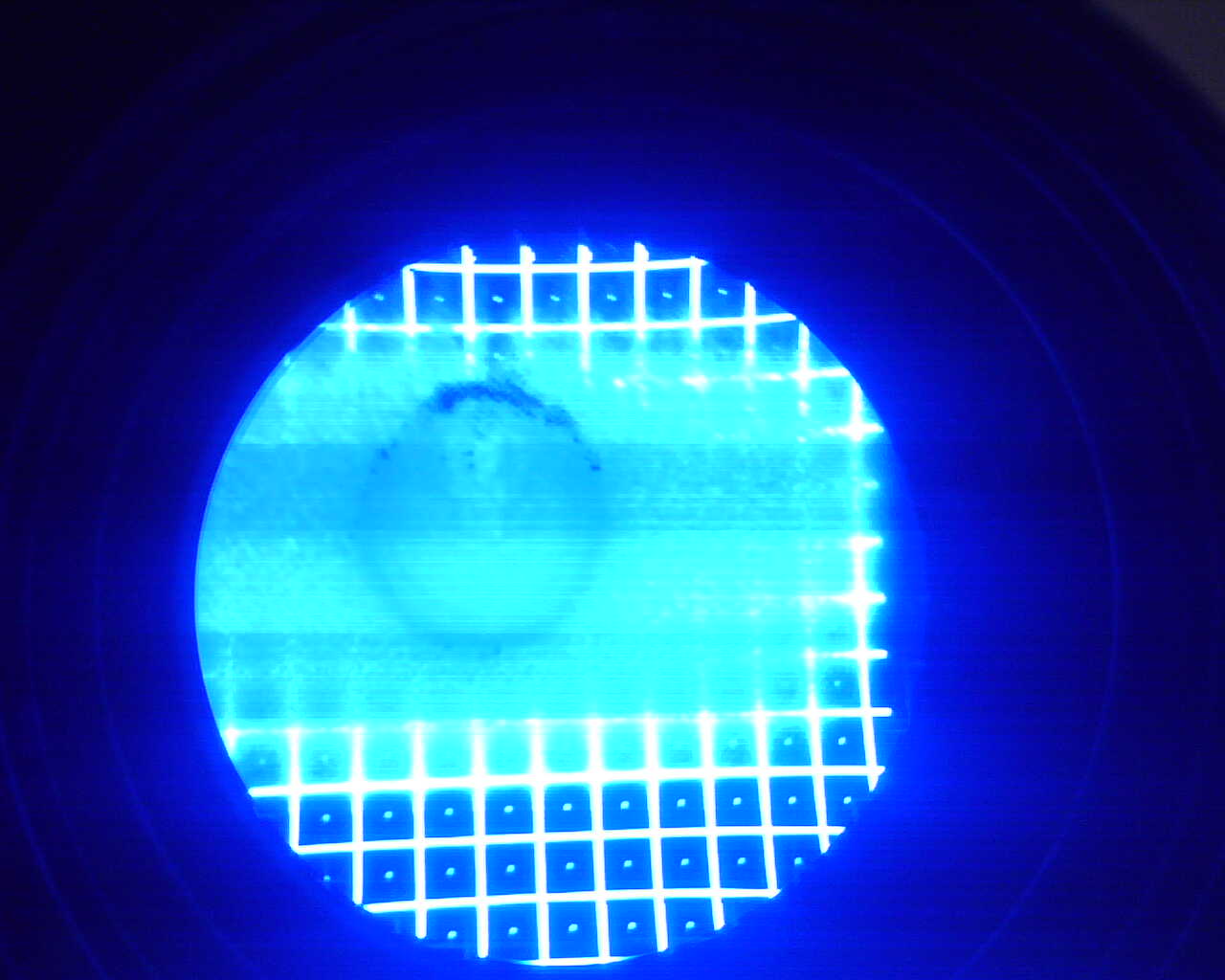

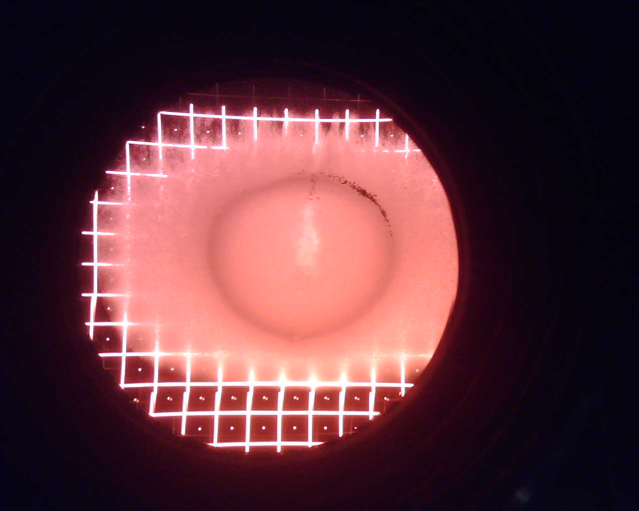

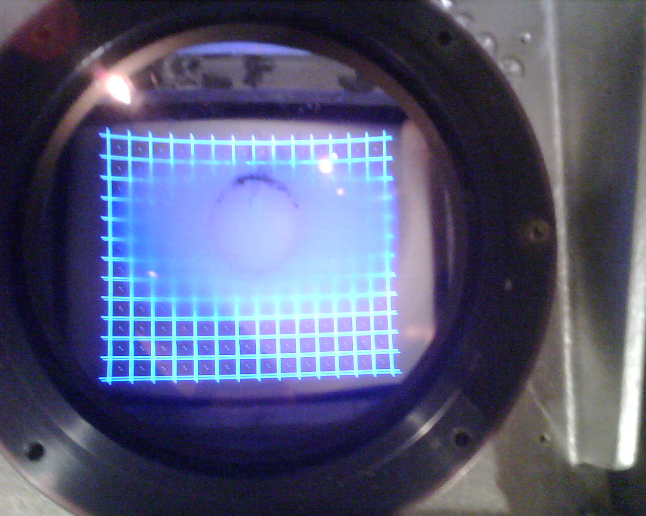

Well to update this thread:
Curt checked out the boards and they had no issues including the moome. (other than a low battery on the clm)
Best guess is that the blue and red guns have SEVERE fungus. Cell phone pictures attached(sorry for the quality):
