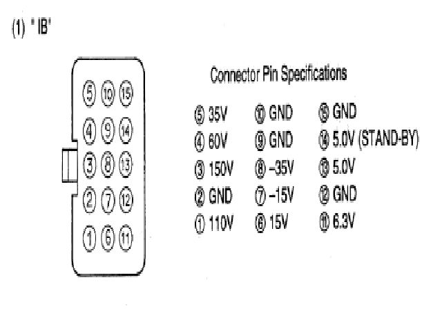

i was wondering that ,in standby mode, is there +15V output or not?
and whice line is 15V? no diagram,no idea!!

Ok, if you want to try to verify if its the PS or not heres what yo can do.
Here is the connector from the PS:
Verify all voltages.
 Filesize:  32.81 KB
 Viewed:  3683 Time(s)
luofan525
Joined: 21 Apr 2008
Posts: 4
Posted: Tue Apr 22, 2008 3:57 am    Post subject:
you are really very good good goood good .... man !!!thanks
seems that only 5V was outputed when standby
