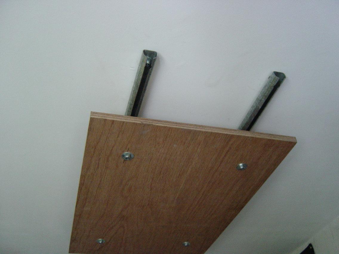

I'm looking for input from guys that have mounted a barco to the ceiling with something other than a factory type mount. The pj has a big plate that covers the whole bottom with two L shaped rails front and rear, Has anyone used unistrut or some other easily located material? I have some ideas but would like to hear some others.

Did it like the picture

I was thinking about something similar to that but I want to be able to mount the rear of the pj lower to get the projection angle closer to zero.

The easiest is similar to the posted wood pic. If you need a drop, just bolt a 1.5" pipe fitting, or a peerless 8x8 ceiling mount to the wood.
Anther option is to bolt two pieces of unistrut on top of the "legs" parrellel with the legs. The put two pieces of unistrut on those running the length of the PJ. Then, attache one of those Peerless 8x8 ceiling plates to those two pieces of unistrut.

I already have a unistrut mount holding the 1272 up in the rafters that has four threaded rods to mount to. I think bolting some 1/4" thick aluminum angle along the length of the rails and using a clevis to attach each rod to the angle wil allow me to have the flexibilty in adjustment that I want to get. I think I need to have the rear of the projector down at a 14 degree angle to get the lenses near parallel with the screen. Anyone got suggestions?
