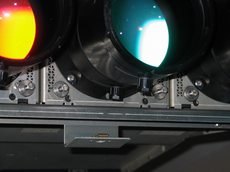

i had the same problem. To cut and reglue the bellow sounds very questionable to me. My solution: leave the bellow in place, turn the whole housing und replace the scheimplug mechanism. Some metal work is required but it will be a dream of a scheimpflug adjustment afterwards. Very nice to adjust (11 turns instead of one) and therefore practically no interaction between the two screws.
Bernd
