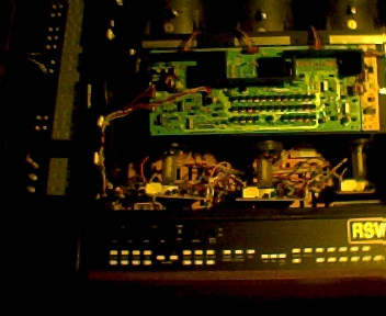

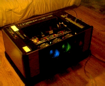

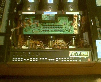

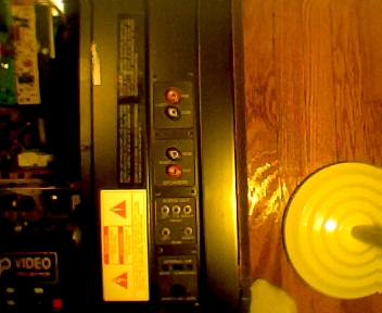

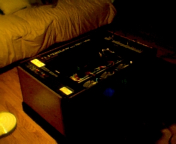

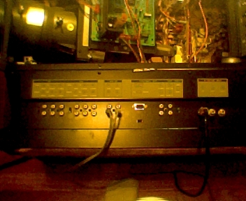

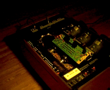

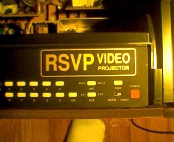

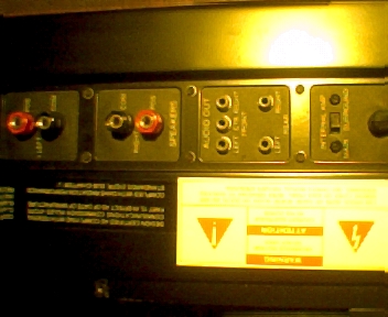

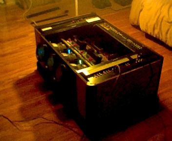

Posted: Sat Apr 12, 2008 7:03 am    Post subject: SOME PICS MAYBE?
going to try and post some pics.....
not sure how to do this but here goes..............

Posted: Sat Apr 12, 2008 7:11 am    Post subject:
Arrrrrr I get's ya matty.
That thing looks SOLID! I love old stuff that's built to last.

DARNOLD wrote:
i can't find anything like "setup", "program", "reset", etc. with which to run alignment, pin, keystone, convergence, etc.
any ideas?
Well, the PJ is of 1988 vintage, so I assume it has analog convergence controls only (i.e. lots of tiny pots somewhere under the cover - probably the green board in pictured 2, 3 and 10).

Dave Lister
Joined: 16 Jan 2007
Posts: 436
Posted: Sat Apr 12, 2008 1:05 pm    Post subject:
The trim pots on that green board would be the convergence controls, set them to their mid point before starting to converge it.
Why bother blackening the underside of a piece of perspex?
Leave it clear so you can see the insides, it would make it more of a conversation piece and with the perspex overhanging the edge it would make it a good coffee table projector.
It would have a spot in the coffee table book about coffee table projectors then. Very Happy

Posted: Sat Apr 12, 2008 1:55 pm    Post subject:
Hah, I'm going to completely contradict ecrabb's post.
This thing was a HUGE P.O.S.!
JBL first came out with this set, and it was called a 6810, later a 6850. It was not made by Harman/JBL, it was actually made by Philips. There were about 3 of these installed locally, in bars. One bar spent stupid amounts of money ($8K?) on it. Like other sets of the day, they weren't very bright and the tubes lasted a long time.
The cons:
The biggest problem in this set was the design of the double sided PC boards. The feedthrough points of the boards, where the conductors went from the top of the board to the bottom was always going intermittent. There were literally 100s of feedthrough points, and you had to resolder the joints top and bottom to make them work.
THe convergence controls were better than the Zeniths that I was selling at the time, but there was always one corner that was out, as the controls were still limited.
If it's running, then great, I would NOT reset the convergence controls to the midpoint, hopefully the set is set close enough now to be useable, then get to learn what the controls do and go from there. You'll need an external crosshatch pattern, from what I remember these sets only had a crosshair.
I haven't seen this version of the set before, but your pix clarified what it was.

i found the crosshair pattern and its converged pretty well except at the very top where the colors just start to pan out a little
