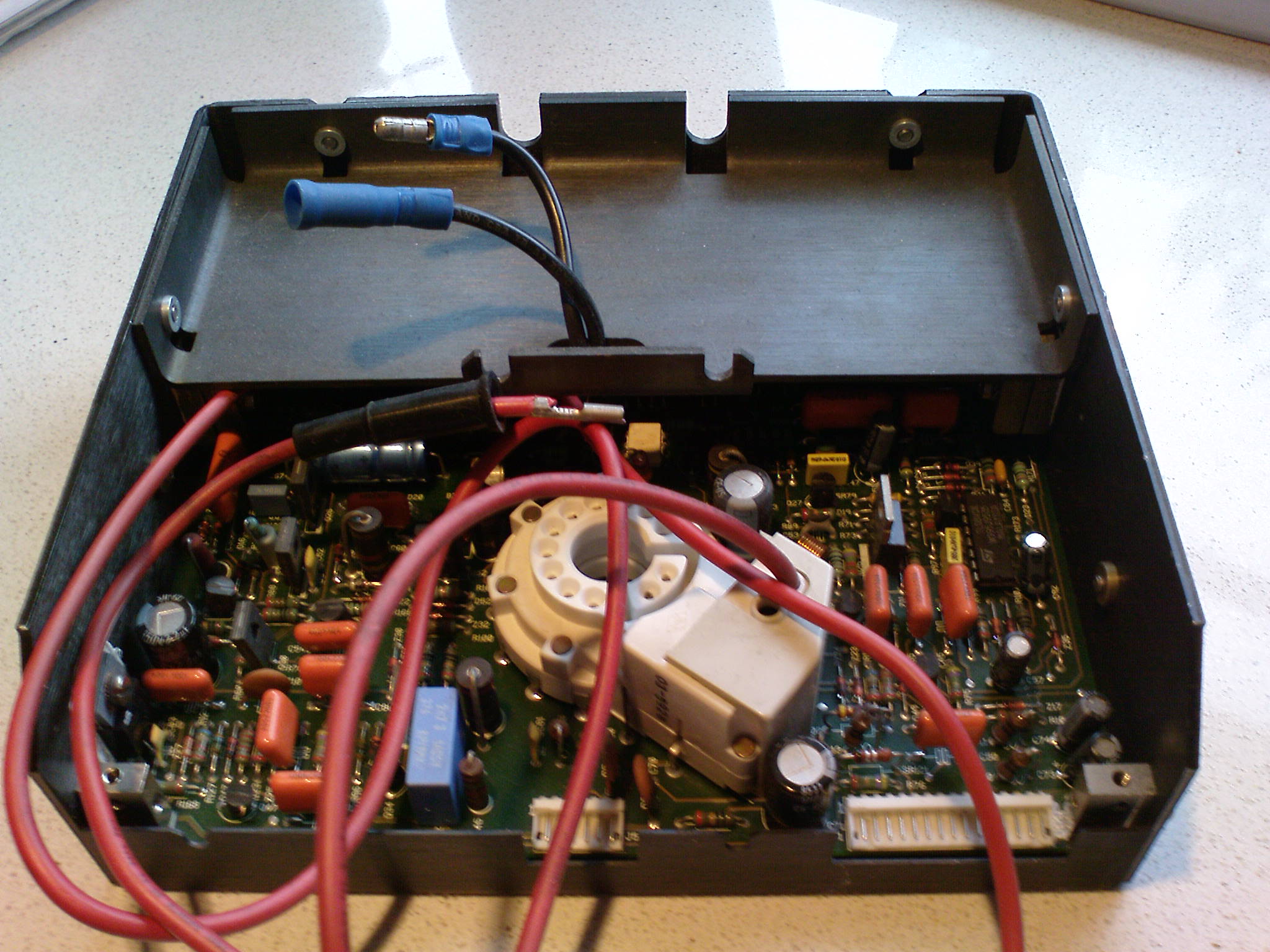

Necboard numbers;
R7621191
(1080207)

Necboard
 Filename:  DSC00066.JPG
 Filesize:  369.98 KB
 Downloaded:  322 Time(s)
Posted: Sat Apr 12, 2008 1:42 pm    Post subject:
OK, that's the Sony tube. If it is the tube, why not throw another one into the set? Or for that matter, if you can't see the lines in the image, why not use it as is? I'll bet it will run another couple of years for you.
