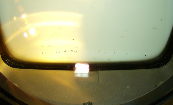

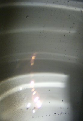

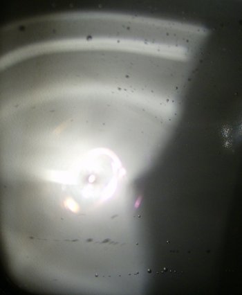

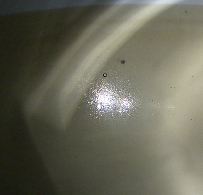

I have Bubbels inside one on the green Tube and much more on the Blue one´s lense.. Sad
I have now filled green and Blue red i have not filled yet for testing a other Method to fill without bubbels..
What can i do to get no bubbels from filling up the tube.. it´s a zenith pro 851.. 500ml Glycol per Tube.
It is clear but the bubbels are not fine to the Picture i thing..
Or are they going away when i have filled all and let the unit run for a wile..
Pleas tell me what i have done wrong Crying or Very sad

It's hard to get tubes that have only small screw hole filled without bubbles. If those tubes have expansion bellow in top of tube like some Sony tubes, using that bigger hole for filling helps.
Heat makes bubbles goes away faster, so using projector helps.
Posted: Thu Apr 10, 2008 1:09 pm    Post subject:
All tubes have bubbles in them when you refill them. AS Ile says, they will disappear within 2 weeks or so.

Posted: Thu Apr 10, 2008 6:49 pm    Post subject:
Yea that´s it i don´t must to refill again i love you all Mr. Green
I only must wait ... that´s what i am the best in Laughing Laughing
2 weeks? It should take a lot less than that.
