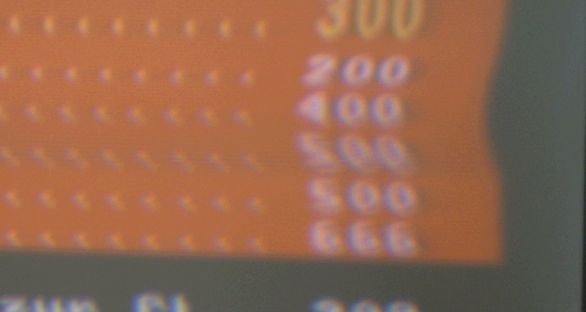

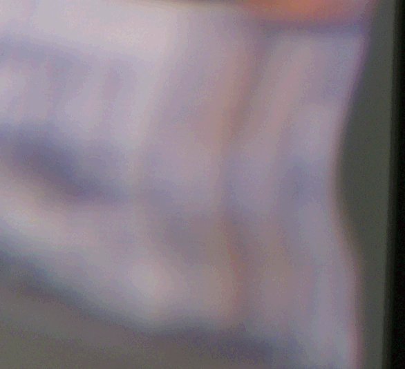

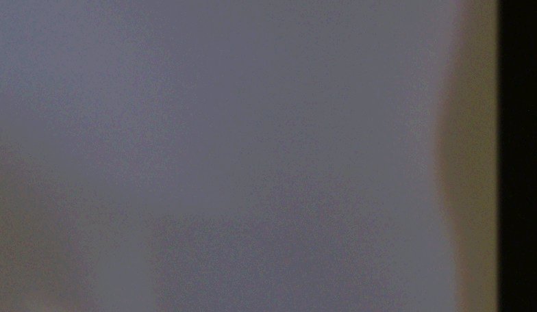

This Error is coming up every Time after a couple of Minutes...
It wents crom botton to Top slow and begins when it is gone ofer the Top at the botton of the Picture..
In wich Place can i look ... i have the complete service book with the Layout.
The Pictures are sharph but i have made them without the right camera ...
For that camera there was to less light Mr. Green

That is a hum bar. You need to lift the projector ground, or isolate the cablevision/antenna ground from the system.

Ground loops.
http://www.gbaudio.co.uk/data/ground.htm

to kschmidt2 it is not the zenith it is a PJ from my friend that i test for looking football..
And i am a idiot that i have not found that it is ground loop Mr. Green
Thank you all sometimes i see not the forest off the trees.. Thumbs Up

So i have ungrounded them... nothing hapens the hum bar is in every time...
So yesterday i took a Plan an sprayed in all what i have in K75 ice Spray... 8)
An look i just wonder when i spayed in the convergenc Driver Board with 6 TDA2030H on it the hum bar was gone away Laughing
The Picture was fine again.. Idea
after 2 Minutes it comes again Crying or Very sad smal bigger and then it went again from botton to Top or back or stands still
schould i decide too change all TDA2030H or what ca make that happen... Crying or Very sad

That's rare. Check the solder joints on the bottom of those and the voltage regulator, but I have not had a hum bar be caused by the convergence board.

I have checked the voltage and there is a diverence betwen the + and the - power Confused
+ 15V
- 13V i have orderd new regulator chip´s 79S15 and 78S15 i think that will fix it because the Elkos i have all changed bevore. Mr. Green Laughing

Didn't I send you a new 9-847 board? THat's the convergence power supply. Change that to see if that works.

It is not this PJ. Its the Hi-Beam 550 ...
But i have now orderd the part´s they are very cheap and when i have changed them i tell you if it work´s...
