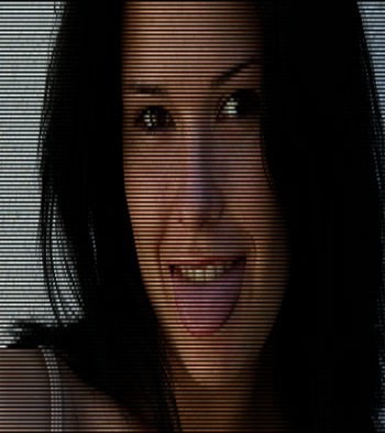

Keep in mind a CRT projector paint's the phosphor with lines ( sweeps from the electron gun ). It's not a fixed pixel device like your digital. So if you send it 1920x817 and leave your image full tube top to bottom it would look vertically stretched and the scan lines would have obvious spaces between them (see Fig.1 below ).

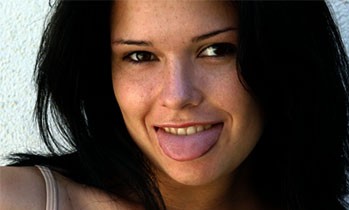

Now when you have this signal going into your CRT projector you goto the projector's controls and squash the vertical size down until it's back to 2.35:1(Fig.2).
This brings your scan lines closer together. The empty black spaces get filled in as you draw the lines closer together and the picture looks better and brighter ( you're painting the phosphor closer together instead of having the voids between the lines )
