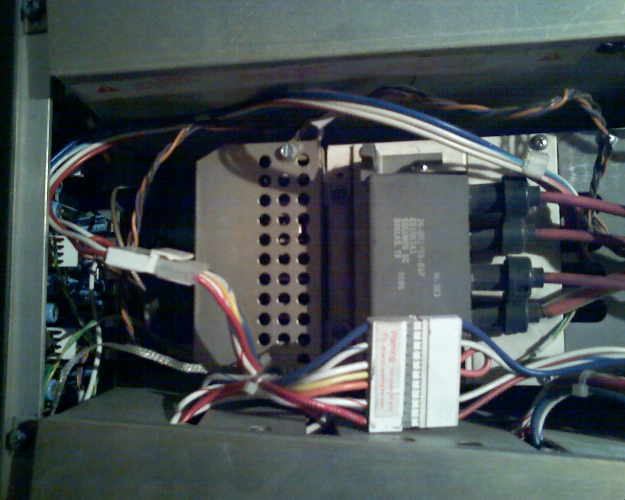

Here's an image of what i got, they're so many ways of rebuilding this prj. Confused

VDOfreak,
Is that the 8000 you got from me? If so the first thing I would check would be the mini RCA cables that go from the VIM to the VNB's, I had a little trouble with these years ago and had to resolder the connections on the VIM, however I never did anything with the connections of the neckboards, try swapping the red and green neckboards and see if that fixes the problem. It may also be a good idea to reseat the boards.
Erik
Posted: Wed Apr 16, 2008 3:19 am    Post subject:
Top left corner, R 86 I think it says..Smile
