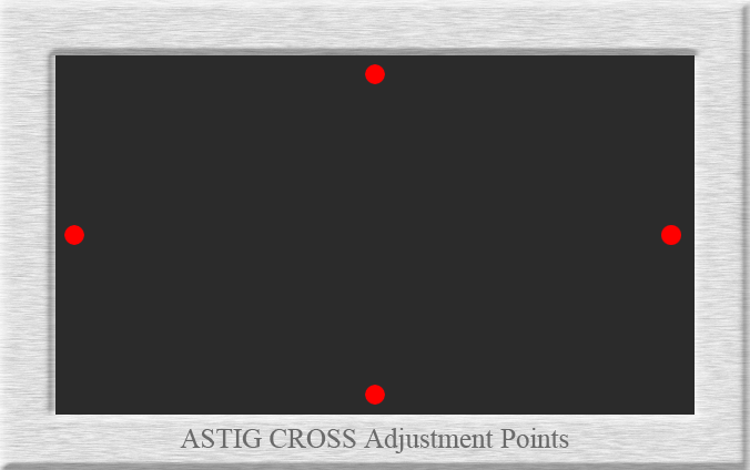

  • adjust the ASTIG CROSS (CTL+FOCUS) of the remote control so that the beam is circular at the selected points on the screen (select top, bottom, left and right using CTRL + left, right, up or down arrows).

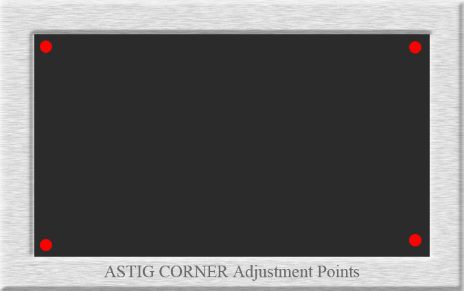

  • adjust ASTIG CORNER (CTL+FOCUS to toggle between ASTIG CROSS and ASTIG CORNER) of the remote control so that the beam is circular at the selected points on the screen (upper left corner, upper right corner, lower left conrner, lower right corner using CTRL + left, right, up or down arrows)

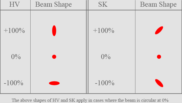

(for reference only) ASTIG Operation:
When ASTIG is selected, test pattern dots are automatically displayed, and the beam is defocussed
ASTIG has two directions of operation, which are displayed as HV and SK on the screen.
When HV and SK are changed, their beams will change as shown below:

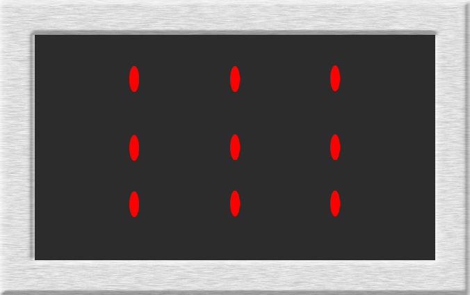

There is an additional preparatory step:
Adjust ASTIG CENTER H/V adjustment control until the top and bottom of the picture look like this:
The XG also has triangularity (6-pole magnets) as an additional step for C.P.C magnet adjustment. That step would be inserted between steps 3 and 4 of C.P.C magnet adjustment.
