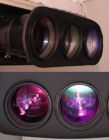

Ile
Posts: 1491
Location: Jyväskylä, Finland
Posted: Mon Apr 07, 2008 8:06 am    Post subject:
Where that light is coming from?
I'm going to use similar lens sealing what my previous hushbox had. Hushbox have few mm bigger holes what lens diameter are and then I cut tight seal from cellular plastic (hiking matress) and glue that to lens opening. It's air tight, but makes focus tweaking possible.
