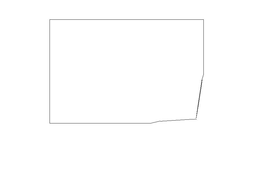

So I've been trying to set up my my Marquee reasonably well and I am having a problem. I can't get the lower right hand corner to square with the rest of the screen. I included a poor rendition of the problem I created in paint. I am guessing some sort of magnet thing I can't easily fix?
Also, I recently discovered I was never given to the password is to access the service menu. Anyone have any ideas there?

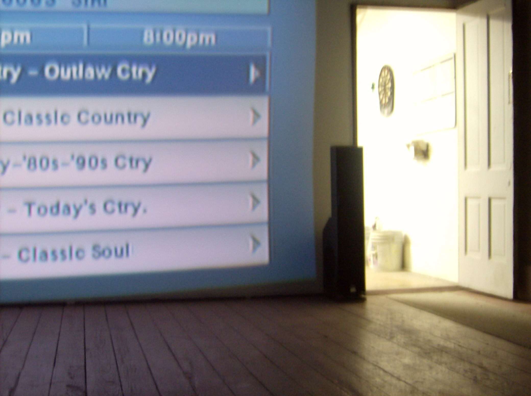

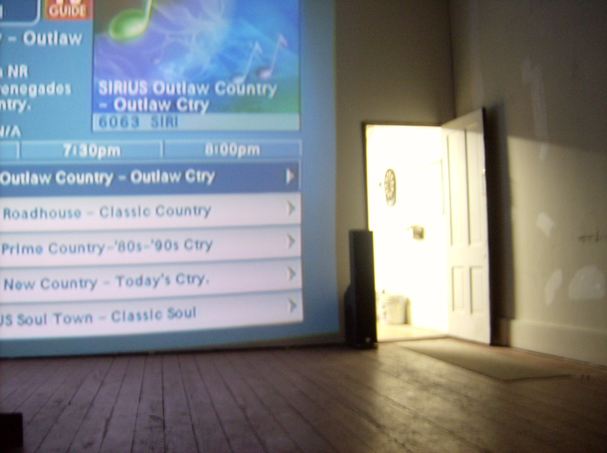

These are kind of blurry, but you can see what I talking about, it's not as pronounced as the picture I drew.

you can fix that with geometry
Posted: Tue Apr 01, 2008 12:57 am    Post subject:
Password is 0901.
Go into the convergence menu, down to 'service', enter 0901,. and use the interpolated green convergence. That wil cure what you see.

Make sure you're not too close to the tube edge, that can also cause that curving as the image hits the edge of the tube/lens.
Posted: Tue Apr 01, 2008 1:50 am    Post subject:
Looks like a problem I had when i got my 8500. Check to see if your scan yokes are centerd. I had the dip on the red towards the top left. here is the thread.
http://www.avsforum.com/avs-vb/showthread.php?t=849010&highlight=convergance+problem
I thought it was abad CLM then a bad vertical deflection board when all along it was the magnetics.

Thanks for the help everyone. Accessing the service mode fixed the problem completely.
