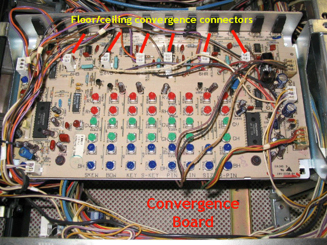

Convergence board
Shown below is the convergence board. It is a relatively reliable board, the
worst thing that seems to happen with these boards is that the controls get
noisy if used in a sports bar. A simple shot of control cleaner into the
trimpots make the geometry and convergence controls work smoothly again.
