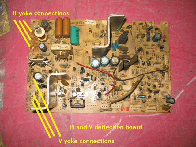

When you take the side panel off of the side of the set, you expose the back
of the deflection board and the transistor that works in conjunction with the HV
board. The deflection board contains all of the horizontal and vertical output
components. There are no user adjustments on the deflection board, but there is
one fuse on the edge of the board that is soldered into place. It rarely blows
unless there’s a fault on the deflection board or a module connector is
installed incorrectly.
![](images/Zenith851_image005.jpg)
The 6 yoke connectors are shown below. There is a ‘floor’ and
‘ceiling’ position stamped on the board, and these connectors must be oriented
the right way for floor or ceiling projection. There are also six connectors on
the convergence board that must be correctly oriented as well for good
convergence control and geometry of all colors.

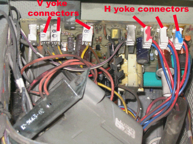

![](images/Zenith851_image006.jpg)
Looking at the deflection board when moving the focus block aside, the
deflection yoke connectors can be changed without taking the deflection board
out of the set:
