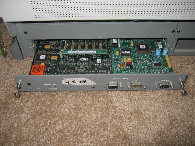

The CLM is the module pictured at the bottom left, in this picture. Unscrew
the two thumbscrews and pull the CLM all the way out of the Marquee, as
illustrated below. Keep in mind that the bottom of the CLM may scrape the
chassis below it, so pull it out carefully. If it gets stuck, just sort of lift
up and pull it backwards.

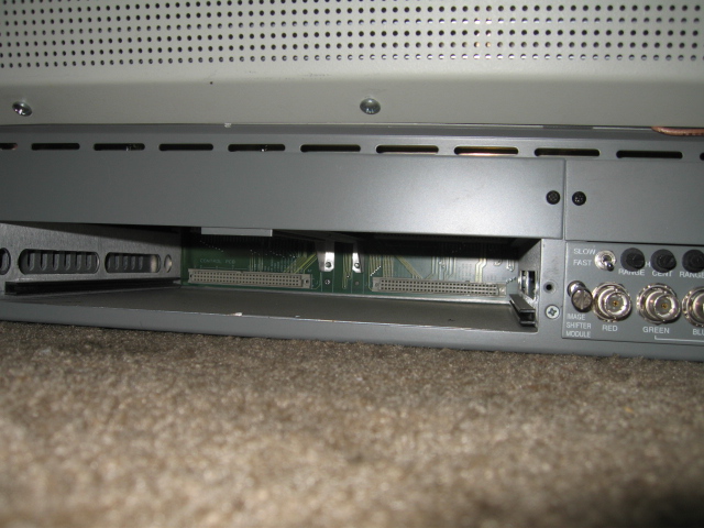

A picture of an empty CLM bay, just so you know what you're working with! That
lip at the front there, is what you want to watch out for as you pull the CLM
out.
