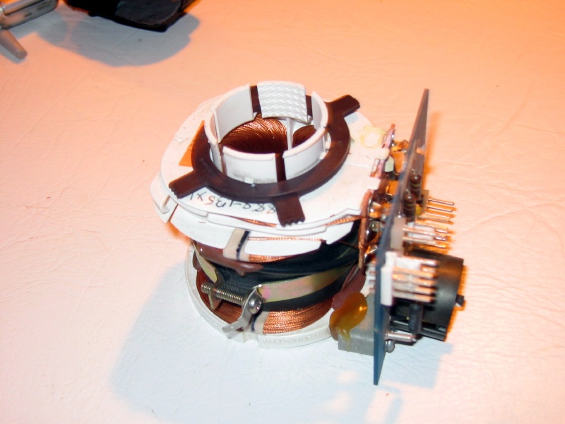

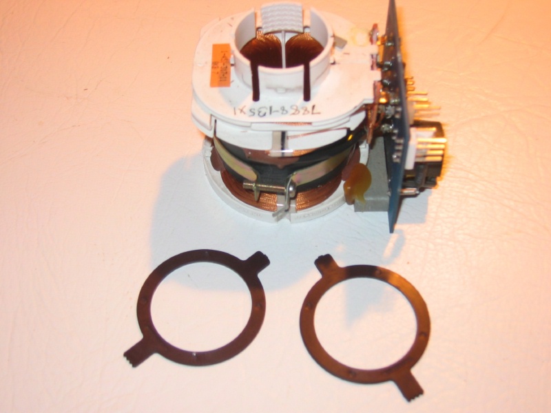

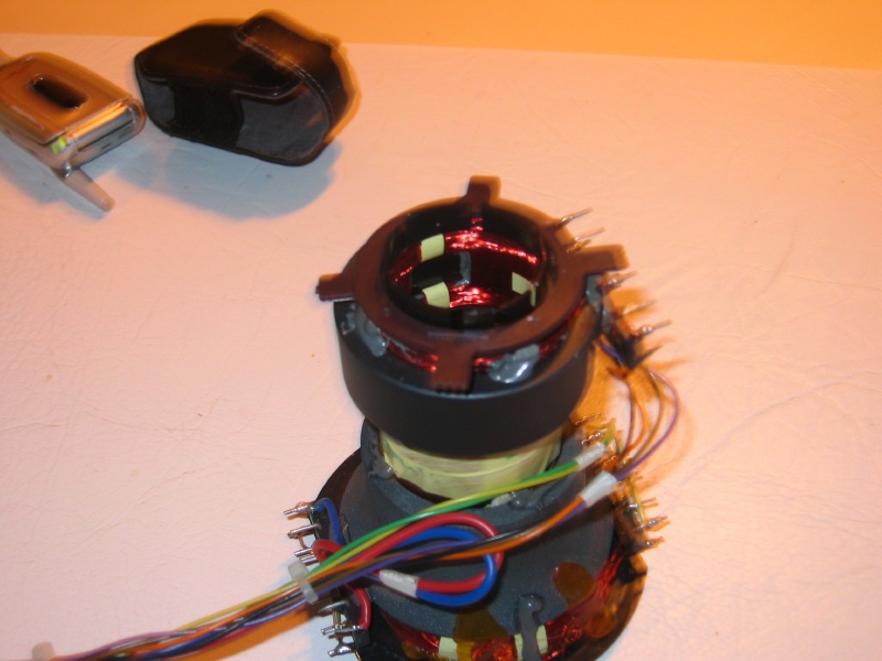

Ray Cendroski
Joined: 22 Apr 2006
Posts: 68
Location: Concord, Ohio
Posted: Wed Mar 19, 2008 11:13 pm    Post subject:
[quote="Robert A. Hill"]Ray,
What do those Ampro 2000 "centering rings" look like? I thought the 2000 only had the standard 2/4 pole astig rings. Scott sent me some actual centering rings last year that I tried on my 3600 with success. I was able to center my blue while minimizing the use of static vertical reg.
Here's a couple of pictures Bob. I don't even remember where I got them, or exactly what 2000 model they were from. They are plastic coated. I haven't tried them out on the 4600 yet. I got a set from Scott that he magnetized, but haven't tried them yet either.
Ray

k.berger
Joined: 16 Mar 2006
Posts: 84
Posted: Thu Mar 20, 2008 1:52 am    Post subject:
Rey,
thanks for clarification! I will keep it in mind as one of the projects for the future. I think of getting spare LVPS and HVPS anyway, so then I would be able to do it while still running the PJ.
Let me know, if you figure out easy way to rotate those centering rings - I have them on my 4200, but they are nearly impossible to move and they are near those relatively high voltages... I found out the hard way Embarassed !
Kris

Posted: Thu Mar 20, 2008 2:41 am    Post subject:
k.berger wrote:
Rey,
Kris
The best way to deal with the centering rings is to first pick all the silicon off. It always gets in the way and will keep the ring from sitting where you need it. If the rings bind up too much you might break the ring and that effs them up. The best tool for adjusting them is your fingers. I have seen people use plastic knitting needles, though.
Scott
Thomas Jefferson
