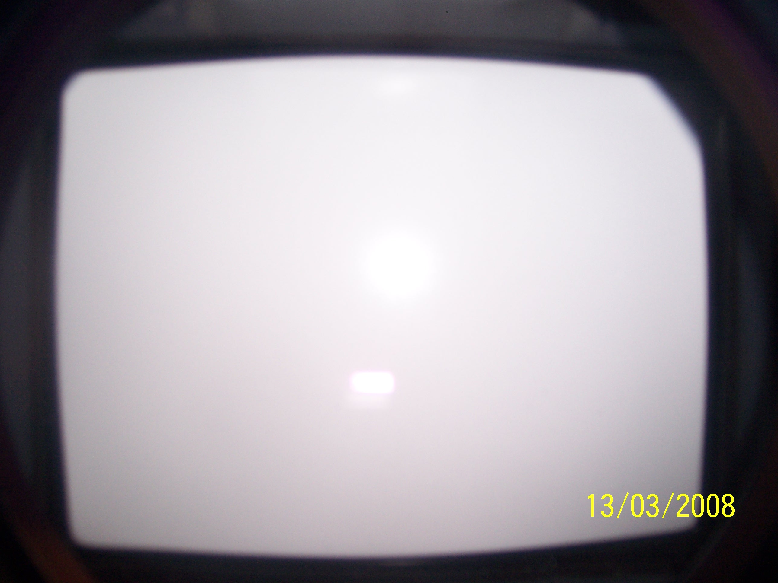

Hello all,
I am new to this forum as well as new to the crt market. I am excited to get started with the crt. Well here is the deal. I aquired the 9500lc, it is from 1996. I fired it up and onl the red and green crt were on, no blue. I then turned it of and started to tear the projector down to see if I could find any wires disconnected. As I got down to the tubes i noticed the green tube looked different than the red and blue tube. If you look at the pictures you will notice there is more adjustments that can be made by the magnets on th grren and not on the red and blue. Also I did notice that there were no wires unpluged not to allow the blue to light. Also the red crt does not look as bright as the green. If you look at the pics you will also notice that there is no burn in on the crt's. Can they blow out with no indication that they are bad. Is there a way to test them to see if it is the crt. Any help would be greatly appreciated. Thanks

Is this the 9500 with the bad blue that was listed on Ebay?
I would start by swapping neckboards and seeing if the tube lights.

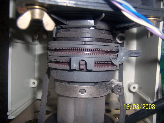

Here we go I got it thanks guys. And yes it was the 9500 on ebay.

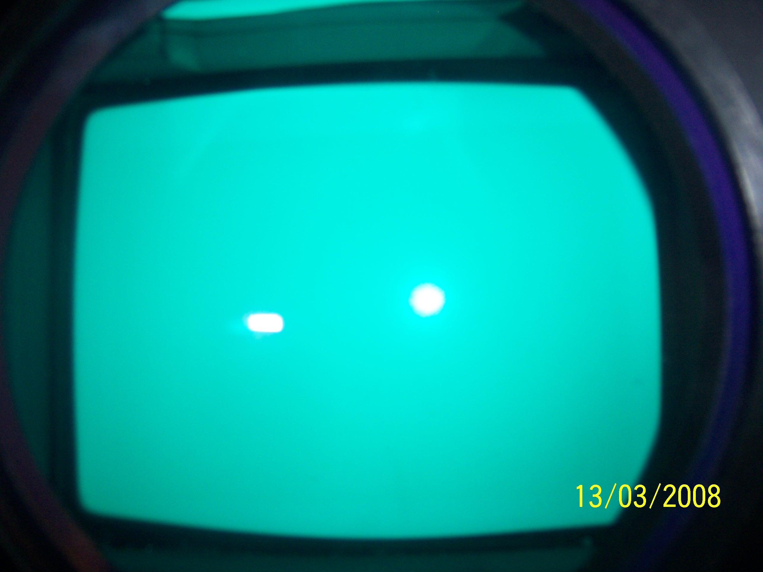

this is the green
 Filesize:  147.83 KB
 Viewed:  7512 Time(s)

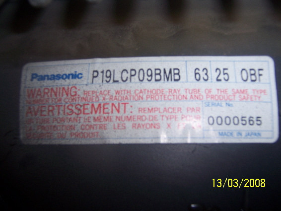

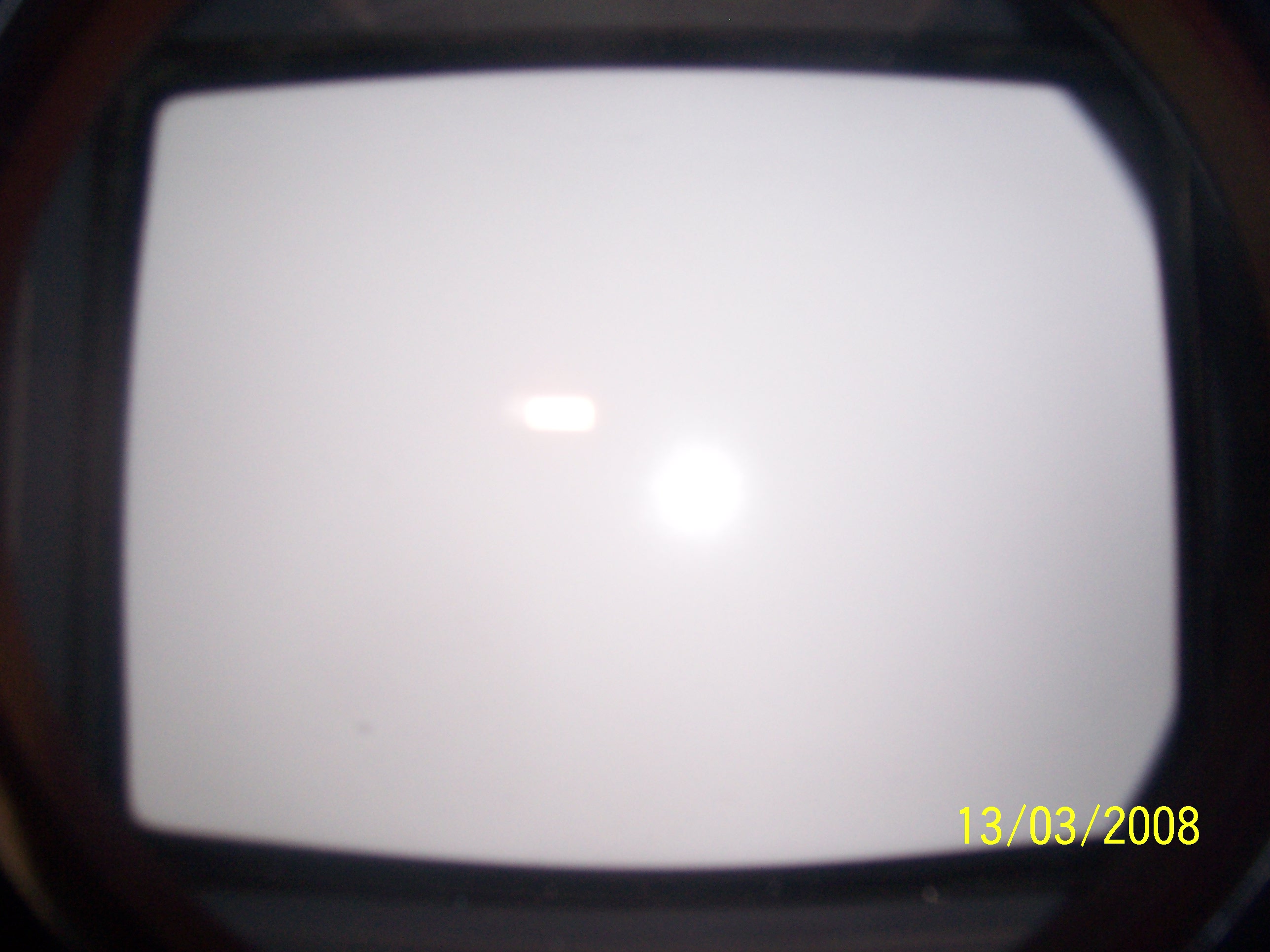

blue
 Filesize:  198.97 KB

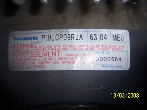

red
 Filesize:  219.14 KB

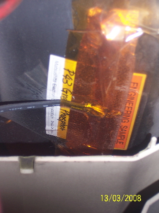

blue tube
 Filesize:  259.99 KB
green tube
 Filesize:  251.41 KB
Posted: Thu Mar 13, 2008 10:06 pm    Post subject:
Looks like the red and blue are stock, the green is a p43 so the phosfor is faster (useful for simulations) and may have also been stock in the machine.
Looks like the green also has four pole magnetics while the red and blue have two pole.
None of this looks too out of the ordinary though I would guess that the green is a replacement tube.

Posted: Thu Mar 13, 2008 10:28 pm    Post subject:
This set had 61,000 hours on it. That's a LOT of hours, and that green tube (and possibly the others) is most likely orignal stock. Yes, tubes can indeed die if they are left sitting on with no light output. CHances are your blue tube is completely shot, the red is weak. THe thing to do here as a newbie is transplant the blue tube with the red or the green. If the blue still does not light up, then the tube is bad and needs replacing. I'll bet the red needs changing as well. Again, very common with high hour sets.
Others might want to walk you through swapping wiring, but since you're new, swapping a whole tube assembly will be easier than swapping signal wires on boards that you're not familar with at this point.

Does the filament light on the blue CRT?

Posted: Fri Mar 14, 2008 2:29 pm    Post subject:
yes the filament lights up on the blue. I did do what curt said to do and switched the green and blue. Still no output on the blue. Crying or Very sad

Kal- I think that was posted on avs way back when, but I've talked to Tim and Terry, and we've all used P43s in HT with no issues.
cgraba, you need a new blue tube at least. Probably a red as well. I'd post in the buy/sell section to see if someone has good used ones, but at this point everyone is looking for them. VDC charges $1650 per tube for a new one, you need to send your old one in so they can install the new tube. There's a company called 'tubular outlet' that will sell you a new raw tube for $985 on eBay, and they also sell used ones for $250, but it's a royal PITA to swap those tubes into the Marquee hardware, not something I'd recommend for a newbie (but there are instructions here on the forum somewhere on how to do it).
Before proceeding, I'd check the G2 levels on the green tube, as it's probably on it's last legs as well. If it needs all three tubes, I would not proceed, and I'd part the set out. You can find another 9" set for less than it will cost to retube yours. With the HD10L lenses, you're stuck with a 72" image diagonal at max anyways, and most HT owners want somewhat larger than that as well, so there's more money you need to throw at that unit.

that means nothing. The filament, or heater, will light up but it's the cathode that is stripped. All dead tubes still light up in the neck, just not on the face.

Curt's right (as usuall) on this one, it's an Organ donor. If you part it out you might get most of your money back.
