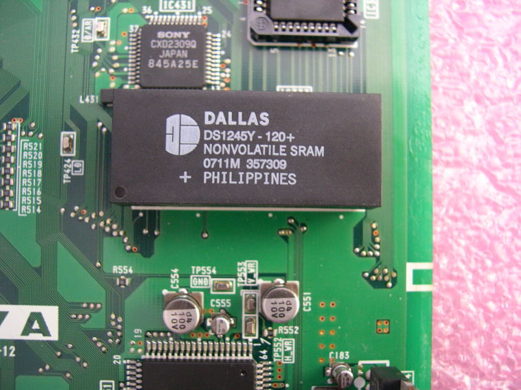

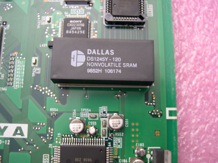

Removed the old Dallas chip in the IC333 slot on the YA board, copied the data from the old chip to a new Dallas chip, installed the new chip and put back the YA board, turned on the G90 and Shazam everything was exactly there as before.

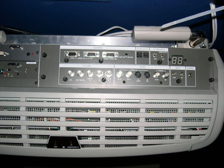

1. Turned on G90 and did a Data save to Service Block – Page 132 of G90 Installation manual. This was done as a precaution to a possible total failure of the old Dallas chip whereby it would not longer be readable (i.e. Battery too weak causing corrupt data, lack of readability etc.).
2. Turned G90 off from remote.
3. Turned G90 off from hard switch on back.

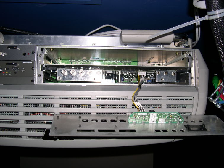

4. Unscrewed the 10 screws on the back of G90 near where YA board is installed and removed back cover.

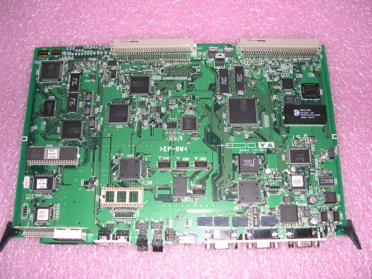

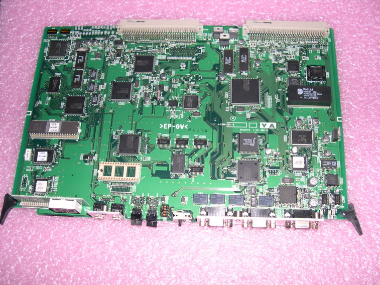

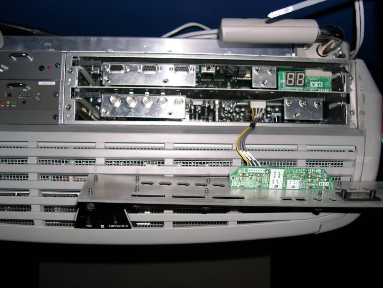

5. Unlatched the YA board black clips at either ends of the board and slid out the YA board carefully. Make sure that you are not carrying any static electrical charge as the YA board is sensitive to static electricity and you can end up damaging the board rendering it useless. (I think Sony is currently charging about 1700 to fix it)

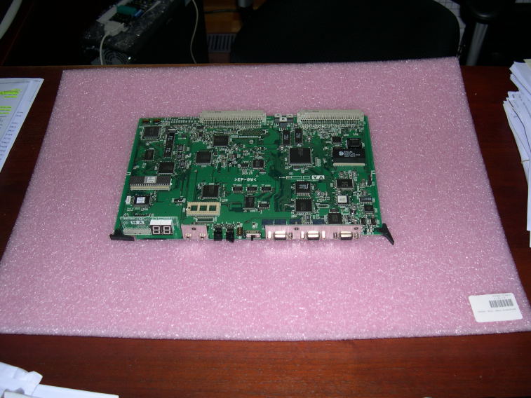

6. Placed the YA board on an antistatic foam sheet. Bought the sheet at a local electronics store measuring 18” x 24” for few bucks.

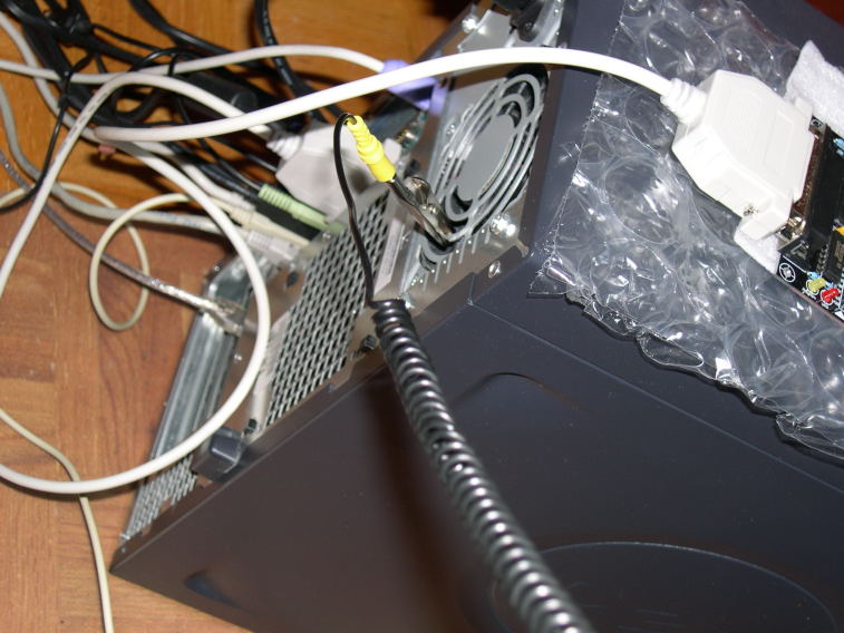

7. Put on an antistatic bracelet and attached it’s alligator clip to the back of my PC.
8. Removed Dallas chip with my fingers while holding the YA board down near the chip. Be careful in prying it loose here as the chip was solidly plugged into a white socket. It is not soldered. You actually need a fair amount of force to pry it off. I had pulled a bit too hard and accidentally hit part of the Dallas chip wires against my other hand and bent some of them. I carefully rebent the wires back into place.

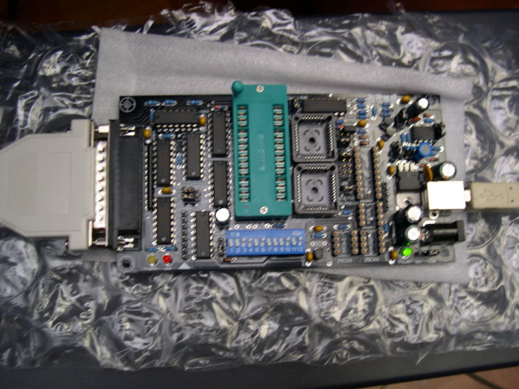

9. I then set up my EPROM programmer and placed the Dallas chip into the programmer chip holder. Very important to align pin one of the Dallas chip in the correct socket or you run the risk of damaging the chip when reading it with the EPROM programmer. There is a small circular indent (chips pin 1 marker) on the top part of the Dallas chip so it was easy to identify pin 1.
10. I then read the chip and saved data (hex file containing serial number, tube hours and user data – convergence, gray scale etc) on my computer.
11. Pulled old Dallas chip off EPROM programmer and installed new Dallas chip and Programmed/verified data to new Dallas chip.
12. Installed the new Dallas chip to the YA board. Make sure that chip is installed with pin one in the correct socket. The old Dallas chip and new Dallas chip looked identical so I just installed the new chip in same direction as the old chip (identified by the direction of the writing on the chips). Make sure you make a note of the direction when you remove the old chip. Again, be somewhat careful as you need a firm amount of force to fully put the Dallas chip all the way back into the socket and you do not want to bend the Dallas chip’s metal pins in the process. I first aligned the chip parallel to the socket on the YA board, initially pushing lightly to get the pins in as much as possible and as evenly as possible and then applied a much firmer even push to both top ends of the Dallas chip to get if fully in.

-Old Dallas chip was a DS1245Y - 120 with date inscription on top of chip of Dec 1998 (Chip date code 9852H - showing chip made in 1998 on 52nd week)
-New Dallas chip was a DS1245 - 120+ with date inscription on top of chip of 2007 March (0711M – showing chip made in 2007 on 11th week). The “+” sign refers to RoHS compliant and is Pb-free as required in Europe. This makes no difference and since this requirement was introduced in 2007 I knew I would be buying a “newer chip”.
 Filesize:  120.29 KB
 Viewed:  42542 Time(s)
 Filesize:  127.17 KB
 Filesize:  129.44 KB
 Filesize:  129.56 KB
 Viewed:  42543 Time(s)

Is that a Willem programmer you have there?
Frank D
Joined: 20 Jun 2006
Posts: 73
Posted: Wed Mar 19, 2008 4:12 am    Post subject:
Yes it is. It worked excellently.
