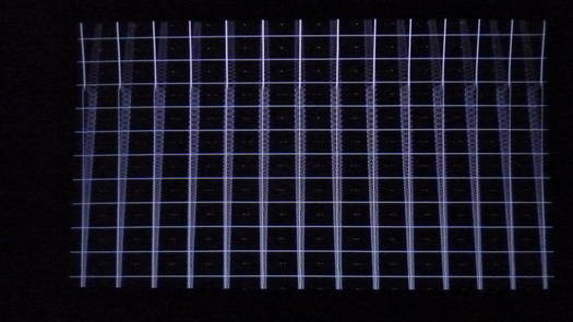

so finally got around to doing / testing the larger heatsink on the HMD for those cases where the horizontal deflection starts to Oscillate. I wanted to see how much of an improvement there was i temp. reduction. I never did figure out what went wrong with my Cree FET modified HDM or why it failed during testing, but this was something I always intended to do since this issue popped up on AVS for Ralpharch. Since then it has been posted by at least 3 or 4 other people.
http://www.avsforum.com/t/1266475/marquee-with-intermittent-horizontal-scan-problem
It always seems to crop up in situations where 2 or more of the following situations exist
1) ceiling mounted configuration
2) high scan rates
3) picture set to "short retrace".
4) warm ambient temps (summer-time viewing)

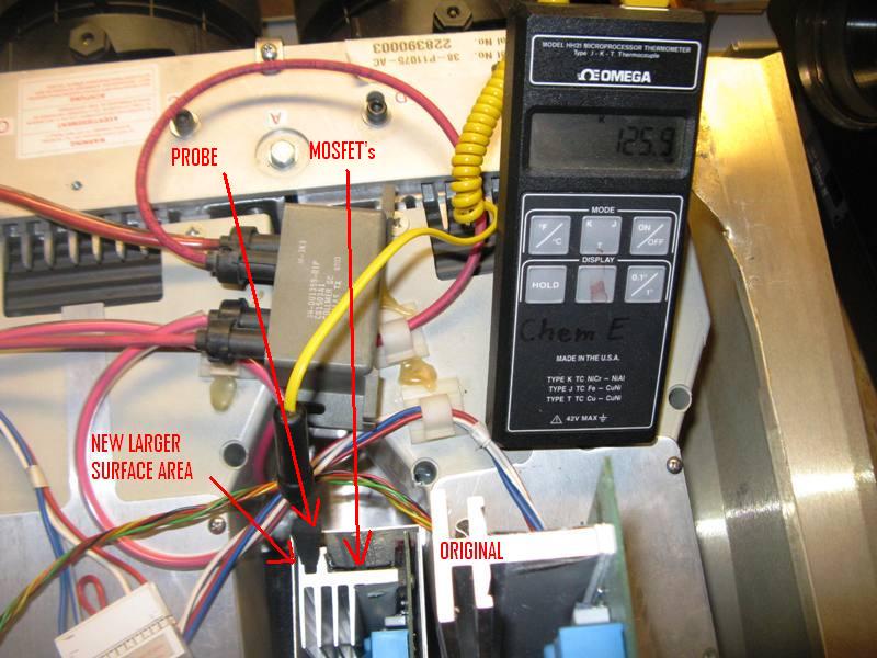

What I did, and what i'm pretty sure VDC did as well, was to modify the focus amp sink and swap it over to the HDM. One of the 5 small fins needed to be milled off to clear some board top components. However the increase in overall surface area is significant and more importantly, the new fins are directly in the air-flow of the belly fan ( like they are on the FCM). I also applied new insulating tape since the tape needs to actually make a 90 degree turn at the top and go horizontally over the perpendicular fin for 3 or 4mm. This is because the tall FET's on the HDM actually touch the top of the factory heatsink and the FCM sink didn't have the tape extend as far.
I used Silicone coated KApton tape with a dielectric rupture strength of 7000 volts+ Dielectric Silicone paste as an added thermal conductor and electrical insulator. Here are the before /after temp's in different room conditions 64Khz horizontal sweep.
1) original 07P HDM factory heat-sink
start (ambient) 79F / Finish 148F = + 69 degree's
2) with new larger heat-sink
test 1
ambient 86F / Finish 134F = + 48 degrees
test 2
ambient 79 / finish 126 = + 47 degree's
So according to my calc's the new heatsink is shedding heat faster and reaching a steady state temp. that is 32% cooler than the original Electrohome factory version. the only issue I see with this modification is

Posted: Sun Jul 01, 2012 7:52 pm    Post subject:
I'm curious. Are you measuring the temp of the heat sink itself or the components attached to it?
Posted: Sun Jul 01, 2012 9:03 pm    Post subject:
The FET's are covered by steel spring clips which keep them securely pressed against the AL sink

This is from someone who had problems with Oscillation so the true test will be in his machine, ceiling mounted 9500. looks promising though, been running all day and even though the temp. in the garage has soared the probe is still showing only 126 degree's Fahrenheit ( 52 Celsius ).
At any rate, this approach worked for VDC so it wasn't something I "invented" and it certainly can't do any harm to have more metal there.

So probing the heat sink is telling you the transistors are running cooler?
