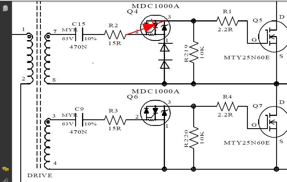

ok, spent some time talking to my friend at work about this, admittedly he has not studied the circuit but there are some issues he brought up I thought worthwhile discussing. I mentioned to him that I thought maybe one of my drivers had failed and the fact that Dennis's were still working, only difference is Dennis used a 40V rated driver vs. 35. He said that even though you might be giving a 35V driver only 24 volts there is a possibility of a backwave or reflection from the MOSFET that is much higher. These transients shows up as spikes and are hard to see even on a scope.
So I said wouldn't there have to be a Diode in the cicruit somewhere to protect the driver? Then it occurred ot me that there was, the GTO was acting as a clamp for both the Drive and the gate voltage right? Scott pointed out back in July
You need to short the gto and add a diode to clamp the drive so it swings from about -0.7V up to +19V or so. You need to do this with all three of mosfet drive circuits. The sbyv27 parts should work fine.
However even though the drive had been clamped the gate is not. Could we be getting voltage spikes back through the driver across R2/C15 and R3/C9?
The uc3709 drivers claim
"With inverting logic, these units feature complete TTL compatibility at the inputs with an output stage that can swing over 30 V.
The Clare's I used don't give a range, but simply say
• Logic Input Withstands Negative Swing of up to 5V
I realize I might be totally blowing smoke out of my you know what but I'm looking for a reason this board failed. I mean there might be a reason why the UC3709 driver costs over 3 times as much as the Clare right?
The UC3709 family of power drivers is an effective low-cost solution to the problem of providing fast turn-on and off for the capacitive gates of power MOSFETs. Made with a high-speed Schottky process, these devices will provide up to 1.5 A of either source or sink current from a totem--pole output stage configured for minimal cross-conduction current spike.
SOoooo, could the Clare driver be failing and if it is failing is there something we need to add to this circuit?

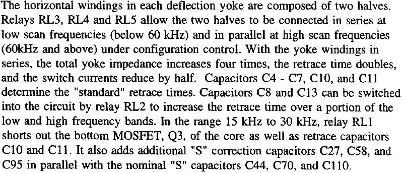

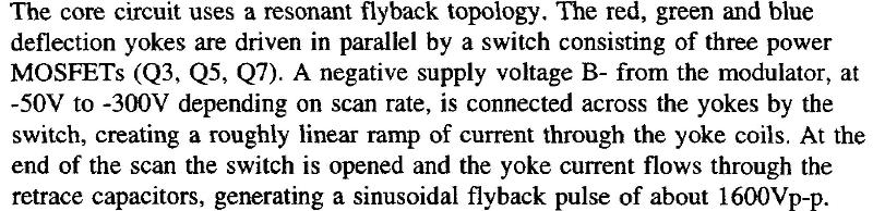

second problem, the HDM shorts out Q3 under 30KHz which isn't a problem since we're removing Q3 anyway. however it also shorts out C10 and C11.
So with this modification at low scan rates c10 and C11 are shorted but now we're also missing C4 and C5 in the core. Now we're down to a pair of 1KV rated caps in a 1600 volt peak to peak circuit. Is that even safe?

there is an isolation transformer between the fet and the driver.

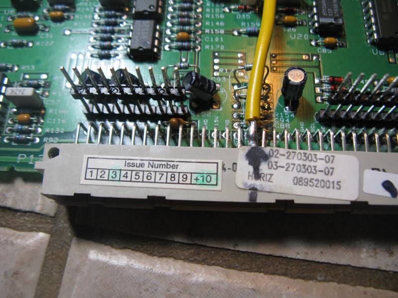

you got the 24v at p17 right at the pins, why not at the daughterboard like i did?
did you get the24v after r154 or before (thus straight from the lvps), the 22ohm fusible (check that resistor first, it might be blown)?
well 2 reasons. I didn't want the DB captured on the HDM and therefore not easily removed for cleaning or replacement at a later date. Second reason is the traces on the back of the HDM leading to the DB are very thin. I had some concern about overloading a trace.
straight from the Mobo connector P12 - pin 17. I would have smelled a blown fusible, I have the nose of a bloodhound but I'll check

my daughterboard isn`t captured either, the 24 volt trace goes to a resistor and that`s where i get the 24v.

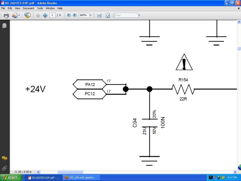

so it looks as I suspected, bad driver. U1 is shorted between pins 4 and 5, measuring basically no resistance
pin 4 - channel B Logic input
pin 5 - Channel B Output - Sources or sinks current to turn-on or turn-off a discrete MOSFET or IGBT
http://www.clare.com/home/pdfs.nsf/www/IXD_604.pdf/$file/IXD_604.pdf
So I'm having a hard time believing that pin 17 as a direct source from LVPS could have caused this. I see there's a small decoupling cap for noise and R154 fusible which is safer for the circuit in case of a serious failure or short but to actually damage the driver by grabbing the supply before that point? Either the driver Dennis used is a lot more robust or I just got a defective one? I'm leaning towards the latter as the weird raster anomaly I had right at the start might have been crosstalk or the internal voltage leakage from the driver right off the bat.
I'm going to order the better UC3709 driver , some 2KV rated Poly's in 2n2 and 3n8, and move the yellow wire to after the R154 fusible resistor. Anything else? Confused

Drags come off the other side of the r22 so you have that extra safety of the fuse.
r154 soll das sein.
Posted: Sat Jan 28, 2012 6:16 am    Post subject:
r154 soll das sein.
Yeah I meant the 22ohm resistor 154 Wink

I've ordered the new parts but I'm still bothered by why the driver or drivers failed?In looking closer at the application sheets The Clare part can handle up to 4amps of peak current while the Texas Instruments 3709n is 1.5A max, about a third. So if there was any kickback from the Cree FET the Clare part should have been better suited.
I'm thinking it has to be a supply side issue, but there again both parts can handle voltage swings of 4.5 to 40 volts. The DC supply from the LVPS is regulated so that's practically impossible.
Last possible issue some kind of AC component to the power, I pulled 24VDC basically right off the Mobo where as Dennis grabbed it after the first de-coupling cap and 22ohm fusible resistor. Also, the first 2 de-coupling caps at U1 on the older board has a small MLCC of 500pf and 10uf /50V aluminum can vs. 2.2Uf Mylar + 47uf Alum. can on the newer boards.
Is it possible an AC component on the 24vdc line damaged the Clare drivers?
