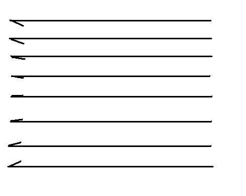

ok, so the second half of all that blew my little brain apart but I think I found a problem yesterday with Short retrace and the current caps on this board, where C6 and C8 = 6.8nf. Initially I read the above as "make sure the caps are the same value" but I see now a higher value on the caps = longer retrace time and by removing C4 and C5 it's even more exaggerated. In checking, all my boards here from 1995/96 have 6.8nf in positions C4, C6, and C10. I'm guessing the schematic Dennis posted is from a newer board?
So on older boards both C10 and C6 might need replacing with 2n2? In Short retrace I'm getting a little "tail" on the test pattern grind at the beginning on the scan sweep (left side / table mount) looks like this

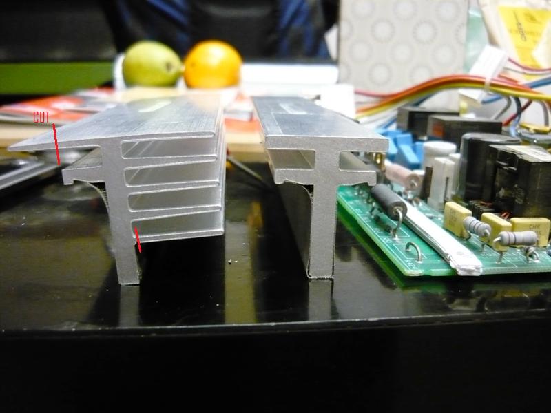

Had a little extra energy last night to go out into the shop after work and found another interesting observation, I wonder if this is where the bigger VDC HDM heat-sink came from?
the heat-sink on the left is from the FCM. To get it to fit you need off nip off the 2 existing mounting tabs (not pictured) , drill and tap a pair of 6-32 holes on the center of the main center section, and also mill or hacksaw off
1) the lowest fin on the right side to clear the existing parts on the HDM.
2) Half of the top/left fin to clear the card-cage
All in all I think the amount of heat-dissipating surface area is increased by 300%
