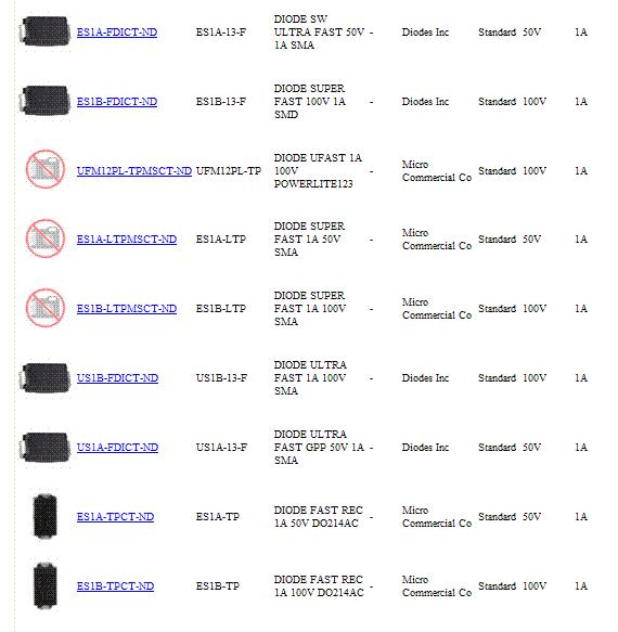

dragan, i wouldn`t use zeners, just get the diodes from the mouser link.
I agree. The SBYV27 is a good choice for the added drive clamp diodes. If you have to use smb the following will work fine. In fact, just about any 1A 50V or more fast rectifier would do the job.
Scott
Fast rectifier yes, zener no, check . Thanks Scott, much appreciated.

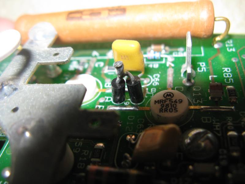

I actually purchased the small ultra fast 100V SMD diode's Scott posted.
Your talking about putting 2 of the wire leaded Diode's in series like the factory did on the video neck-boards? If so, then yes, this will need to go on the front and the small 10K resistor on the back.

Posted: Sun Dec 18, 2011 7:16 pm    Post subject:
Drags replace those diodes on the VNB with the sbyv's Wink
