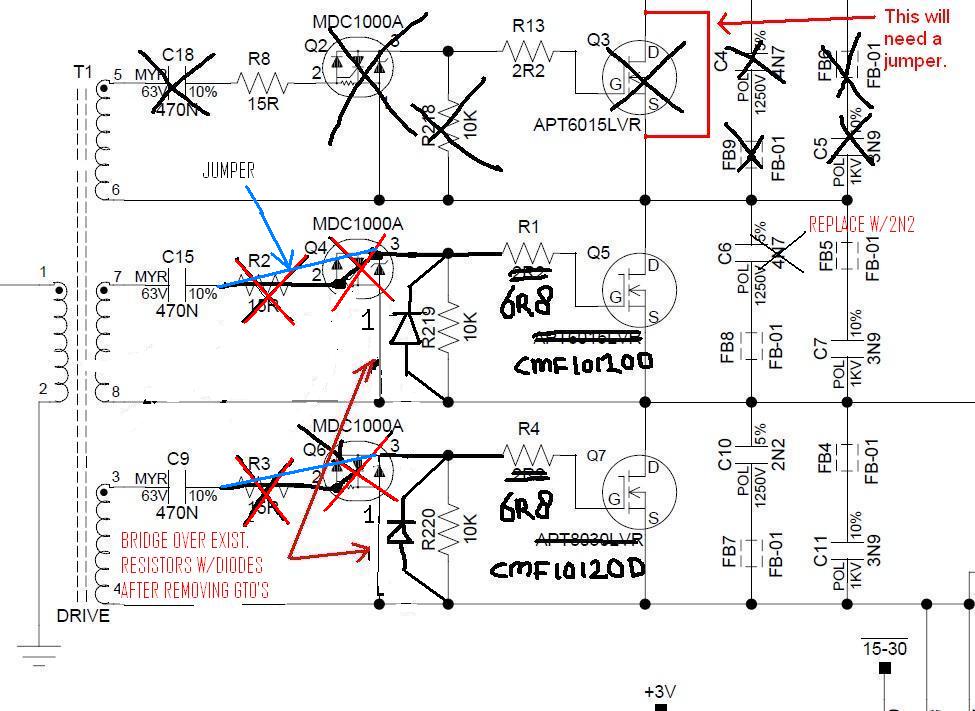

replace the diodes on the cva with the sbyv27-200v (16 in total i think) and add the grounding strip.

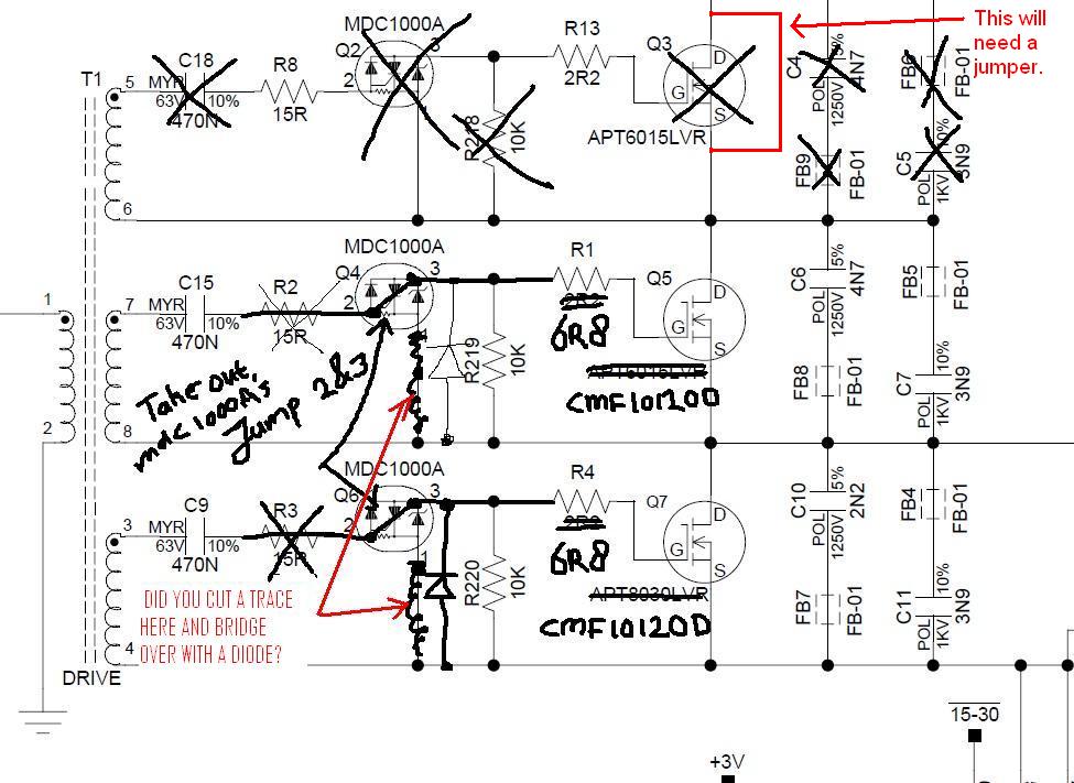

draganm wrote:
dvh99 wrote:
if you print out the schematic with the changes it will make it a lot easier.
I did print up your schEmAtic Dennis.
dvh99 wrote:
you should jump wire q4 pin 2 and 3 (closest 2 holes to the heatsink) not from a resistor to a hole where a pin of q4 was.
what about R2 and R3, you show those as eliminated? Do we jump Across R2 then across legs and 2 and 3? Isn't that the same as what I posted above with 2 wires instead of 1?
dvh99 wrote:
the heatsink must be removed in order to get this modification done right.
not a problem
dvh99 wrote:
diode is for voltage clamping this must be across the resistors on the bottom of the pcb (r219 and r220) with the minus side of the diode in the direction of the heat-sink.
So we leave R219 &220 in place and simply bridge over them with a Diode?
the thing that's confusing is you show a trace cut on the board where you crossed out this line? Is this cut what your bridgeing with a Diode?
no i didn`t cut a trace there.
it was to make clear that the connection is gone after removing the mdc part, i failed at that in retrospect.

draganm wrote:
I don't have a spare HDM' here so someone else needs to try this first..............Nash? Mr. Green
Why do I always have to be the Guinea pig!!!!
Very Happy
Wish I had time. I might order the parts and try it on my spare HDM later this winter. My Longbows have the fat heat sinks so they don't need this mod.
I need more hours in a day!!!
And Dennis is correct for the CVA, add the Soft recovery diodes.
Actually add them anywhere a 1N4002 Diode is.

Thanks Scott and Dennis for clarifying. I think I will replace R219 and 220 and install them from the front of the board, then nest an SMD diode between the leads on the bottom side. That whole area is rather small to get 2 through hole devices on the same holes. I'll post some pics if I wind up with a working HDM. Smile

Posted: Sun Dec 04, 2011 11:29 pm    Post subject:
replacing c6 with a 2n2 to get the same voltages across the switching mosfets is a good idea, will do this.

dragan, i wouldn`t use zeners, just get the diodes from the mouser link (get 100 to replace all 1n4002 parts)
ok,
you mean replace all 4002's on my machine right, not everybody and their mother's. Laughing Do we still need to jump C4 and C5? You did that earlier in the thread but it's not on the drawing?
Dave, lets see if this works first before sending me anything. My Mod's are mod's too they're just not this Mod'y.
dvh99
Joined: 25 Dec 2009
Posts: 2158
Location: nederland
Posted: Mon Dec 05, 2011 12:28 am    Post subject:
c4 and c5 are parallel to q3 so either one of them jumpered is fine i guess.
