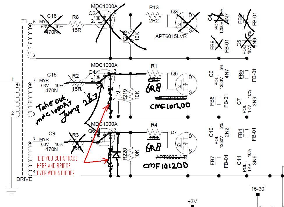

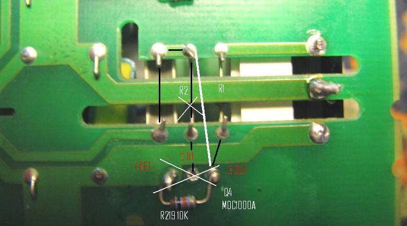

Ok, got an ever bigger headache now. Smile I was looking at the back of the actual PCB and noticed A couple of things I don't Reconcile with the drawing posted earlier. If we
1) take out Q4 and R2, and
2) by default R219 which is acting as a Return leg? then
3) jump-wire from the top of R2 to the through hole for the old "out" leg of Q4
Why do we need a Diode anywhere?
Black lines show traces on opposite side. Fat white line shows new jumper.
 Filesize:  41.08 KB
 Viewed:  9315 Time(s)

It often helps to mark up a schematic to make sure everything is right.
IXDI604PI is a cheap high performance inverting (sorry about the non-inverting confusion) driver with the same pin-out as the original.
you should jump wire q4 pin 2 and 3 (closest 2 holes to the heatsink) not from a resistor to a hole where a pin of q4 was.
the heatsink must be removed in order to get this modification done right.
diode is for voltage clamping this must be across the resistors on the bottom of the pcb (r219 and r220) with the minus side of the diode in the direction of the heatsink.
if you print out the schematic with the changes it will make it a lot easier.

oops you`re right of course with the jumpering of r2 to pin3 of q4, i just jumpered the components i took out without giving it another look.
I did print up your schEmAtic Dennis.
thanks
not a problem
dvh99 wrote:
diode is for voltage clamping this must be across the resistors on the bottom of the pcb (r219 and r220) with the minus side of the diode in the direction of the heat-sink.
leave R219 &220 in place and simply bridge over them with a Diode. got it !
the thing that's confusing is you show a trace cut on the board where you crossed out this line? Is this cut what your bridging with a Diode?
 Filesize:  109.95 KB
 Viewed:  9270 Time(s)
