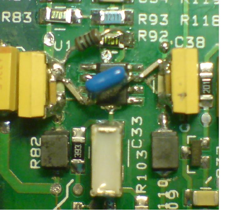

That THS3201 chips is really hard to "tame" i tested that on vnbīs and got gain and everything work ok, but there was lot noise on background and it did not looked any better than clc449 bandwidht wise. On Vim that works, least on 2035-02p Wink

Posted: Thu Apr 17, 2008 5:35 am    Post subject:
Here is how i did that decoupling, that picture is from vim.

Posted: Thu Apr 17, 2008 10:47 am    Post subject:
1031 wrote:
Funny! I just got those El5166 chips yesterday, quick testing showed that works pretty well, without any resistor changes.
I order those el5166 chips as samples-> went weeks->nothing, so then i asked at Farnell Finland and they said that those are coming to stock, so i ordered those-> after two days i got those free samples and same chips from farnell Mr. Green
Nashou, you use 100pF mica cap for highfreq decoupling, i foundet that wiht least three caps parallel makes better job
So for Vnbīs trye something like that -> 4,7uF tanf + 100nF(that is in there allready) +22nF then that 100Pf mica
And remember that smallest cap should be close to op-amp supply pins, so that 100pF mica works better if you can put it closer to op-amp maybe parallel to those original 100nF caps
Here is good article-> http://electronicdesign.com/Articles/Index.cfm?AD=1&ArticleID=1478&pg=3

Actually i was lazy, i did that order two weeks ago..
No keep those original 100nF caps there but put those 100pF micaīs arcoss them. Those caps on that picture are 15uF low esr tant+470nF cer+ 100nf(that original one) and 47pF cer and that blue one is 100nF and that is between vcc and vdd (+5/-5v)pins. Also i replaced those 4.7ohm resistors with 56uH smd coils. I scoped noise voltage on vcc/vdd pins and that cap combination showed that noise was very low. Much lower than original 4.7ohm+100nF combination.

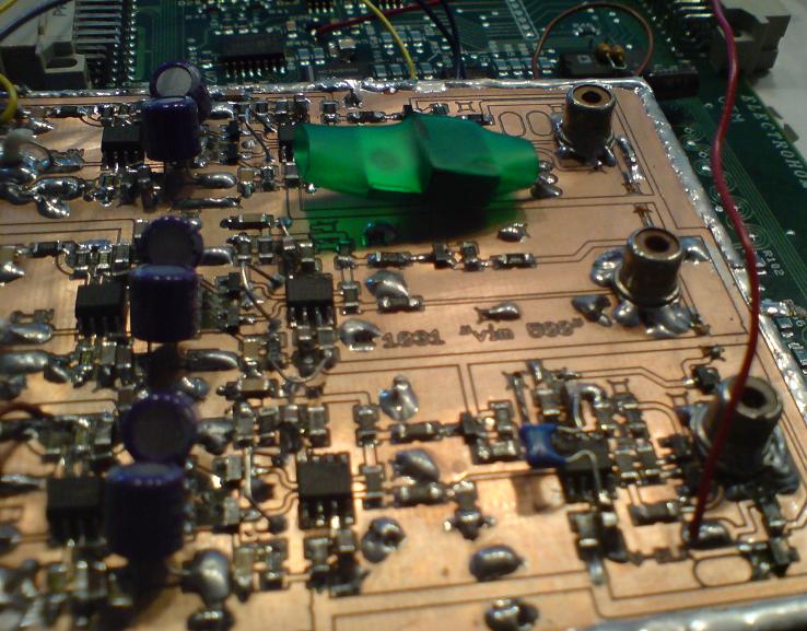

Posted: Tue Apr 22, 2008 12:45 pm    Post subject:
I had little time last weekend. I changed those rest (first amps are ths3201 allready)clc449 chips to those EL5166 chips. Yes those are tad better than originals.Nice found Athanasios, those are really easy to chage because there is not need to change any other components Thumbs Up

Posted: Wed Apr 23, 2008 4:57 am    Post subject:
wait till you change the cap values. I only used the 4.7uf that the data sheet specs.
Cap mods are done Wink I have version 3 off my "1031 vim 500" card now on place, i tested different decoupling things with that card. Instead of those 4.7 ohm resistors i used small ferritebeads (size 1206) and little more capacitance->looks good.
As you can see that card has some errors , there is some jump wires. But i trye to desing that better so maybe some day that card is perfect..

Posted: Wed Apr 23, 2008 5:05 am    Post subject:
looks great Jarmo!!! To connect the card to the lower card maybe you could try to use a pin to socket set up like the daughter cards on the CLM? Understand what i mean?
So are you just taking the video signal straight from the relay on the 2035-02 vim and directing it up to your "1031 Vim 500" ? and how are you getting the internal video
to the RCA? are you still using the SD5401 chip or did you decide to use three seperate analog switches to eliminate the internal cross talk of the SD5401? I'd love you to send me the schematics so i could study them. I envy your enthusiasm to this project!
what size caps? I have those SMT ferrite bead inductors but have not used them yet, they have the same 4.7ohm reading so they should be fine. what are your beads readings?
