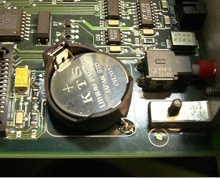

Update to the CLM mod, do not replace the buffering caps x31 and x32, these are tied into the battery and will cause the battery to drain. if you replaced them with tants go back to the ceramics that where already there. looks like battery power on the CLM likes non polar caps.
here is another little tip for the extreme DIY'er. the battery on the CLM is hard to find and expensive when you do. If you take it apart very carefully you can find your own lithium battery of 3 volts and put yours inside. Use leads cut from a capacitor or a resistor to solder to the battery top and bottom then feed it through the holes in the battery holder. CAUTION!!!!!! I assume heat near the battery can cause it to explode, if doing it you might want to not solder it and make up some kind of clamp with the wire soldered to that. Use extreme caution and do not allow the battery to heat up to much . Also wear safety glasses for this job.
Pic of insides of Battery

Posted: Tue Sep 15, 2009 6:08 pm    Post subject:
This is how i have done that "battery issue"
Edit: Seems that PaulB posted similar "battery replacement" instruction at another thread.. -> https://www.curtpalme.com/forum_archived/viewtopic.php@t=17806.html
But it doesend hurt to have picture at this thread also..
 Filesize:  89.8 KB
 Viewed:  14527 Time(s)

Posted: Tue Sep 15, 2009 7:20 pm    Post subject:
This is probably the best place for it Jarmo. I was only just ending the thread I'd started but as its really a maintenance solution having it in this thread is perfect!
