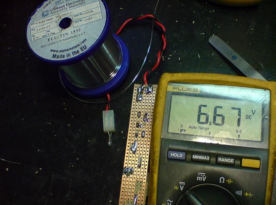

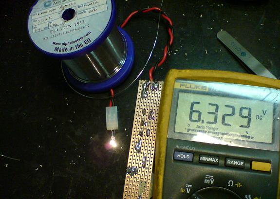

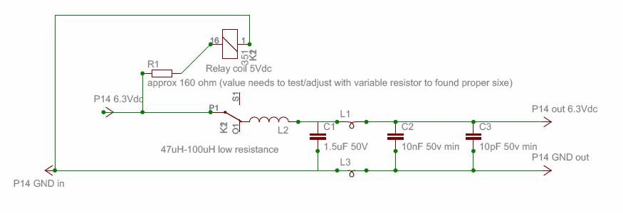

Ok here is one mod that is quite easy to do. Every Marquee owner knowīs and have heard horror stories what happens if filament voltage rises too high and many has done that "P14 mod" to Lvps. Ok there is many Marquees still that has not have proper mod done and there is risk that tubes can damage due too high filament voltage. So i designed very simple circuit that cuts P14 supply from tubes if filament voltage rises too high. I wanted simple system and tested how accurate is basic 5V relay.
So idea is to use relay that has 5V coil and use series resistor to adjust "cut out point" I tested vith lab supply and I noticed that it is accurate enought to cut out overvoltages. That cut out point is near 6.6-6.8Volts and it seems to be best compromise so that relay doesent cut out too early (near that 6.3v)
To find out value of series resistor to relay, i used 470 ohm multiturn trimmer and adjusted it so that 6,6v is point that relay cutīs
It was little under 160 ohm, so then i replaced that trimmer with solid resistor (150+8,2 ohm) and tested "cut out point" again, it was again near that 6,6vdc.
So simple 5V relay + series resistor can be used as overvoltage protector.
If there is voltege that exceeds that 6,6v then relay cutīs supply and then picture just fades away.. to get picture back projector must disconnected from mains for while. ( but if that happens best thing to do is do that P14 mod to Lvps)

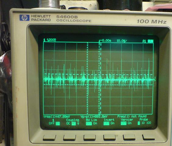

Ok more..
Noise..yeah, there is lot of it at P14 line.

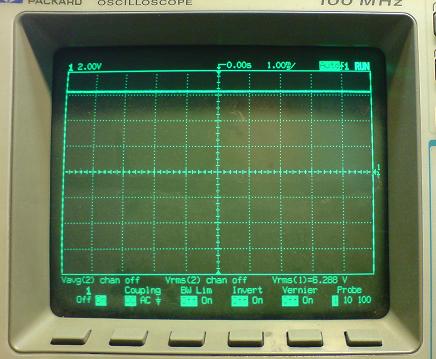

Filamets are inside of tube catode and cathode signal is good to have no noise in it. Filament is so close to cathode that noise can modulate actual video drive that cathode gets.
Also filament lines goes through VNBīs and near video OP-ampīs, so noise there can "jump" to video signal..

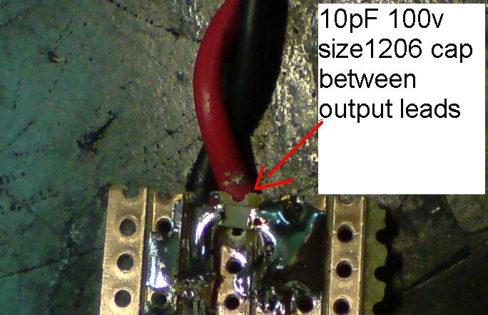

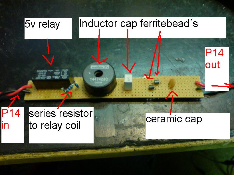

Here are some pictures from "proto" that i made just for this post.. It is ugly, but i made that one just for scope pictureīs + detais Embarassed
i have used similar filter +ovp on my marquee about 2 years with no problems and i made one to marquee owner here in Finland and he reportet that there was noticeably difference at dark parts of picture (unmoddet LVPS, old capīs ..)
On mine marquee there was smaller improvements (recapped LVPS+ VNB mods)
First part after relay (at + side) is inductor that is rated between 2-5 amp (low resistance for lowest voltage drop) itīs inductance can be between 47uH (micro henry)-100uH.
After that there is 1,5uF 50v plastic cap between + and gnd, after those there are two ferritebeas (one at+ line one at gnd line) after those 10nF cap and between outputleads there is small (size1206) smd cap 10pF
That 100uH+1.5uF part is quite effective to lower noise and those beadīs + 10nF+10pf are there just to take "residues" away
It is easy to connect-> just use proper connectorīs and put it between P14 connector and motherboard.
Edit/ part details: Inductor that i used -> http://fi.farnell.com/murata-power-solutions/1468362c/inductor-68uh-6-2a/dp/1077059?Ntt=1468362c
Relay (JQX68F)-> http://www.relcon.de/produkte/detail.php?produkteID=193
Ferrite bead-> manifacture: Kitagawa
Type: RI-3,5-4-1,2 30/51 Ω @ 25/100 MHz
Rest is pretty much basic stuff

Noise.. Look Vpp values
 Filesize:  54.36 KB
 Viewed:  14085 Time(s)
 Filesize:  52.78 KB
 Viewed:  14112 Time(s)
 Filesize:  76.78 KB

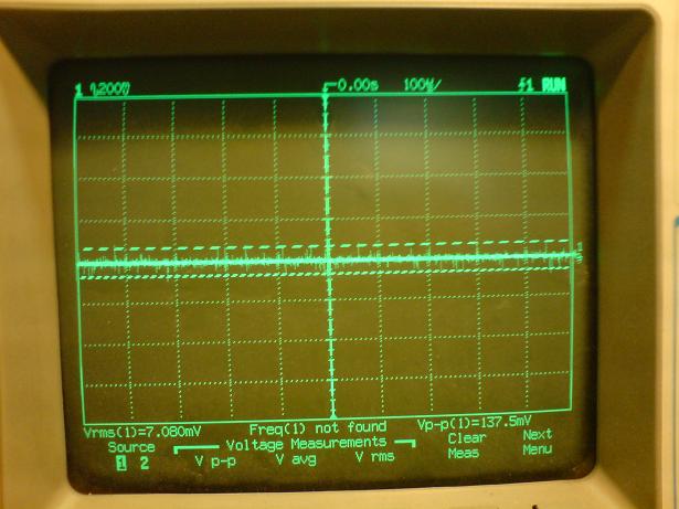

 Filesize:  47.35 KB
 Filesize:  46.25 KB
 Filesize:  43.43 KB

Nice jarmo, I was looking at the schematic, if you do not want the relay section for the filter can you just eliminate the resistor and the relay and just leave in the inductors ,caps and ferrite beads.?
1031
Posts: 657
Location: Finland
Posted: Tue Aug 25, 2009 4:48 pm    Post subject:
Yes. If there is no need for OVP just leave relay+ series resistor away.

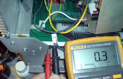

I forget to mention..
P14 adjust must done again (with filter in place) there is small voltage drop due resistance of inductor, so connect volt meter to p14 connector or to motherboard pins and adjust LVPS P14 trimmer and adjust P14 voltage back to 6.3Vdc

1031 wrote:
I forget to mention..P14 adjust must done again (with filter in place) there is small voltage drop due resistance of inductor, so connect volt meter to p14 connector or to motherboard pins and adjust LVPS P14 trimmer and adjust P14 voltage back to 6.3Vdc
this would probably make this a no-can-do for the average person. Also, for those people who did the P14 mod per this thread where you lock it in with a resistor it would make this difficult and require re-working that circuit.
Personally I don't like the fixed resistor method. What i've been doing is a smalle resistor + high quality trim-pot. It allows for exact 6.35 as opposed to like 6.2 or whatever the other method winds up as.

Voltage drop was about 50mV (if i remember correct, i check that later) So it is not big problem..
Yep. I used molex connectors so that there is no possibility to connect that filter circuit wrong.
About that LVPS p14mod. I have used also fixed resistor (475 ohm) + 50 ohm trimmer (475+20 ohm trimmer with some LVPS leaved voltage too low)
Edit: i measured voltage drop, it was 47mV

Looks like I was right about the PSU being noisy. Despite it being regulated(lm317 IIRC). I wonder how bad the rest of the rails are.
839.8mV P-P noise is a LOT!
Shielded cables for power might be a good idea.

Filaments take about 600mA. Noise is pretty bad there, most of "spikes" are near 100kHz and there are much more over that range too.

Posted: Tue Sep 01, 2009 5:31 pm    Post subject:
I still think its amazing how much noise you can clean up on this heater voltages:
Before Jarmos Filter
After the Filter Mod
WTS

Do you have a schematic of this filter? What does the Marquee use for regulation on the filaments?
There is the typical voltage regulator power supply and then a trim pot and a few resistors to adjust it to the 6.37 VDC needed, on shut down it stays at 3.xx VDC.
The relay section can be removed if you dont want it, jarmo added this to shut off the filament voltage if it goes over a certain value.
 Filesize:  22.16 KB
 Viewed:  13865 Time(s)
WTS
Posts: 1276
Location: Calgary
Posted: Wed Sep 02, 2009 2:10 am    Post subject:
Odd that the regulator puts out that much noise.
