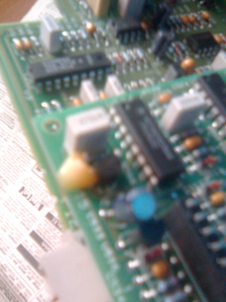

One thing I did notice when cleaning the ICs and connectors was a waxy glob on the HDM daughter board. (see attached bad photo). Is something like this normal - for example something that was added for taking the heat away?
waxy substance on HDM daughter board
 Filesize:  74.4 KB
 Viewed:  17060 Time(s)
Posted: Fri Aug 07, 2009 9:06 pm    Post subject:
Ralph thats Hot glue, There is a transistor there that sometimes moves and can break. So some boards have the hot glue to keep it in place. Some time they also use hot glue to stop resonances but not sure if this board is one that suffers from that. I'll look at my schematics for that piece IIRC it should be a transistor, maybe that part is part of the sync circuit? I'll post back when I look it up.

You should replace Q501, this is a 2N7000,
This transistor is one of the replacements when you have HDM problems.
It has nothing to do with sync, but it seems to fix many issues on the HDM-D.
The glue is to hold a resistor as it is soldered to the transistor then the board.
It has nothing to do with sync, it does vertical centering.
What VIM are you using?? 2005 or 2035??
