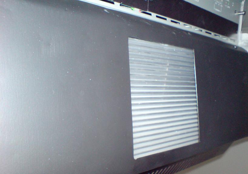

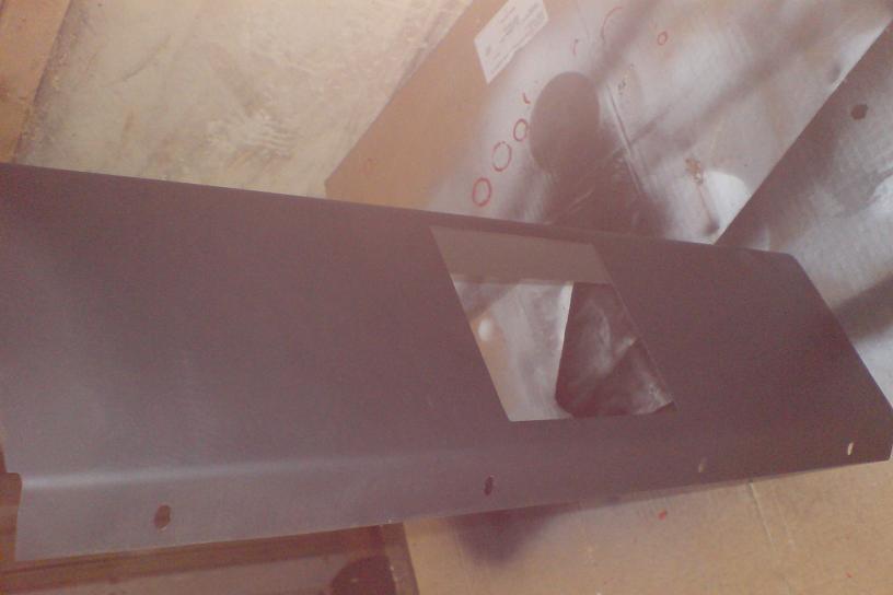

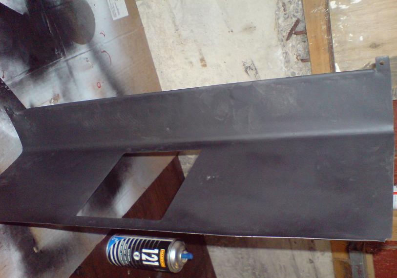

Posted: Tue Aug 04, 2009 6:41 am    Post subject: how to lower rear heatsink temperature about 8-10 celcius

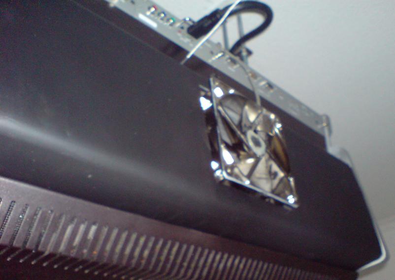

Hello. Here is latest mod. Marquees rear heatsink runs pretty hot and it gets itīs airflow from belly fans that push air inside of cabinet (trough FCM,HDM,tubes+VNBīs ) so air it that tryes to cool down rear heatsink is pretty much "pre heated" and also air flow is so low there that has not much "cooling power"
So i fabricated "copy" from rear heatsink cover ( yes i was feeling little bit like those sheet metal guys from American hot rod Laughing ) and made 120mm x 120mm hole for fan that pulls air out from cabinet + rear heatsink. Heatsink runs now about 8-10 celcius cooler and temperature inside of cabinet is also about 5 celcius lower.
Fan that i used was Silenx that doesend move much air and still that made great difference. Also that fan pushes hot air more forward so that air intake to VIM and CLM gets cooler air.

Nice Jarmo!!! Did you take the power for the fan from the two extra 24 volt fan pins on the back plane where the belly fans connect to or from somewhere else?
that's a pretty big improvement, nice job.
It's good to see someone actually imporving and adding air-flow Thumbs Up I found it troublesome that so many people actually slow the fans down, not a good idea when these machines run so hot anyway.

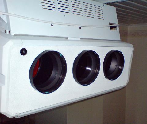

Yes, just few weeks back i fabricated new lens foam from 2" thick foam plastic from upholstery shop. I was quite easy to cut with really sharp kitchenknife. And after that i just spray painted foam with black paint... looks just as good as new original.
Here is picture from frieds M8000 that has hd-145 lenses and new foam

I have played with too many fan mods with this marquee Mad silenx, cheap computer fans etc...( ok for that rear heatsink those are ok) Now i have four 120mmx120mm Papst fans at belly, before there was three. That was SHOCK to me that with four belly fan airflow was smaller than with three fans Rolling Eyes and with four fans projector is quieter ( that is clear sing that there is less airflow)
marquee needs belly fans that can give pressure so air flow is really pushed to right places through those relative small holes that distribute airflow from fan chamber. It is sad that is not the most silent way to cool things down. So that idea from add fan that sucks air from rearheat sink came to my mind (that idea was talked previos here or some another crt forum, but i havent never hear that someone had done that. least way i did that, i know that HK-Steve has rearheat sink fans, but those doesen suck air from cabinet side)
Also recent CLM failure gived enough reason add air flow

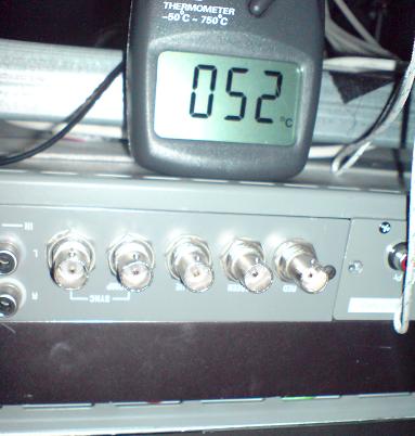

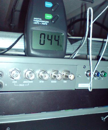

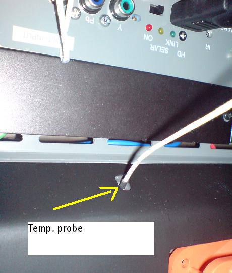

Here is few measurements, i tested with different fan this time-> Nexux d2sl-12 fan, that was much silent than SilenX.
With Silenx heatsink temp was 41 celsius and with Nexus it was 44 celcius.
I disconnected that rearheatsink fan and waited about 30 min, then heatsink was 52 celcius.

My latest magnet setup vent so nice that i doesent use static gonvergence more than few "clicks" so gonvergense stability is not problem. I haven looked critical how another areas (dynamic gonvergence) behave after that fan mod.
Hmm.. Should i made that rear fan temperature controlled Wink So that heatsink gets its operating temp fast and then fan gets more voltage to keep temp stable.
Hmm that be a good idea, get the fans to turn on at 39-42 Celsius to keep the temp there. Other wise it will fluctuate too much at the beginning or take too long to reach that temp.
But I think the three VNB's would benefit the most from running as cool as possible, make a single fan system with ducts to feed the VNBs fresh cool air from outside the case.
