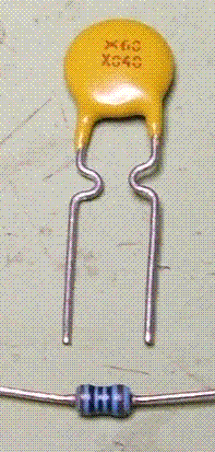

These are a neat alternative to fusible resistors. Polyswitch resettable fuses. If one "blows" you just turn off the power for a minute and the device resets itself. No resoldering resitors if you do a slip with the test probe or drop something in a bad place. Of course, if something is shorted, the "fuse" will just blow again when you turn on the power.
For 1 ohm resistors use RXEF075
For 2.2 ohm resistors use RXEF050
For 10 ohm resistors use RXEF020
For two 1 ohm resistors soldered in parallel use RXEF135
That should cover most of the resistor "fuses" used in the Marquee.
Attachment shows Marquee resistor "fuse" and RXE040 which is smaller than RXEF050 and a bit larger than RXEF020.
Scott
 Filesize:  19.29 KB
 Viewed:  29747 Time(s)
Thomas Jefferson

Thanks for the added info Scott, If one blows in the fusible spots I'll have some ready, looking for them on line and am going to order a few of various sizes.
PaulB
Joined: 26 Oct 2007
Posts: 359
Posted: Sun Sep 21, 2008 6:39 pm    Post subject:
Never heard of these before, what a great idea, thanks Scott Thumbs Up
Paul
Posted: Sun Sep 21, 2008 6:44 pm    Post subject:
I am still going to use the Koa's though , these resseting one are for back ups or for wehn i want to test aboard. i'll remove the fusible and add this ressiting one when i test.
Athnasios
