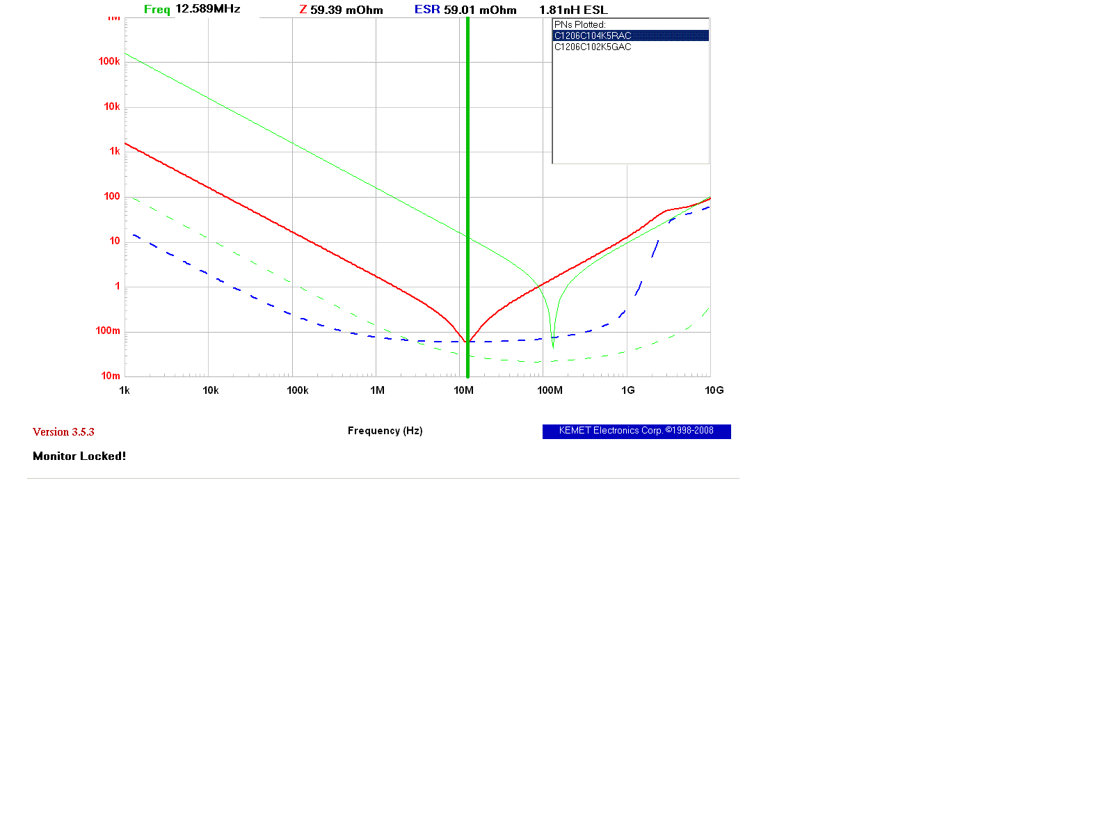

Caps are not always caps. There is a point where, as the frequency increases, the cap actually becomes an inductor.
Kemet has a neat software program that will plot the impedance vs frequency of some of their caps. It will even let you add series resistance/inductance (trace length). This is alot of fun to play with.
http://www.kemet.com/kemet/web/homepage/kechome.nsf/weben/kemsoft
Here are plots of 1206 size 100nF and 1nF caps. Notice the impedance of the 100nF begins to increase after 12MHz! The 1nF cap looks like a better decoupling cap up to 120MHz.

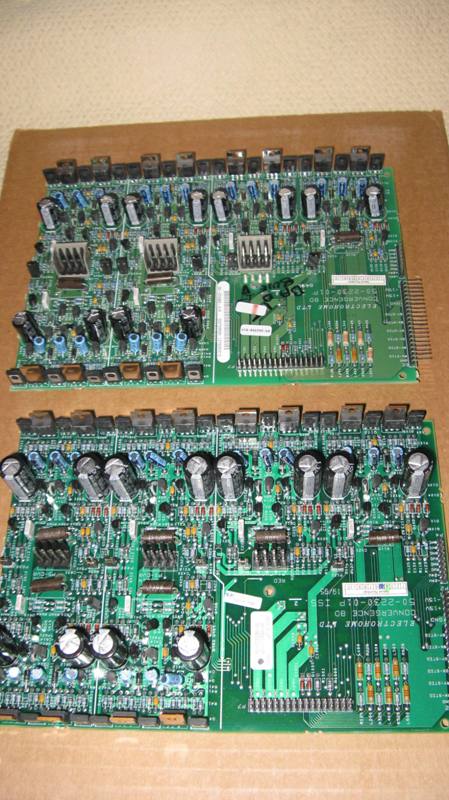

ok, so maybe the drifting and board failures are not related. It seems like there's been more failures lately of the transistors on the C board and it causes one of the 2 amps on each channel to fail. I assumed it was leaky caps contributing to this?
Anyway, here's a pic of the 95 vs. 96 boards, newer board in the back

Posted: Mon Sep 15, 2008 5:52 am    Post subject:
Interesting, I suppose they just lowered the the value (capacitance and voltage) of the parts to what they could get away with rather than what was actually needed. No different from a lot of other business companies I suppose.

Posted: Thu Sep 18, 2008 2:38 am    Post subject: Vertical Deflection Modual Resistor and capacitor upgrade
Next we are going to work on the two boards on the back heat sink the
Vertical Deflection module and the Convergence Amp. These are sometimes
connected together with a few bridges of the pcb material. The extra boards
I used for this installment were already cut so working on them was made
easier. If you want to make it easy you can do the same with a sharp blade.
One thing is its too hard to test these boards as we go so double check your
work as we will do it all at once then install.
here is pic of the two boards on the heat sink:
