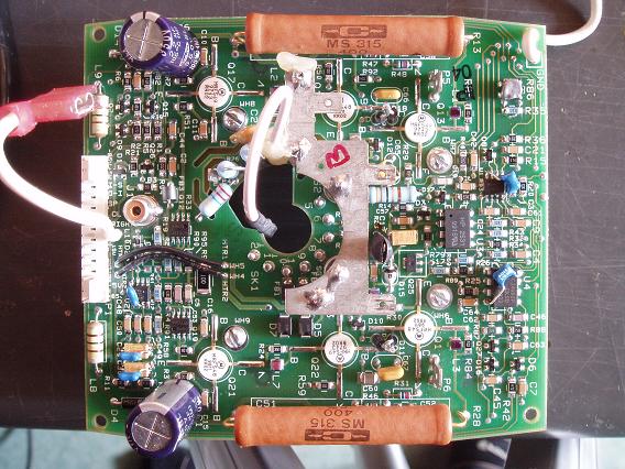

Posted: Sat Sep 06, 2008 3:22 pm    Post subject:
Did the first neck-board Wink
 Filesize:  80.02 KB
 Viewed:  18797 Time(s)

Posted: Sat Sep 06, 2008 5:43 pm    Post subject:
Nice work Arno ! Dont forget to get some of those 100pf silver mica caps for putting on C21,C46,And C2(also replace with a film cap of same value, like Wima) there may be some more changes comming to the neck board but i need some time to get back to them, just a few more cap change outs and maybe some inductors.

Posted: Sat Sep 06, 2008 6:46 pm    Post subject:
Well done Arno, welcome to the wonderful world of marquee modding!
This is probably more for Athanasios, I see you have caps across some of the chips in there - did I miss these somewhere, can't recall seeing them in the mod thread - worthwhile mod and if so, what are they?
Paul
Posted: Sat Sep 06, 2008 7:10 pm    Post subject:
hi Paul, McPherve mentions putting caps across the power supply pins on all the op amps in the marquee in the archives on AVS, he states "in case there doing something they not supose to" I have them on some and not on others(forgot) but i do not think they do much since the other decoupling caps have been doen on the supply rails, but you can use either 100nf(.1uf) or 100pf caps. i used the .1uf diped tants positive side to positive pin of chip, but i think film or ceramics might be better.

Posted: Sat Sep 06, 2008 9:53 pm    Post subject:
Paul, the decoupling of opamps is one of the most common things to do...(if any designer forgets them in a high bandwidth circuit...he should be kicked Smile Wink )....they are standard 100nF foil caps....just have to be fast enough for spikes/HF....and above all...as close as possible to the opamp supply pins (and on top of it is as close as it gets)....on the board adds tracks in the paths which are basically coils (approx. 1nH/mm) causing a degrade of the decoupling function of the capacitor..

Posted: Sat Sep 06, 2008 9:59 pm    Post subject:
Right you are Arno, So you think the 100pf are to small a value or are for too high a frequency.

Posted: Sat Sep 06, 2008 10:03 pm    Post subject:
Yes, most circuitboards (digital) have 22..47 or 100nF
100pF reminds me more of taming feedbackloops of opamps (or matching phono-input capacitances)
100nF in parallel with an electrolyt capacitor....would make sense if the bigger C is no larger than 10x that value (so I recall from someone who measured this for use in loudspeaker filters).

Posted: Sat Sep 06, 2008 10:07 pm    Post subject:
Right, McPherve actually used the large value cap,a 100nf cap and the 100pf on the supply rails. So this aproach mayb asl used on the pins too? or the 100nf would be enough and the rest is over kill since the rails have this already?

Posted: Sun Sep 07, 2008 6:18 am    Post subject:
The rails should be ok, only the local IC decoupling is an improvement to compensate when the buffering (capacitors) that are further away from it see a too long path when a spike/glitch/edge occurs....that's when the small locals catch up..
Since the opamps got their power supply rejection ratio I wouldn't mind to much about what needs to be done on the rails...but...for the transistors "touching" the bare suplly voltage there could only be a problem when there's a differential mode disturbance on the voltage rail (one side) since the common mode disturbances (+85V and -85V suffer the same voltage dips etc) should be covered by the balanced design (and the relatively high voltage on which small surges will have less influence)
Looks more as a regular power-amp design (with all respect for the HF handling capabilities they had to take care of) and in such a design you will see very stable ps filtering in the front stages and basic stabilisation in the power section.

Posted: Sun Sep 07, 2008 6:22 am    Post subject:
By the way...be careful with adding series inductors in the power lines....if the value is small it will help the filtering since it is a second order now together with the C .
BUT...this approach although very nice for tube amplifiers and HF circuits..can have a secondary negative effect of oscillation between the C and the L....trigger such LC circuit it could start to bounc quite a time

Posted: Sun Sep 07, 2008 10:32 am    Post subject:
So as long as the inductor has a very very low DCR it should be ok?

Posted: Sun Sep 07, 2008 11:40 am    Post subject:
Nope...
If it would be an "ideal" inductor of zero ohms....the oscillation is best.....
In case it does have a DCR....there is another disadvantage of the voltage drop
If oscillation is no issue....calculate the f3 of the filtering (L/C) and base the selection of the inductor on that
And another nice thing that could happen.....EM-signal injection (of any HF source around) on a coil in an antenna function
(My choice....leave the inductors out of it and keep the original design)
F = 1/(2*PI()*SQRT(L*C))
