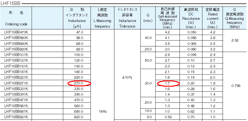

Posted: Sun Mar 16, 2008 1:15 am    Post subject:
Bigger value with inductors doesn't always mean better filter action. Every inductor also has capacitance between the windings that resonates with the inductance. These two values create what is called the Self Resonant Frequency or SRF. Frequencies higher than the SRF tend to bypass the inductor by travelling through the capacitance. So, if the freqency that you are trying to filter is 10 or 20MHz and the SRF of the inductor is 1.7MHz alot of the noise will not be reduced. Sometimes a smaller value with a higher SRF will work better. It all depends on what you are trying to filter.
Ferrite beads are usually spec'ed at 100MHz and present little impedance at lower frequencies. Once again it depends on what you are trying to filter.
Scott

Posted: Sun Mar 16, 2008 1:37 am    Post subject:
Thanks Scott, this is why i need to get a scope! I was actually reading up on what values of inductors filter out what frequencies, and trying to grasp this whole concept of noise reduction/filtering. I was reading also that the de coupling capacitor in the circuit that inductor is on, also dictates what value you should use as not to increase that self resonant frequency. I still need to study this more, also thanks for you added input! we definitely could use some more guidance on this thread Wink
this is what i was reading and have sort of grasped a little about de coupling and inductors.
http://www.williamson-labs.com/480_xmis.htm
Still looking up more....
