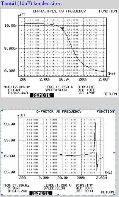

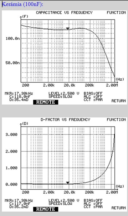

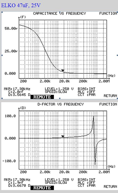

At the university we measured some caps with a professional Wayne-Kerr component analyser, that could measure up to 3MHz. Unfortunately the caps didn't have the same capacitance rating, yet it is obvious how they are related.
The upper diagrams shows the effective capacitance vs. frequency, the lower shows where is the resonant point of the cap, after the resonant point the cap behaves more like an inductor instead of a capacitor.
You can speed up a capacitor if you connect with them parallel faster ones, so for example if you connect parallel an 1uF foil cap and a 100-200nF ceremic cap with a standard 470uF electrolytic cap, it can make wonders, and cheaper than buying individual magic caps.

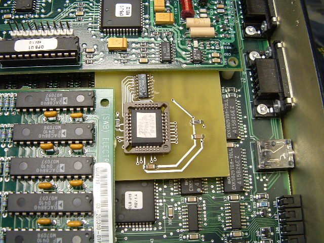

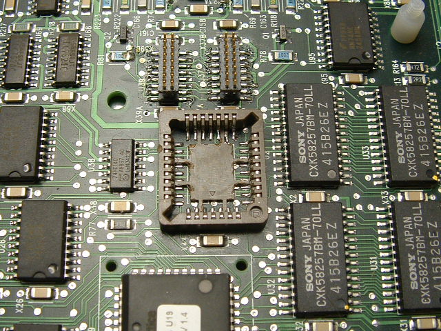

Well I came up with a better method to do this mod. the one earlier in the post takes a long time. Then i tried another way but that also did not optimally end well. had some issues due to connection problems etc.It was causing a LVPS short but on the 24 volt line!! No 24 volt line on CLM so the signals to the CVA must be crossing on that mod. But this last method seems the best but one issue is the Upside down socket I used pops off. I can try to solder it to the chip under it but that can cause some short between pins. It may have to be hot glued down. I only did a rough convergence on my not set up well test PJ in my shop, no scheimfluge , corner focus, astir and greyscale etc. its just my PJ i test stuff in case I blow up something I won't care Wink
Here are some pics.
First some beer… Very Happy
What I did was bend out the clips not used and cut them off. Then
I soldered the programed banding Chip to the upside down Socket.
Here you can see the socket upside down on the board chip with the new chip on top.
I had to cut out the angled corner to get it to fit. I might leave the angle and just force it on next time to hold the socket onto the existing board chip.
And the rough convergence. There was no banding. With this method I won't be afraid to try it on one of my Longbows.

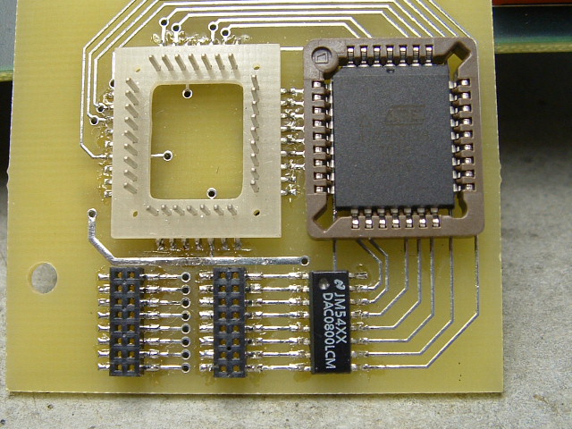

Got the Boards back! Now when I find some time I'll have to see if they fit correctly.
Other wise I'll have to make adjustments to my original design and have another set made.
Lining up the parts so they fit over the top of the existing
parts is a challenge . I hope I got it right the first time.
On the one set with out the cap pads I forgot a via for the power pin on the DAC0800, but
I can jump a fly wire to it.
Hopefully in the next few days I can get to this and see how they work.
Posted: Tue Jan 21, 2014 7:10 pm    Post subject:
Had to try a mock up!!!
From what I can see underneath I think I lined up the DAC pads pretty well. The cool thing
is on the other side the pads for the socket are much longer than the DAC pads you see on top.
So there is wiggle room to place the socket side to side, but if the pads are not lined up the long way
then I'll have to make another attempt. I few tenths of a mm I might be able to
make it fit.
On the next board I will try to angle some of the traces and also
add a mounting hole in the same location of the existing one on the CLM and the
SWB. Then the board will be kept in place with the screw to stand offs.
