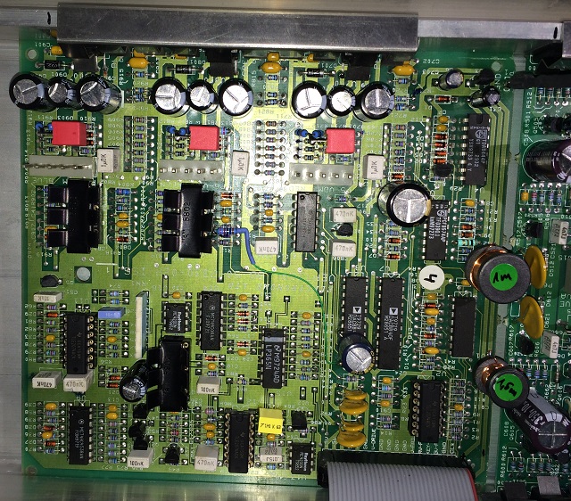

You Need to translate the BR909's methods to the Marquee in this case. In the BR909 there's one supply line (+12V) feeding the vertical amplifiers. This one gets filtered with a low frequency Network (1mH = 1000µH plus a 4700µF electrolytic cap). On the Marquee You have a split supply (+15V and -15V) feeding the amps. Therefore You need to add two inductors (1mH to 1.5mH for each rail). Fortunately there's enough space for it (see picture). I took two that I scrapped from dead power supplys. The ones You mention have an inductance which is too low.
Also did you change the 1n4003 diodes to the soft recovery ones I listed?
No. That wouldn't improve anything. Diodes D701, D801 and D901 should be left as they are. They decouple the booster section of the amplifiers (artificial boosting of the power supply) and the STV9379 Datasheet doesn't Point out any Special requirements for those.
Wish they went higher in voltage and values. I have used Tants of 6.3 volts on the 5 volt rails with no issues, so I wonder how these would fare? on the 15 volt rails i would not try 16 volt one but the 20vdc ones. Not sure what surge voltages those rails can produce but 6.3 volts can take a surge up to 7.2 vdc.
I would always maintain a security margin of 40-50% (e.g. 10V for 5V lines, 16V for 10V lines, 25V for 15V lines etc). For Tants I would maybe go even higher as their margin between rated voltage and smoke signs is smaller than for other caps.

Posted: Wed Oct 30, 2013 10:21 pm    Post subject:
I understand about the 15 volt rails and the 1mH, but for the 5 volt rails you list 150uH so would the 220uH ones I have that measure about 180-190uH work for those rails?
Ok so the film SMD caps would be fine for the 5 volt rails for the chip decoupling caps .
Now what about those PosCon caps they are more like OsCons than tants. And since i put hundreds of hours with the 6.3 volt tants
on another CLM i had with no issues I still wonder if these new style caps would hold up better than tants.
I guess I could try and find out Wink
And are those Shields over those ic's?

I also noticed you used sockets for the op amps, did that affect the operation at all?
Nope. Everything works fine. I used high quality sockets.
What You call shields are heat sinks (clips).
The inductors would work fine for the +/-5V rails.
With the PosCons You really will have to try them...

I too mike was looking at the smaller SMD inductors. I see you added them at each Channel. Think that might be overkill or is it necessary?
Also those Black 33uf tants, look like 16 volts correct?
Posted: Thu Oct 31, 2013 12:42 pm    Post subject:
The use of the inductors was very necessary to decrease the high frequency noise from getting into the vert, CVA and Stig amps and vice versa.
There is a ton of noise on the rails, some get's there directly from some of the modules, so in better decoupling the modules, I was able to lower the overall noise on the rails. With the bigger benefit being better performing boards (vert,stig, cva) on the large heatsink, because the high frequency noise that rides on the rails also gets into those amplifiers, and they actually amplify some of it.
I'll take a picture inside of one of my CRT's later (need batteries for my camera) and you'll see why those inductors are needed. Without them, I would not be able to get those super small and tight one pixel lines at the 1920X1440 /60hz resolution (234mhz).
At the higher scan rates, the cleaner the DC is on the amplifiers, the more defined the image will be.
Actually, the noise that is solved from when I put the jumper on the convergence board to ground, is to help suppress the noise that is being transmitted (onto their cables and back onto the rails) by those amplifiers. So with the inductors in place, there's no need for the jumper. Plus with the amplifiers not transmitting that noise anymore, the amplifiers run cooler and there's less noise is in the image.
Yes, the tants are 33uf/16v
