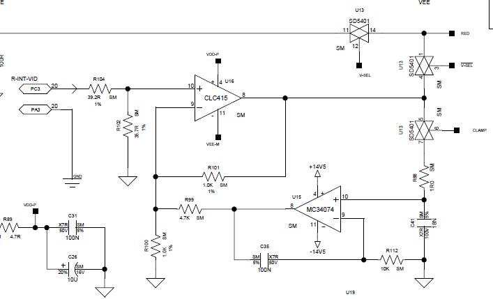

I did some research on the MACH111 CPLD (U106). What we would need here would be an easy option for shutting down its outputs without creating problems elsewhere. As with most logic devices I would look for some chip enable (CE) or output enable (OE) pins providing the desired function, BUT: The MACH111 doesn't have any! In fact it is capable of shutting off its outputs but it has to be programmed in order to do so. It would require programming an input line to the output controls but the current programming doesn't have that.
I tried out what the input at pin 10 (I0) would do if it was pulled to ground but the effect was a completely black picture and so I left it untouched.
Taking away the power from U106 (at pins 22 & 44) doesn't seem to be a good solution either.
Next thing I'd try would be replacing U104 (74AC05, Hex Inverter) with an 74F366 (Hex Inverter with Output Enable) and see what happens if the outputs are switched off. I'd have to check what side effects could happen as three of the six inverters are being used for video output and the other three are controlling a grey scale DAC...

The line (or distortion) in the image is coming from Pin 27 of U106. It is the switching control feed into the VIM that switches the video signal from the Internal Pattern Generator to the EXTernal source (Moome/BNC's).
On that same control line, they also impose some OSD display directly into the video chain thru the SD5401's, like Contrast, Bright, etc. that is completely separate from the individual RGB generator feeds into the VIM for convergence, etc.

Why not remove the Internal video on the vim by removing power from the Internal Video op amp on the Vim or by adding a switch to the Int-Vid for each color right at the connector?
 Filesize:  30.69 KB
 Viewed:  10630 Time(s)
Posted: Thu Feb 21, 2013 6:23 pm    Post subject:
The place of insert into the video chain is through V-Sel on SD5401. They're using the same pin on the SD5401 that switches the signal from INT/EXT as also an insert of the OSD.
The CLC415 is not involved.
Posted: Thu Feb 21, 2013 6:33 pm    Post subject:
The way i look at it is the internal video goes in on Pin 4 of U13, in my snap shot, then V-SEl switches it in and out when needed. So if you cut it out before it gets to U13 then the noise would also get cut off.
