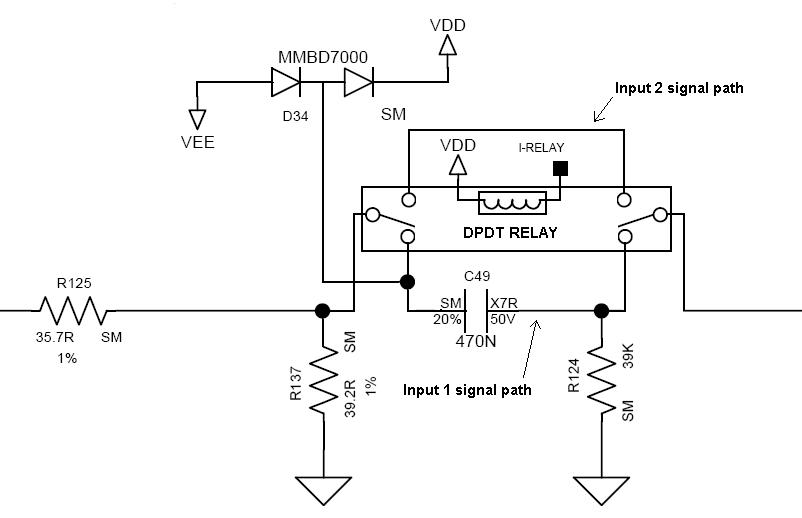

Well I am no EE nor am I a tech with years of experience, but I have been doing a lot of reading since I got my Marquee. I have spent a lot of time reading old maintenance and mod threads here and over at the other site. When I read some old post about AC coupling vs. DC coupling, they made prefect since about the dangers of DC coupling with external sources. Then for some reason a little light bulb went off in my head. It dawned on me that if you were using a Moome VIM-HD internal card, that the output of the card would be DC referenced to the rest of the projector, since it is using the DC supply from the projector. From what I have read you can DC couple from a DAC to the opamps as long as they are in the same device and using the same DC and ground reference. I could be totally wrong but I thought I would throw out the idea and see what people say.
You could just take out the capacitor and resister and jumper it all but then you could never use the RGBHV input 1 again, but if you never plan on using any thing but the VIM-HD input 2, it would be quite easy. Then I thought about using a DPDT relay to switch the capacitor and resister in and out of the signal path based on input 1 vs. input 2, you could use the I-RELAY signal to trigger it. I am really in way over my head with this stuff, but it just seemed pretty simple (on paper). Finding room for the relay and the right relay would be the hardest part. Here is a quick schematic I did to show what I was thinking about (based on green video chain).
Feel free to tell me, I have no idea what I am talking about and all the reasons this is a bad idea.

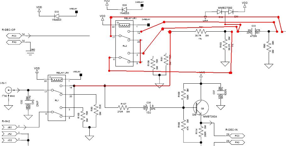

Looking at the schematics is it possible to use the relay already on the board. we could use the unused part of relay RL2 that the decoder board uses. route the input 2 signal that comes from JB2 into Relay RL1 into pin 6 which then goes out from pin 9 to RL2 pin 6 but instead we reroute it to pin 17 on RL2 . Then from RL2 we would route the BNC signal which would come out of pin9 to the de coupling cap C33 the normal way and then by pas that cap for the signal comming out of pin 14 directly to the op amp.?
Does this make sense?
this is all with the red channel:
So JB2>pin 6 of RL1 >pin 9 of RL1>pin 17 of RL2> pin 14 of RL2 directly to op amp.
or some variation of that mabe have the input 2 signal totaly by pass the first relay and go directly to pin 17 on RL2?

Posted: Fri Mar 07, 2008 2:34 pm    Post subject:
Yes if you never want to use input 1 ever agian. But if you still wanted the functioality of input 1 for hooking up test pattern generators and just having it incase for some reason the moome card faults you would have input 1 to test if the vim is good or if its the moome. I gues we could always just add jumper pins in strategic locations to enable input 1 again. Also couldnt we just go from the start of the signal before R125 to the op amp?

R125 & R137 form the 75ohm termination, so they need to stay in. I thought about using RL2 but it is physically a long ways away and the traces are all under it. You would have to remove it to get to the traces. But here is how it could be used.

Posted: Fri Mar 07, 2008 3:11 pm    Post subject:
But that way still allows input 1 to by pass the 470nf cap. Ohh ...does realy RL1 control RL2 so when RL1 switches it would also switch RL2? it just seems alot more reworking the path than my idea
yours
Mine
But not sure if it will work either...the easiest is to just eliminate input 1 and Jarmo's idea also could work as well. wonder if moomes black level is 0, i think i read somewhere it is.

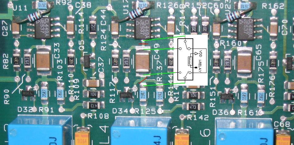

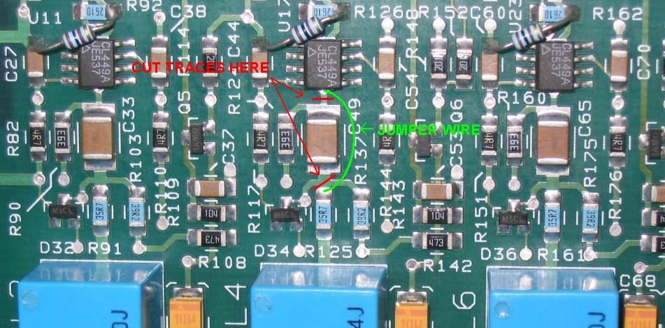

OK here is a pick of the board with how a new relay would work
 Filesize:  111.91 KB
 Viewed:  15046 Time(s)
Posted: Fri Mar 07, 2008 3:56 pm    Post subject:
Yeah that looks like the best solution. I'm going to put a jumper in and remove the cap but not cut the traces and see how it looks.
