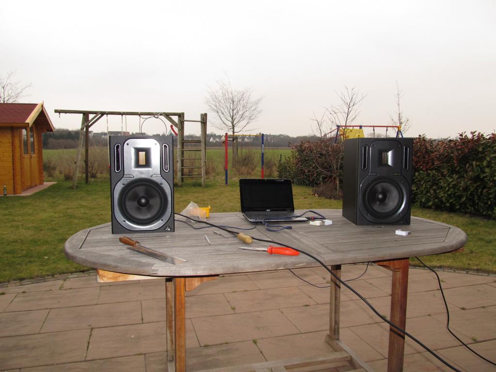

Posted: Mon Mar 05, 2012 1:54 pm    Post subject:

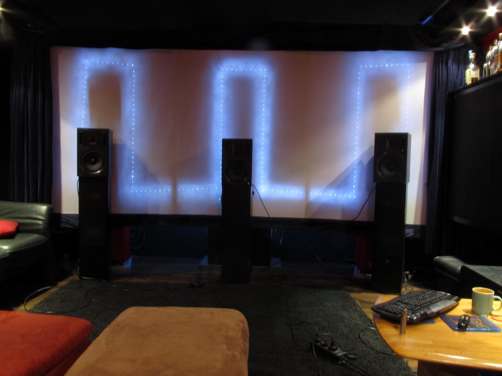

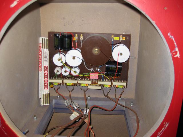

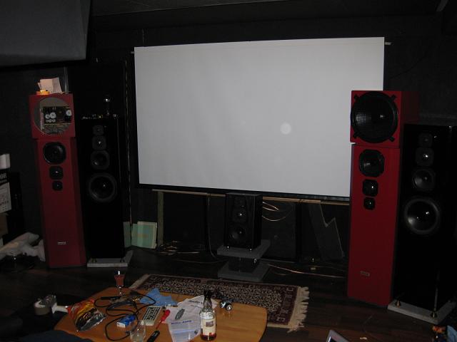

Just wanted to post some pictures of my front speakers before going to the next change. These are the Atlas DSM MKII, DIY speakers of the german supplier Visaton. Currently they are placed behint the AT screen and the WS21bf Chassis has been replaced by the GF200 to make an Atlas DSM MKIII. Those speakers from the 90ies were given the nick name teleohone booth. The are 4 way and have an internal bass driver to prevent standing sonic waves inside of the box.

Posted: Mon Mar 05, 2012 3:41 pm    Post subject:
Nice, what are those speakers off to the side in the last pic?

Posted: Mon Mar 05, 2012 6:51 pm    Post subject:
the black ones are Visaton Atlas Compact, also 4 way but bass driver is one 12" instead of a 10" plus 15" on the big red ones. crossover at 140 HZ

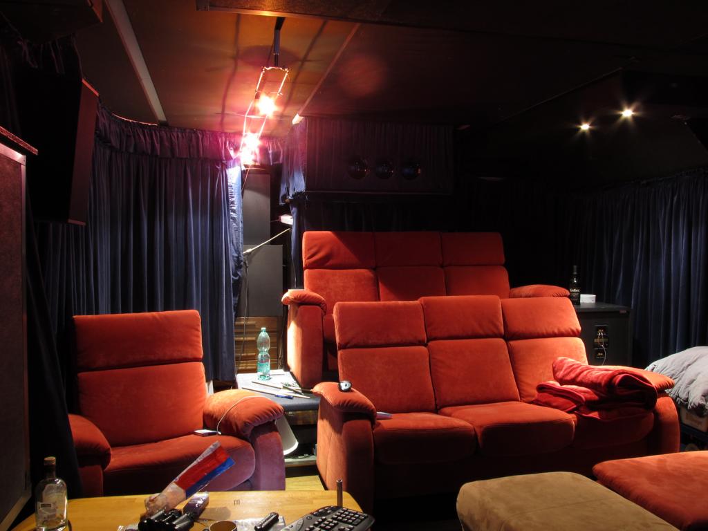

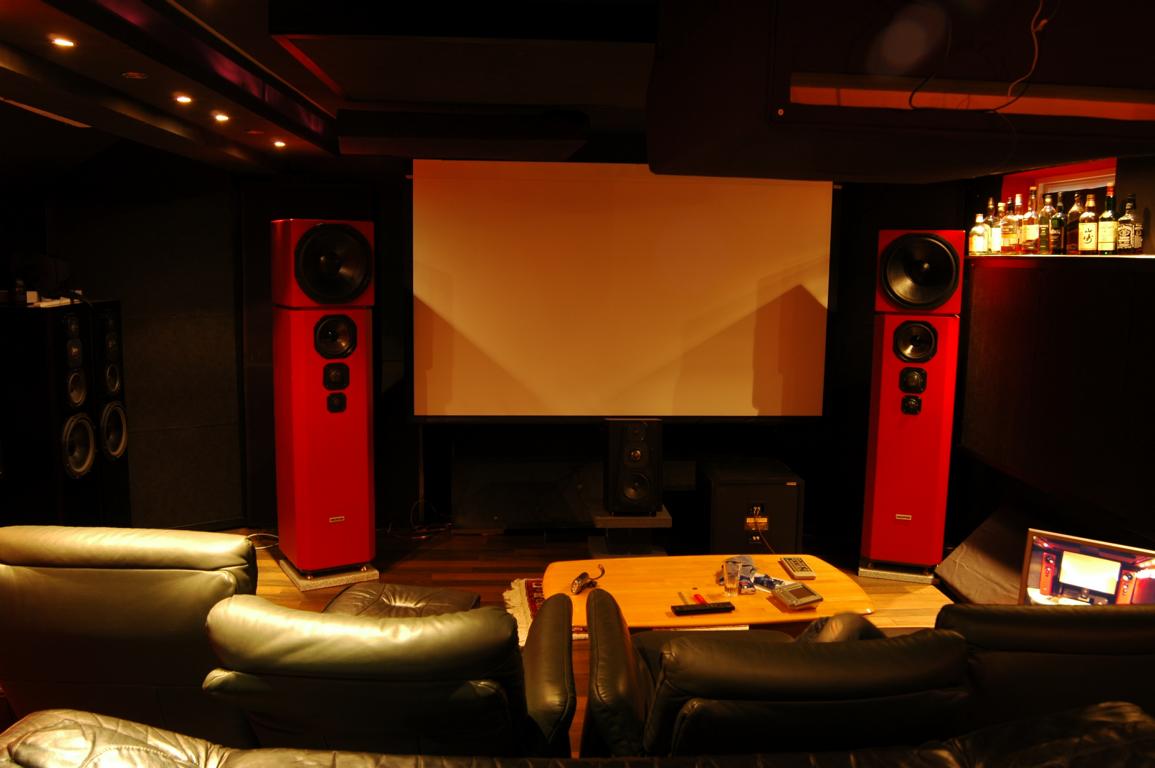

Posted: Tue May 08, 2012 8:49 am    Post subject: Digital Revolution
Digital Revolution Mr. Green

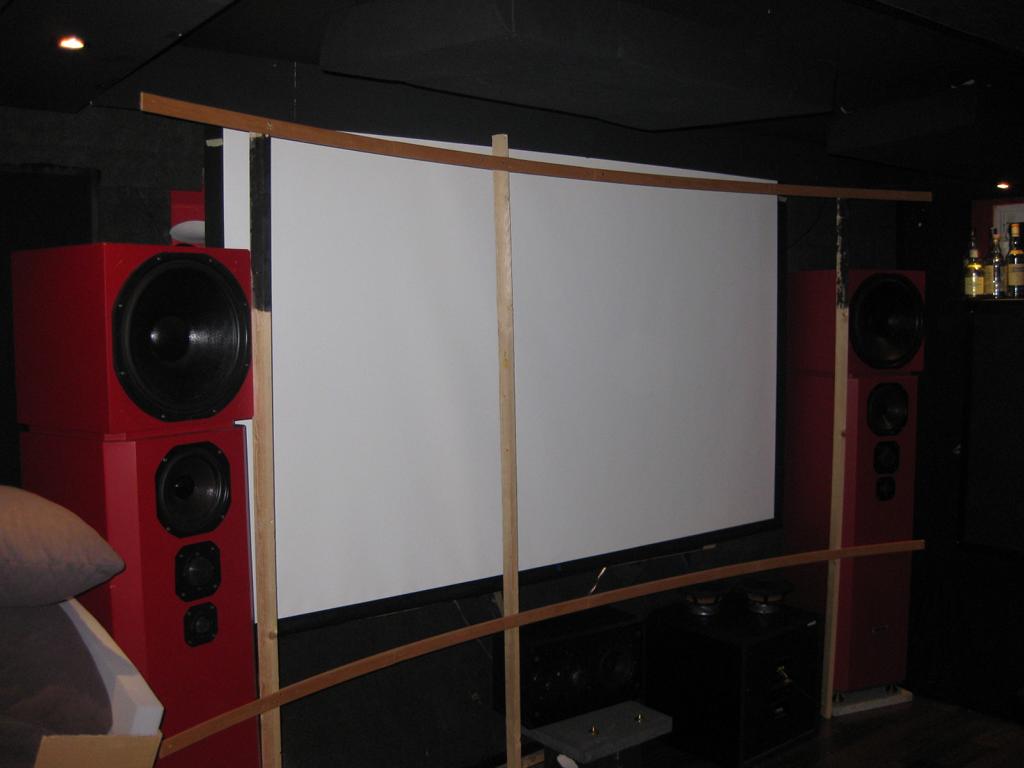

Okay, it's not that bad. Just switched from VGA to HDMI output for Audio and Video. BUt that was only a spin off of the real revolution
active front speakers
For movie soundtracks the Behringer Truth B3031A are really a step up in quality at only a 10th of cost. Looks like David vs. Goliath but guess who won. Not really usable for stereo though. Such a shame the big amps and front speaker had to go. Since the power amp is no longer a limiting factor I decided to go for a more modern and much cheaper HDMI AVR and finally get rid of the HTPC soundcard. Currently experimenting with a Denon AVR-2309 but not yet sure this will stay.

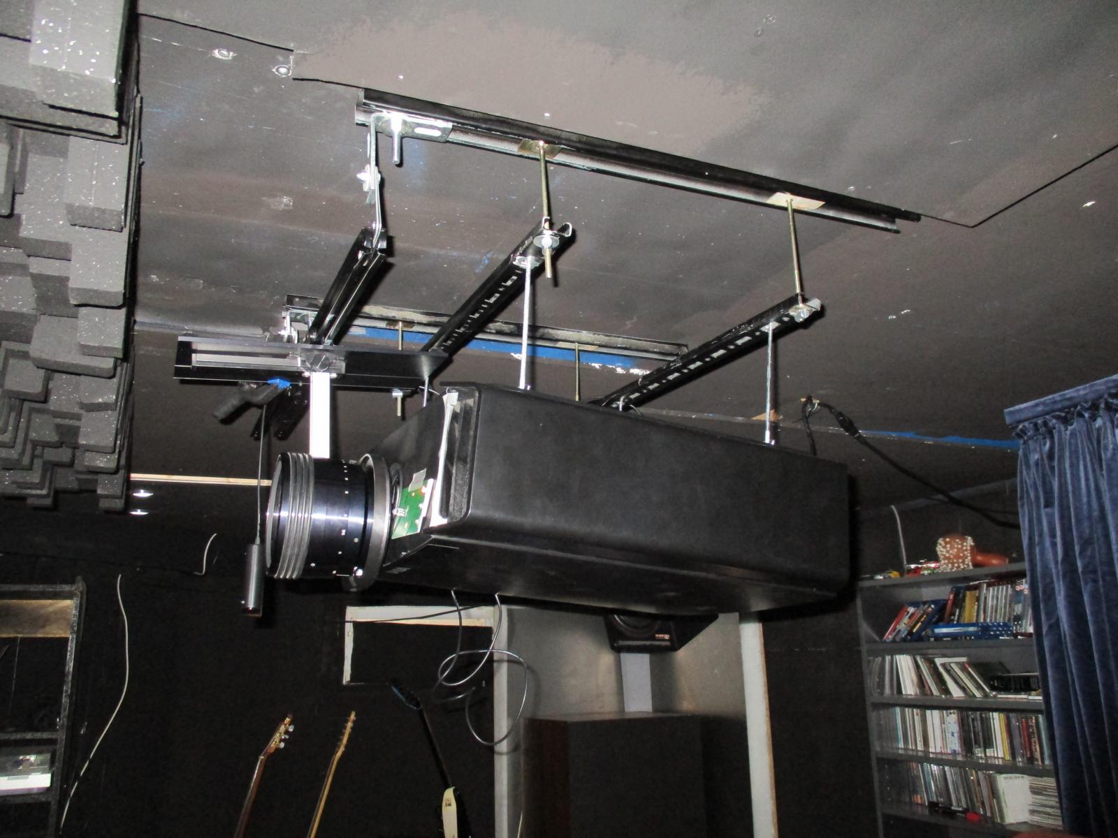

Yesterday I tried To change the HD10 lenses for GT17 and almost dropped the projector. Hope it will be worth the work.
Still to come is a serious subwoofer setup. A DCX2496 digital x-over and 5 speakers are waiting to be installed.
CHeers

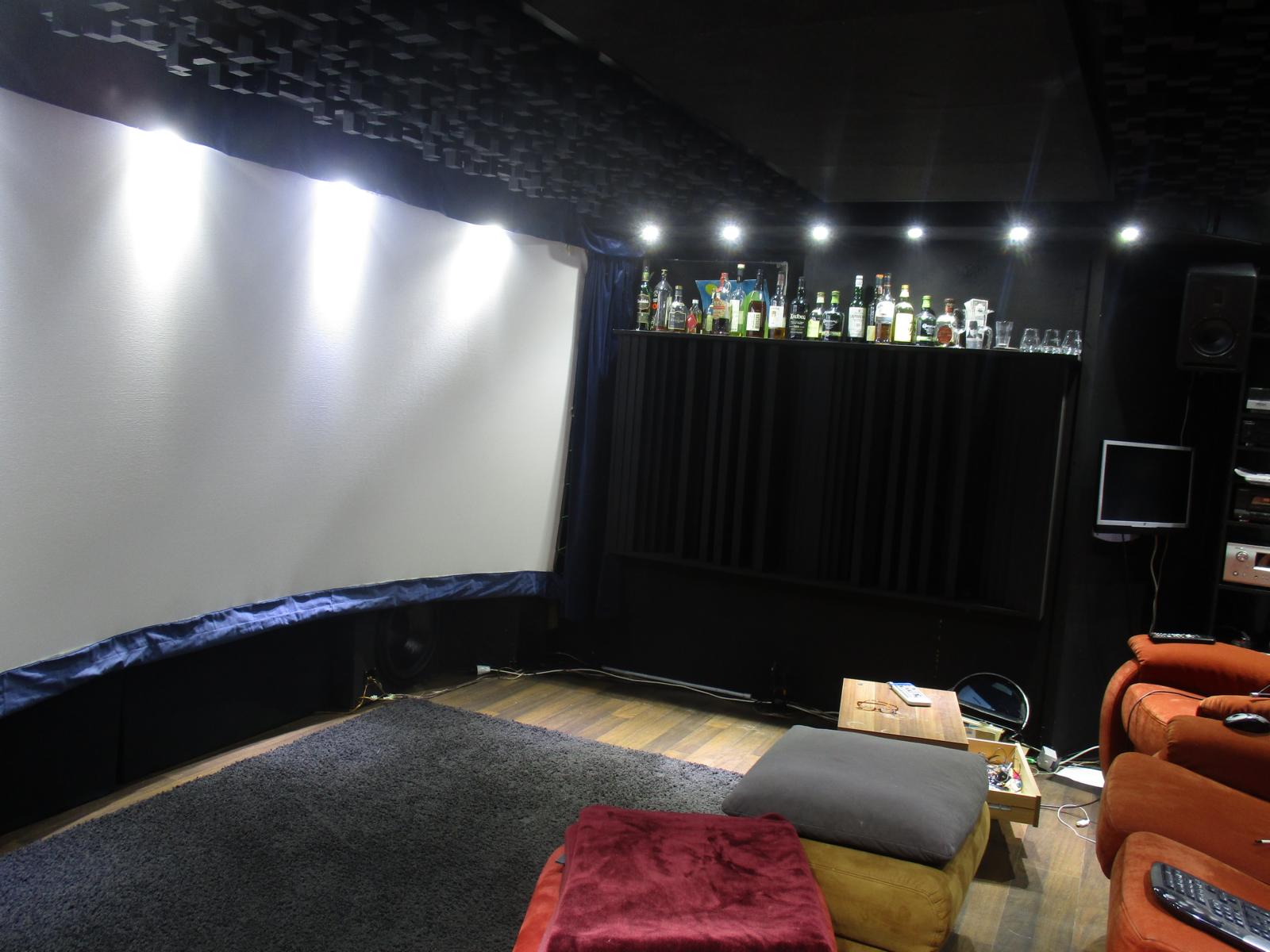

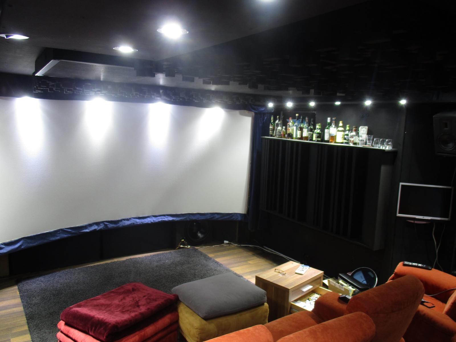

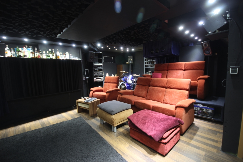

Posted: Wed Aug 19, 2015 12:24 pm    Post subject:

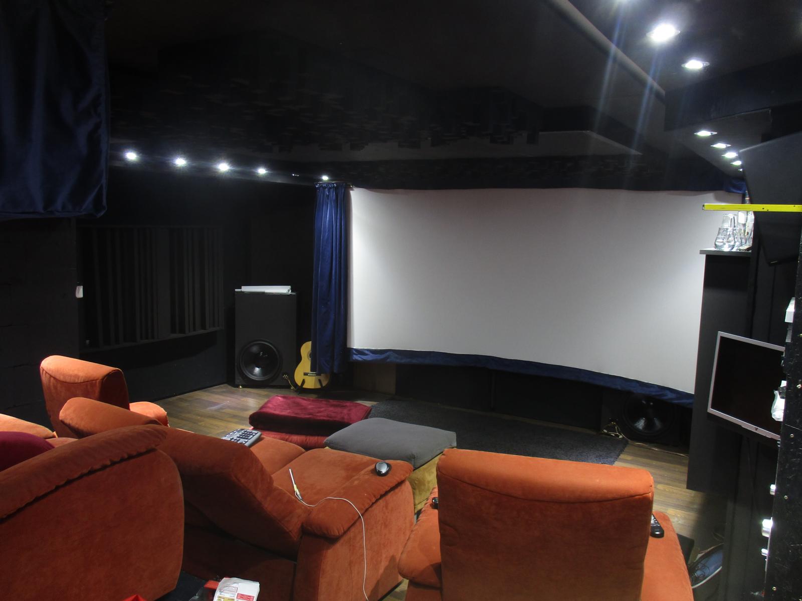

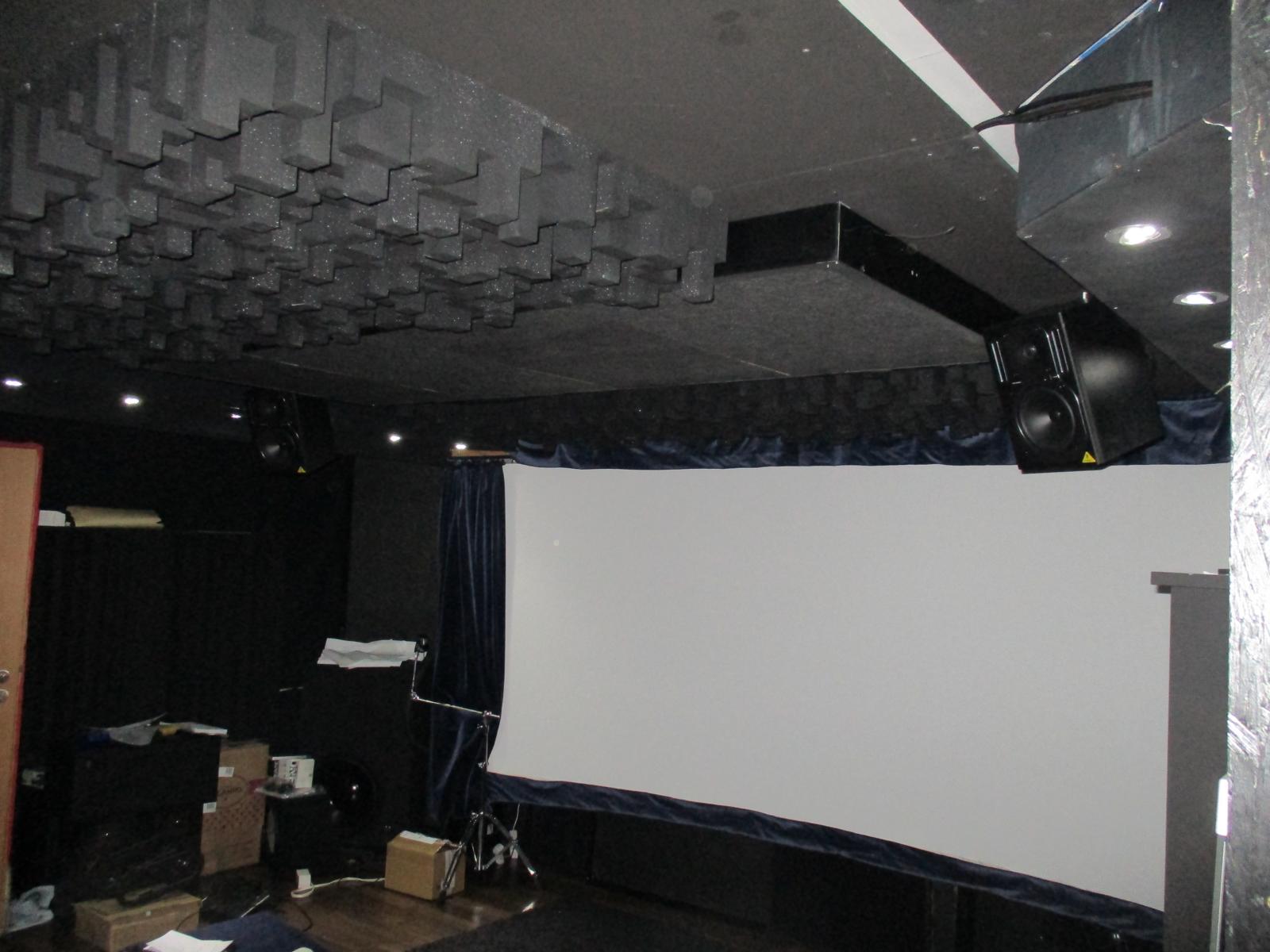

Time for another update. Lots of changes in room acoustics and speakers.
The room really had to much damping so we removed all the curtains and plasterboard panels. Also a lot of the mineral fibre absorber had to go. Early reflections are now scatterd by DIY diffusors built from styrofoam board. There are 2D PRD panels on the ceiling and 1D QRDs on the side walls. The room now sounds much more comfortable.

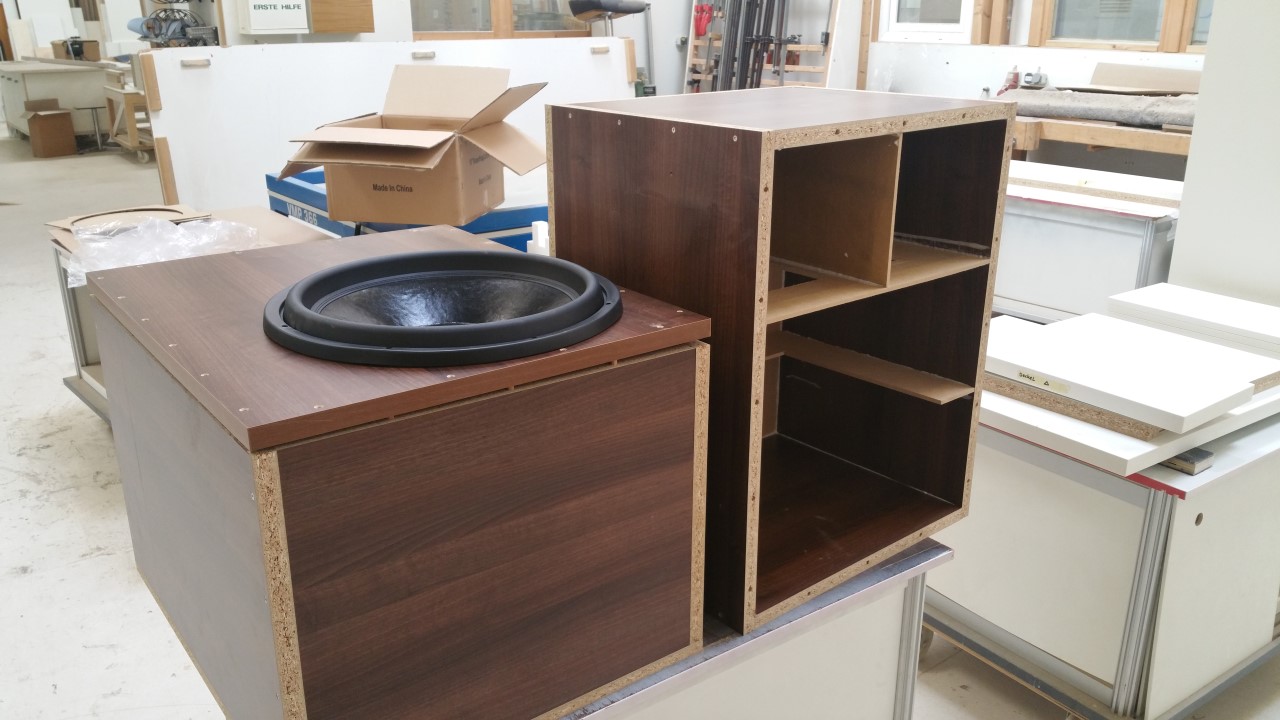

Speakers are now studio monitors all around with Mackie HR824 in the front and surrounds from Samson Rubicon 6a and Behringer B3031A.
My personal highlight are the subwoofers. 4 pcs of a custom 18" driver in 160 l closed box powerd by a Behringer INuke NU6000DSP amp. Later on I might post some measurements, those speakers literally kick ass.

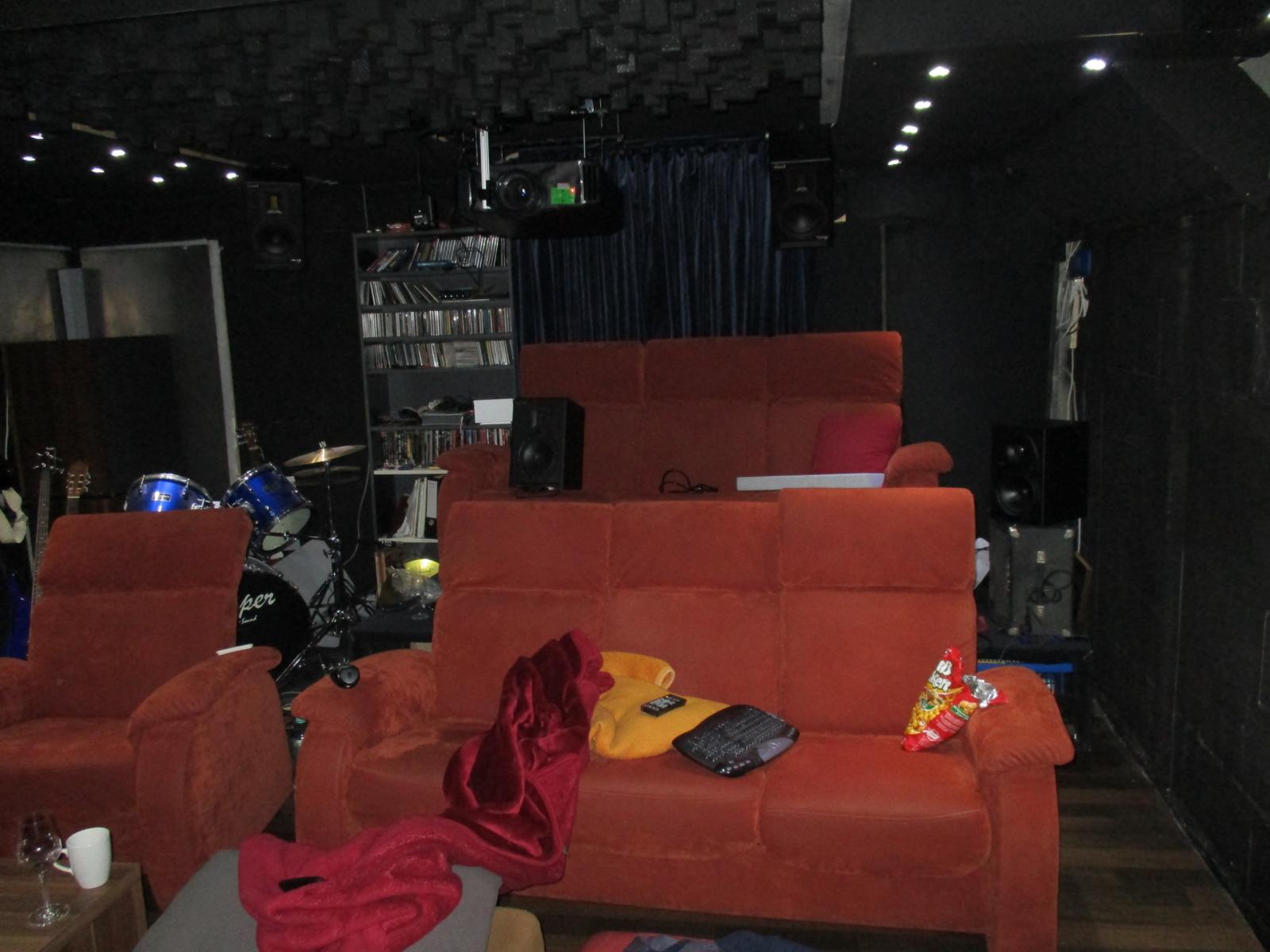

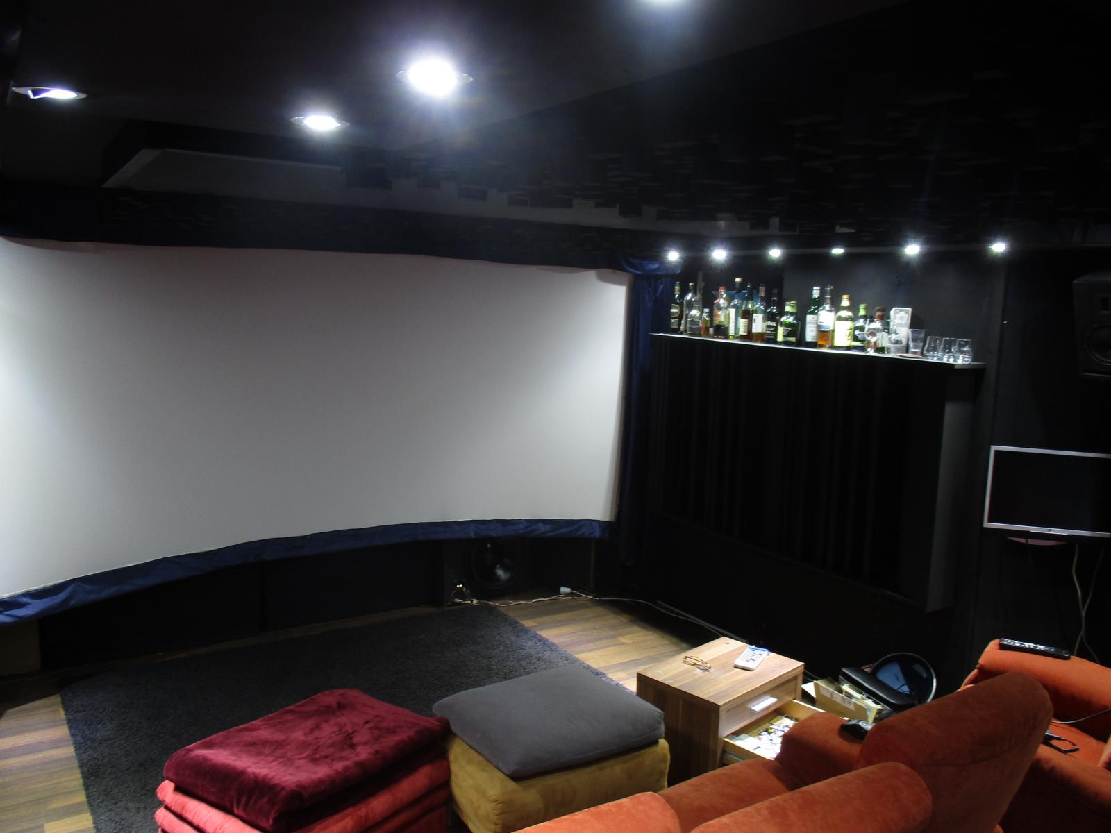

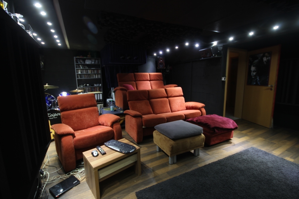

Posted: Fri Sep 11, 2015 8:47 am    Post subject:

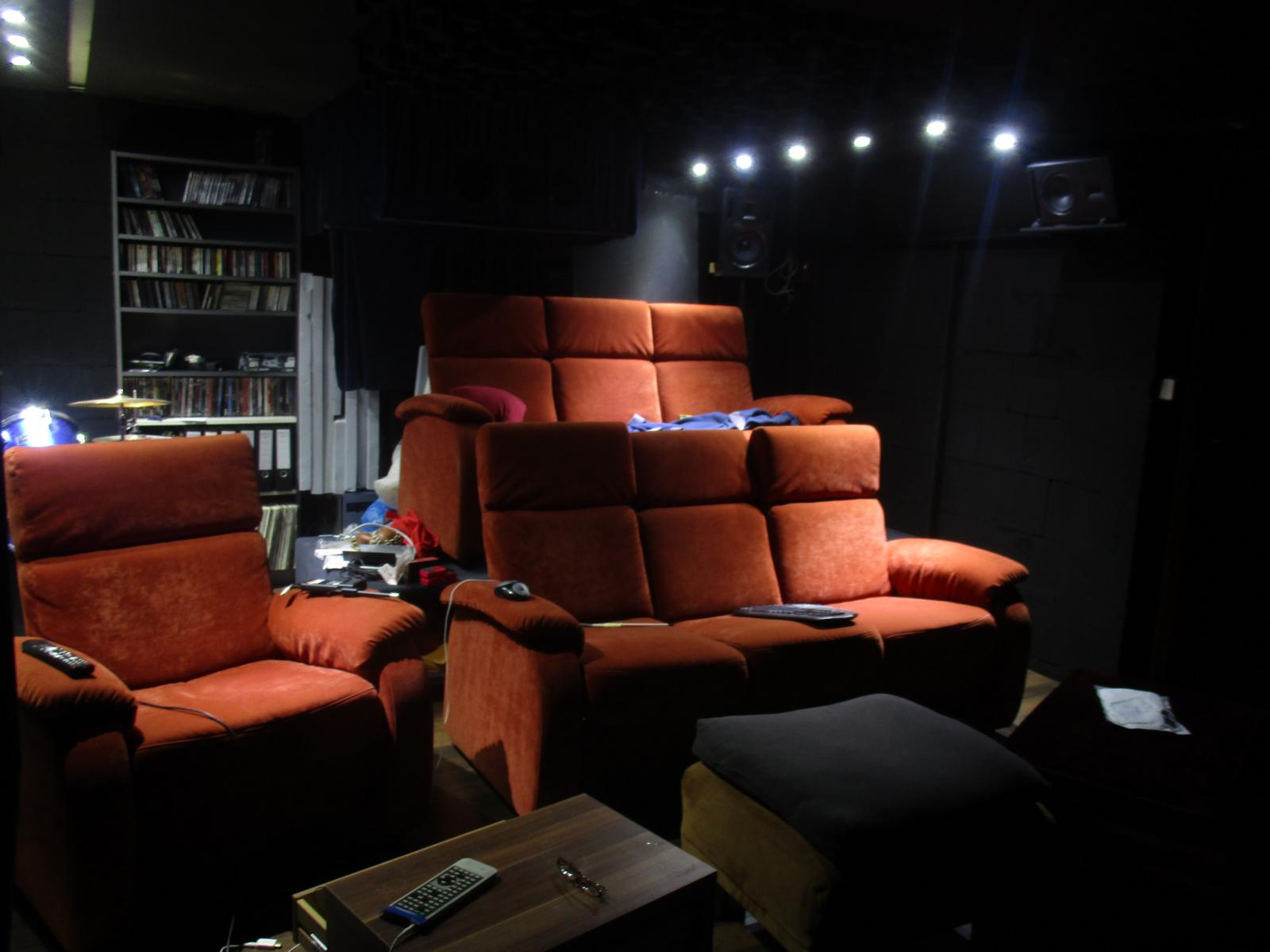

New and cleaner pics!

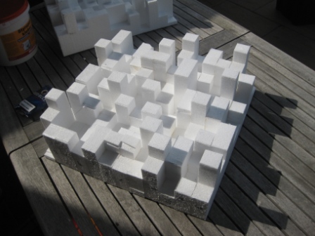

What panels are you using in the ceiling and on the walls?
Edit: re-read more closely. Any more information about those" DIY diffusors built from styrofoam board. There are 2D PRD panels on the ceiling and 1D QRDs on the side walls"?
Melifluonze wrote:
hansilili
Joined: 09 Mar 2007
Posts: 302
Location: Köln, Germany

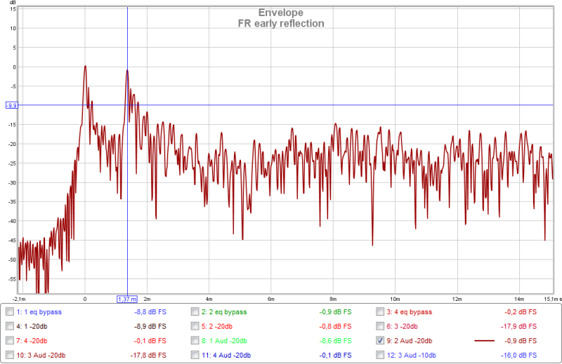

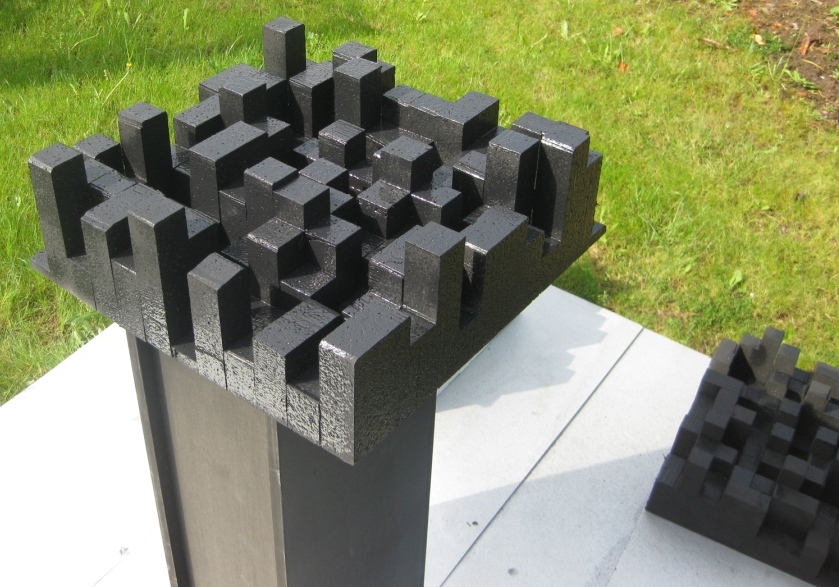

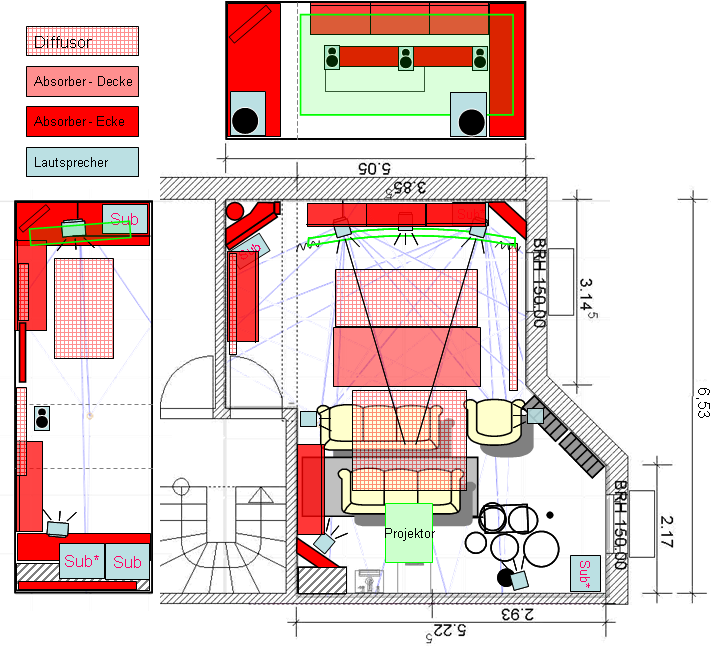

Posted: Fri Sep 11, 2015 10:30 am    Post subject:

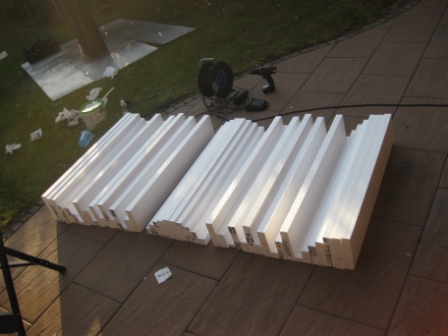

Re design of the panels check out google. I used this and QRDude.

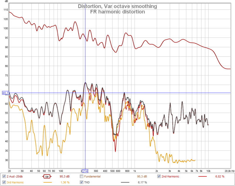

You can cut styrofoam with a hot wire, I bought a cuttor on ebay for 50 EUR or so. For the PRDs, instead of 4 types of blocks I cut 12 types of rows. A wooden pattern to guide the wire cutter helps.
Used REW to check fpr early reflektion. Attached is the front right speaker as an example (a 95 db sweep is loud!). The Reflection at 1.4 ms is present at all 3 front speakers and comes from the front wall. After this measurement was taken it was dampened with 10 cm of Basotect (open pore melamin foam) between the speakers and the wall. I will show the new measurement later.

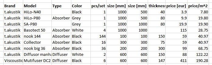

Posted: Fri Sep 11, 2015 11:18 am    Post subject:
Very interesting, yet looks time consuming to assemble the styrofoam pieces?
Suppose your goals where very similar but don't have enough headroom for a tall diffuser in the roof before hitting the path from the projector to the screen, what would you do for a bang-for-buck-solution or perhaps in this case less bang-for-buck?
Made a quick overview from Germany's favorite supplier Smile

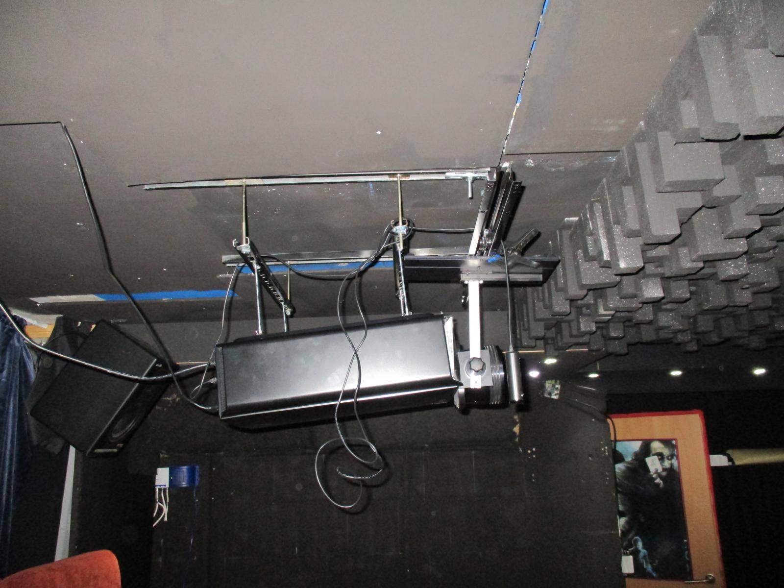

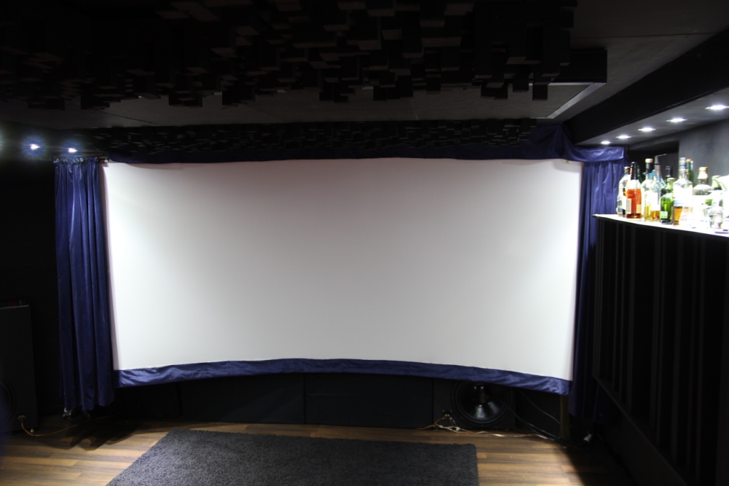

Posted: Thu Feb 02, 2017 12:07 pm    Post subject:

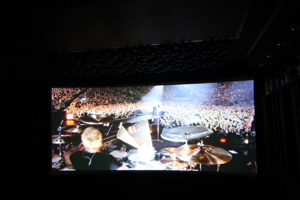

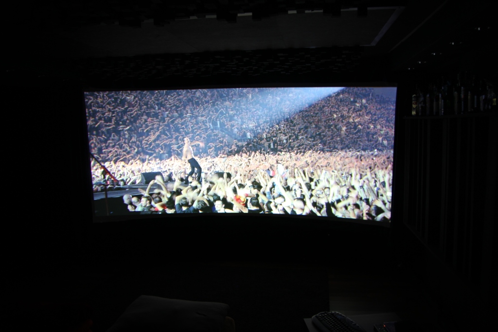

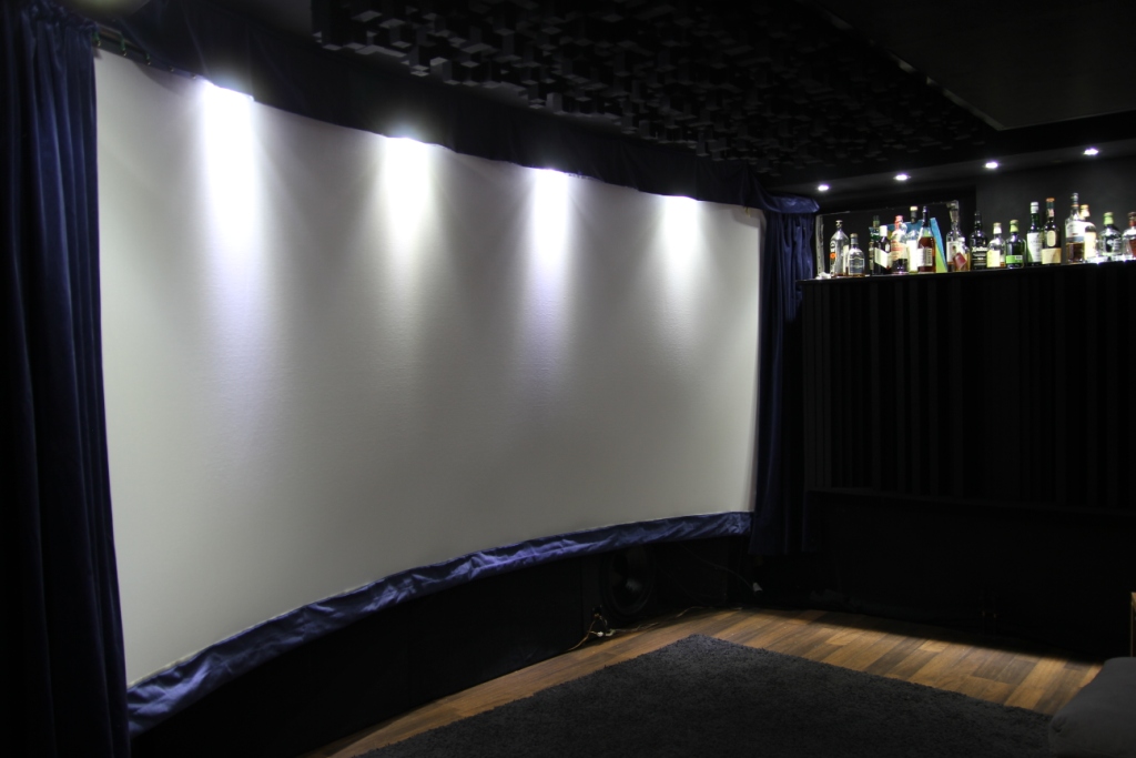

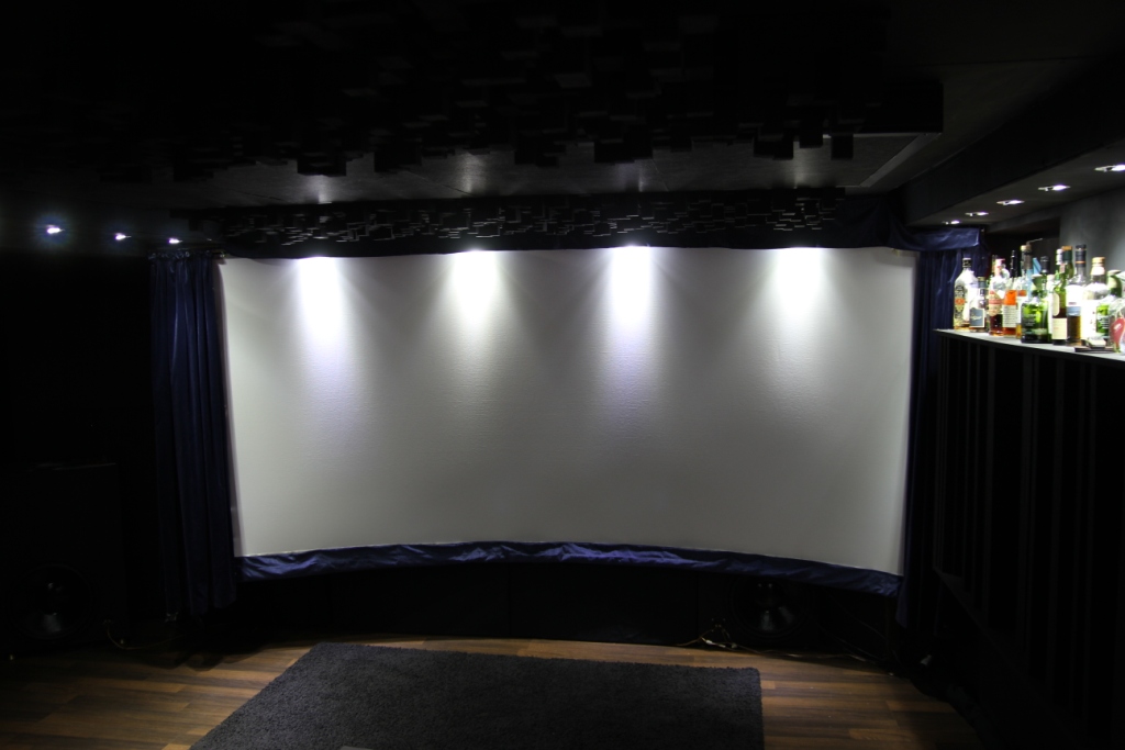

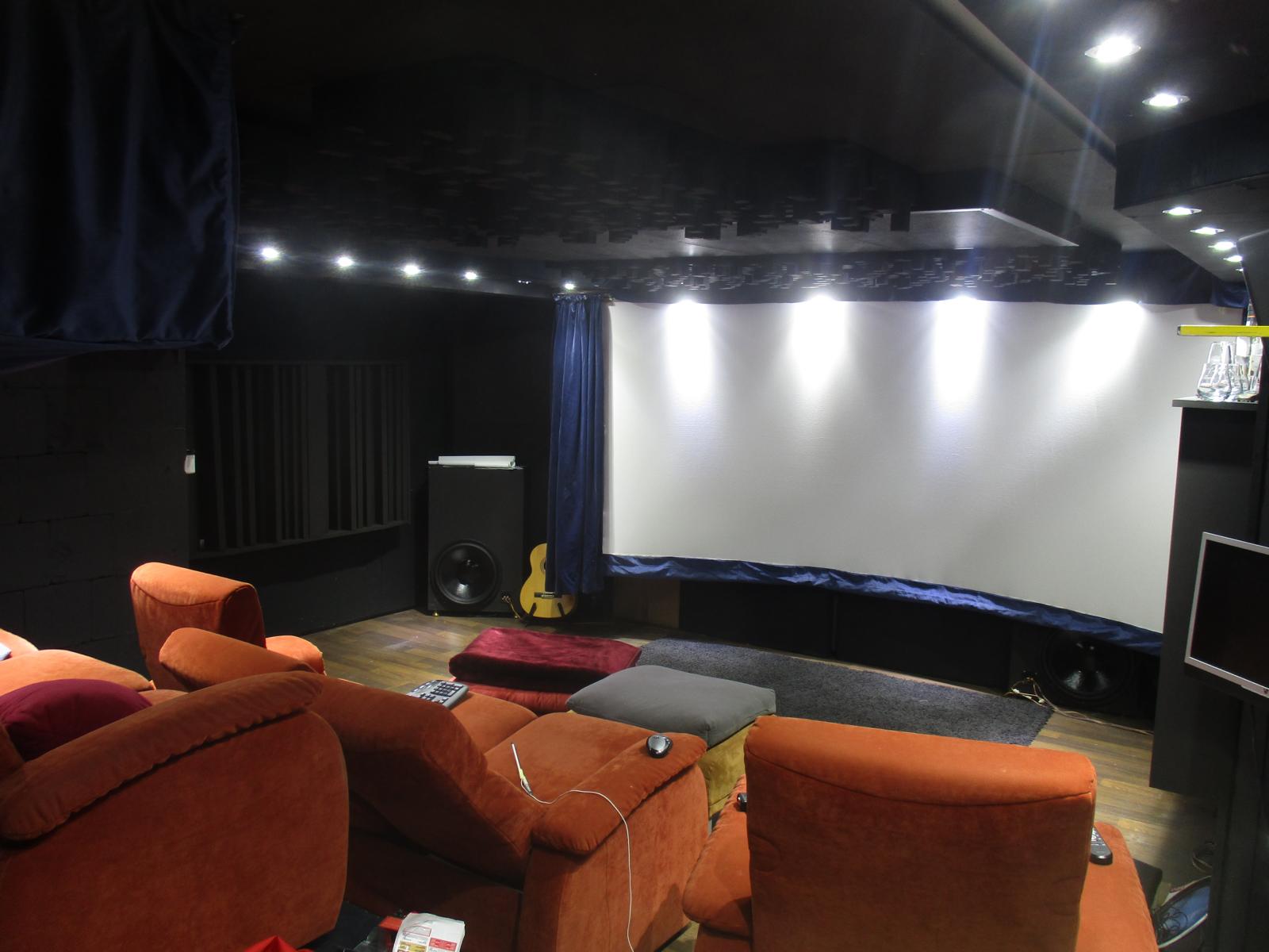

It broke my heart but the CRT had to go (ready for free pick up).
My basement finally went digital. It's a JVC DLA X30 with an Isco 2 anamorphic lens to light my curved screen. compared to the NEC it's a real compromise in picture geometry, colour convergenc and ther are still edge sharpness issues. Over all sharpness is better though. Main improvement: the image is brighter (even in full black picture conten Mr. Green )
speakers are all active studio monitors (5 Mackies, 4 Behringers) + 4 18 inch subwoofers. Yes, I upgrade to a 5.4 Atmos configuration. Was it worth it, not yet sure. at least the sound is not significantly worse than before.
