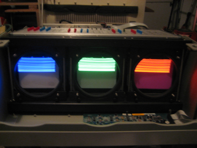

Hello all, I have 600 that I picked up a couple years ago and it has this problem: The image is on just the top half of the tube. It's set up table top, if I set it to ceiling the image moves to the bottom half of the tube. Verticle amp works but just on the half that the image is on it will not expand the image below the middle of the tube face. The horizontal shift pots dont work could this be related or another problem? Picture attached. Thanks for any input.

First guess it appears to be a vertical sweep problem. Are you sending it a signal in that pic or something else?

Thanks for the reply. That is the internal test pattern but it does the same with a video signal.

Well about all I can tell you is if you dont have any experience in electronics or you dont have another board to try then your only option is to send your board to Curt for testing along with any other board he feels maybe connected with this problem. Good luck.
Posted: Wed Mar 05, 2008 12:09 am    Post subject:
It may well be a V board issue. When you invert the image, the same portion of the V board is working, you just invert it on the tube. So the yokes are OK (never had one fail), but if the one 1/2 of the V board isn't amplifying, you'd most likely lose sync and only get 1/2 the image.
Frankly, why not find a good but burnt tube ECP chassis to put those 600 tubes into? The 600s are REALLY flaky now, but if the tubes are good, the ECP chassis would be a more reliable set.

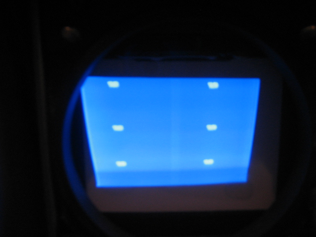

OK, I've made progress on this beast. The problem I was having was caused by a jumper wire on the bottom of the motherboard making contact with an adjacent pin so my smps no longer blows fuses and the image is filling the crt face. Now the problem is jumpy video on the internal test pattern, and with 480p rgb negative sync I get multiple images. The attached picture shows 6 white spots each one of these says DVD and there is only supposed to be 1. Thanks for the help.

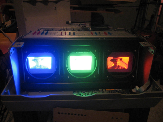

It's alive! Finally got an image displayed. Now the only problem left is I have no horizontal control. I have tried 3 horizontal shift boards and they all work the same I can control the geometry but not the position or the size pots. Is there any other board that would prevent the shift from working? You can see both red and blue are shifted in the same direction and about the same amount. Thanks.

Posted: Fri Mar 07, 2008 2:06 am    Post subject:
Are you saying when you turn the pots for red, green or blue Horz shift or Horz width on the N-S Corrections + Horizontal Shift board nothing happens?
Posted: Fri Mar 07, 2008 2:15 am    Post subject:
If that is what you're saying, I'd say the DC voltages going to the H shift chips on the H shift board isn't there. It's a DC offset that shifts the image from what I can remember.

The trimpots on the top edge of the horizontal board that control keystone and pincushion work. The three trimpots toward the rear on the top edge that control horizontal raster position and the yellow coils under those trimpots that I believe are the size coils do not work. Thanks

Posted: Fri Mar 07, 2008 3:15 am    Post subject:
You need to check fuses F5 and F6 in the SMPS.

Posted: Fri Mar 07, 2008 3:37 am    Post subject:
Yep, f5 and 6 are blown. Thanks. I used 3 amp should be 4 amp.

Posted: Fri Mar 07, 2008 10:22 pm    Post subject:

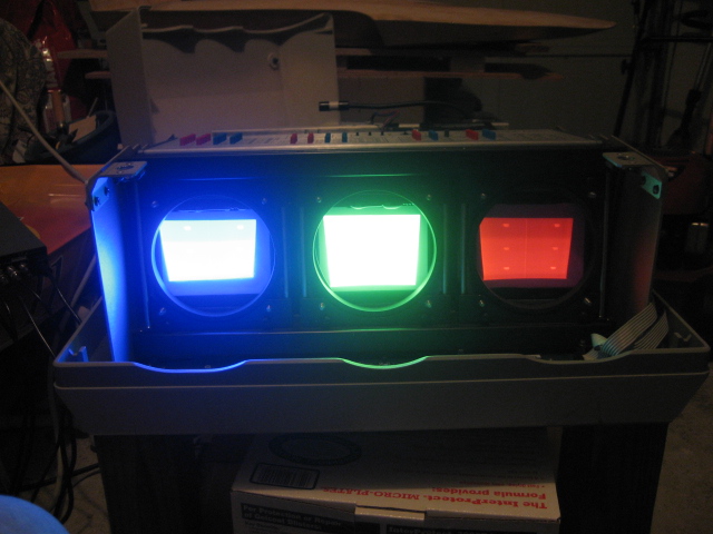

Ok, the proper fuses corrected the horizontal shift problem. Now what's left is the verticle size of the red and blue they are both shorter than the green. Is there a verticle height adjust for each tube? Thanks for all the help. You can see in the attachment how the red and blue image is shorter than the green

Posted: Sat Mar 08, 2008 3:57 pm    Post subject:
Does anyone know how to adjust the verticle height of the individual tubes? I either need to make the green shorter or the red and blue taller. Right now the green is so much taller that I cannot converge the image. Thanks
