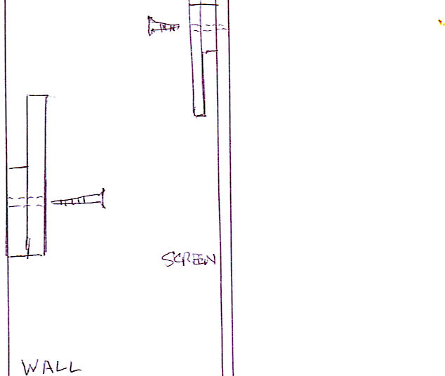

Very Happy Very Happy Very Happy Here's an easy way to mount your new screen.
Cut strips of MDF about 2" wide and 4" wide and fix to the wall and screen making sure that its level with a spirit level.
then the screen just drops over the wall fitting.

Mike, that's similar to the "french cleat" method used in the woodworking and picture framing disciplines. We've discussed it in a couple of the other Wilsonart threads. FYI.

yes i used the stick method.
Now i want to build a 4way motorized masking for it too Smile Already shopping for that.
Opps, there were more posts to anwer.. Wink
I have thought of another approach to "hang" it. I have a small window behind that i want to get able to reach.
So i will try hinges on one side and a leg with wheels on the other side, so i can swing it out a bit. Perhaps it wont
work, but that i'll see.
