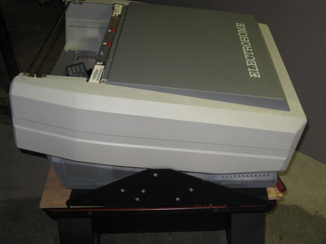

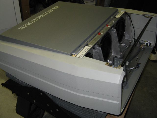

Some real pics...
It's got an -02 VIM and orbiting RGB2 card.
You can see from the side view that the pivot bracket in the RP chassis was pretty well thought out. It was stiff as all heck, with a shoulder screw pivot point and socket-head-cap-screws fore and aft to fix the angle.
The pivot also has a nice feature... a tall stop on the bottom half that allows one person to safely pivot the PJ to level for service work.
Tube closeups with heavy gamma to follow.

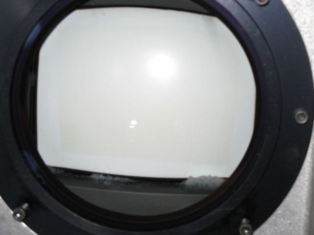

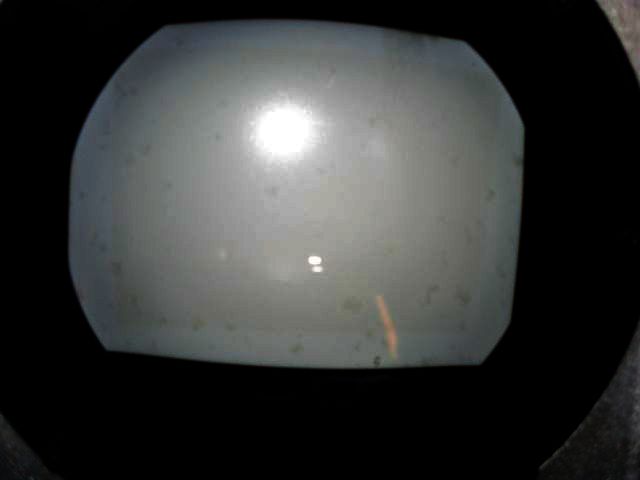

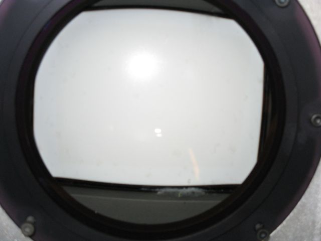

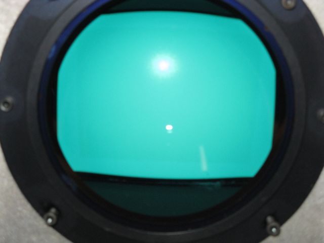

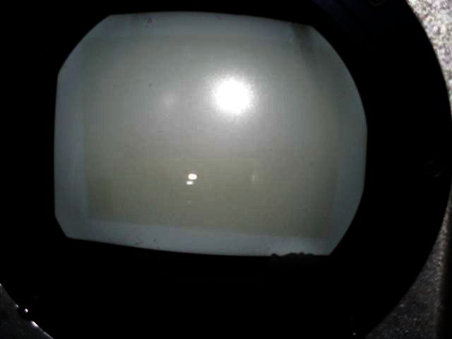

The tube closeups followed by their gamma'd equiv. Gamma is WAY low... 0.20 on Irfranview, to bring out this wear.
The small vertical rectangle lower left on the Blue worries me a little, but by eye the wear is virtually invisible.
A little fungus to deal with too...

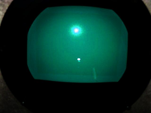

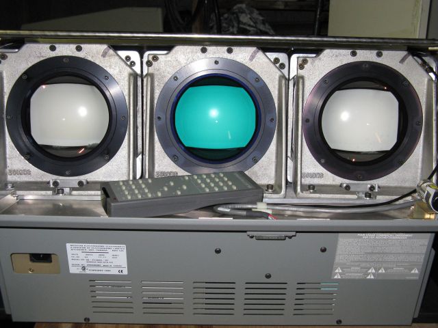

The PJ did power up, at least the green tube: Menus were prominently displayed in the GL pictures for both this projector and the one Bruce 09 won.
Setting scan for "table, front" followed by runtime and P14 are first on my checklist... The chassis is c.1998 so I need to check whether its' pre- or post- 31 August.

Don't worry about only the green showing anything, unless you hit the # button for the internal test patterns, there was no cause for the other tubes to light.
I'd bet hours are under 2000, going by the amount of visible wear. 1998 is a great vintage, you should have a clear winner with that pj.. ... ....

So far so good... About 21k hours, 6000ish CRTs ON. Output with test patterns is strong from all three tubes, tho the proof will be in the greyscale.
I noticed that there is a full-white screen... I'm going to bring my test screen in from the garage and see how that slightly darker area lower left looks.

Those tubes are fantastic for 6000 hours use. Either they must have had a black screen saver, or it must have been really conservatively setup, or the tubes in it were changed...
Posted: Fri Mar 07, 2008 1:49 am    Post subject:
What do 6k hour tubes usually look like, the tubes in my Marquee 8000 looked that good or better at 5k hours
Also remember this was run in a RP setup on a small screen so it would need less brite and contrast that our setups on 8' screens
Posted: Fri Mar 07, 2008 2:13 am    Post subject:
Just because the counter says 6K tube hours doesn't mean they were projecting light for all that time. Then again, in an RP setup, the contrast and brightness can be really low. I've got my RP BG808s with 41,600 hours on it, and brightness and contrast are well under 50, driven by a Faroudja NR at factory defaults. I'm sure the tubes have been changed at least once, but there's no wear on them, and other than a bit of convergence drift, the chassis is solid.
